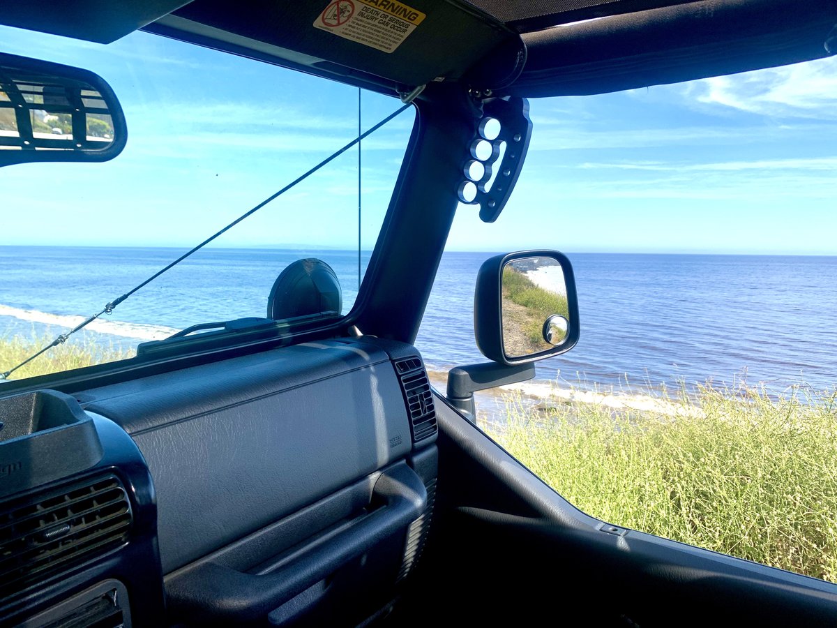

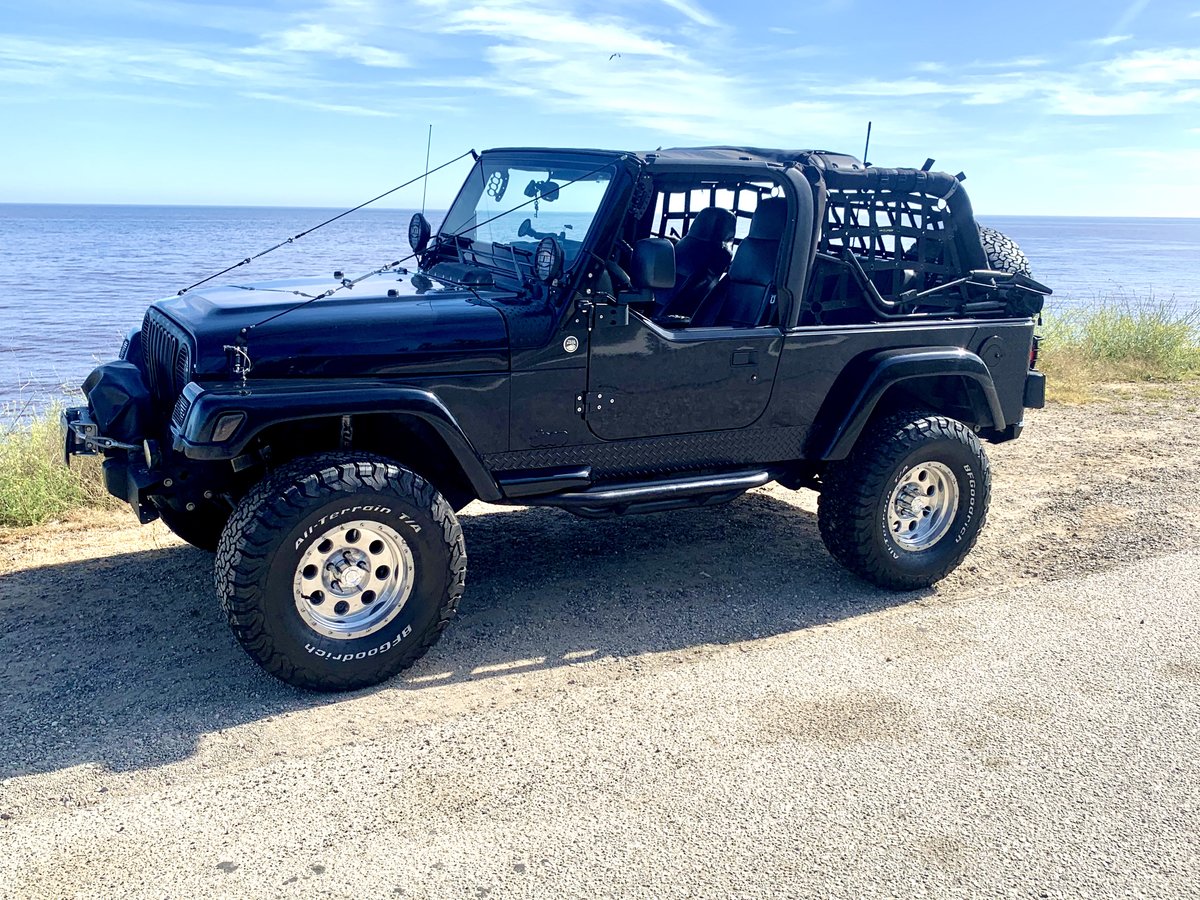

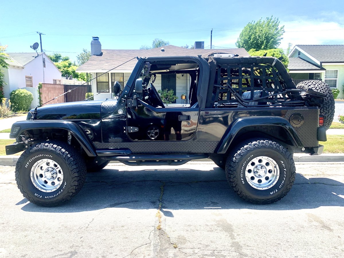

What are those wires going from the fenders to the top of the windshield for?
Limb risers. Not much use here in California but if you take a trail in the woods where the tree limbs/branches hang low and hit the windshield, they ensure the branches rise to the top and avoid the glass. In your area these might be of more use lol

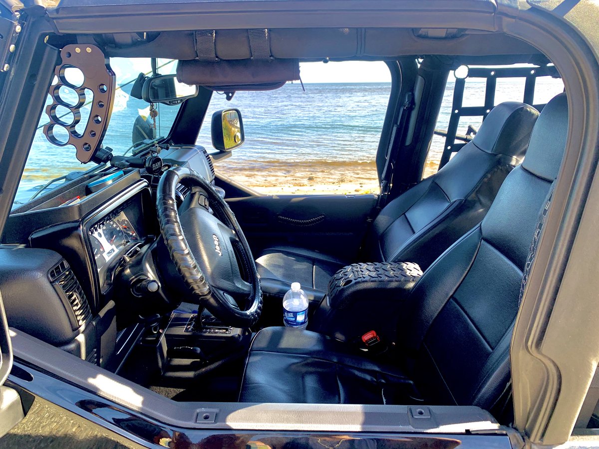

Another warm, sunny day in Los Angeles. Perfect temp for my new half doors. Took a long drive down PCH and all over the city.
I was just telling my hubby about those guide wires that make the branches go over instead of hitting the windshield directly. I am thinking I may do that down the road. Do you have close up pics on how they hook to the Jeep? Also, Where did you find the tray that is above your instrument cluster? I would love to have something there!! :D
Nice Jeep by the way.

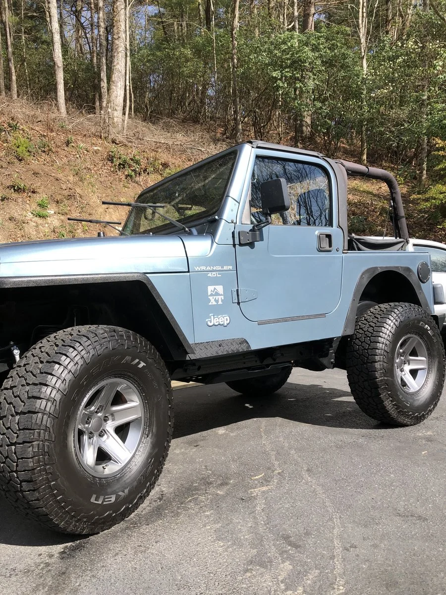

I've been looking at the gunmetal ones.
These are gunmetal. Weird sun angle.
It was between these and similar ones at Extreme Terrain, ET was out of stock for at least six weeks, I got the last 4 QT had in stock (15"), they said it would be about six weeks till they got more. I think I've had these for about 6 weeks.
You can't beat them for the money.
