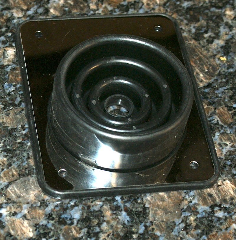

My solution to the outrageously overpriced lower shift boot for '05/'06 6 speed transmissions. It hopefully will work over a long period, but it cost $10.99 from Amazon:
https://www.amazon.com/gp/product/B00062ZI1S/?tag=wranglerorg-20

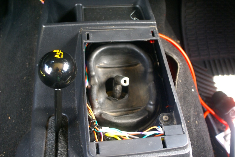

Typical torn lower/inner shift boot, not paying $125 or more to fix this chickenshit problem.

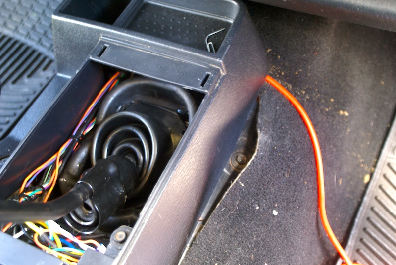

Trial fitment.
Trimmed to size, and roughened up a bit.
Glued down with this stuff.

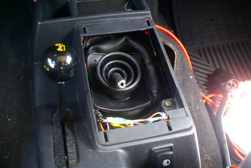

Done!
Shown in reverse.
I don't think the 3m Weatherstrip adhesive is going to let go and even if it does, I don't think this thing is going to go anywhere between the "well" in the old one and the goofy weight/splice junction in the gearshift lever - kinda sandwiches inbetween. In any event, it was $10.99!
