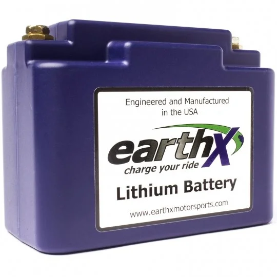

This is the only way to go for a starting battery, 3.9 pounds weight...but most people on here would not pay the exorbitant price if $350 for a battery. Its small enough to put in 3 on a standard battery box. Tim
https://www.batterymart.com/p-ltx36...5ymiSK-uNyqyt0v7FkVX-QaELTgPEyuxoCeCAQAvD_BwE
