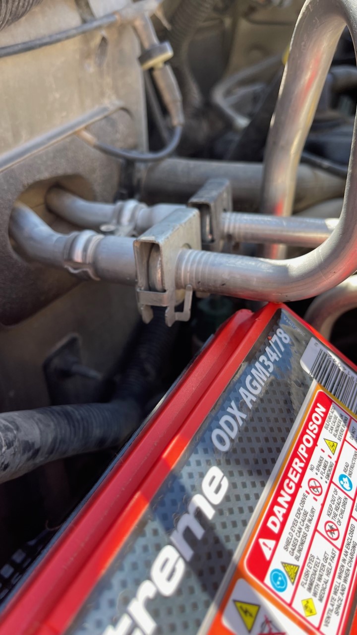

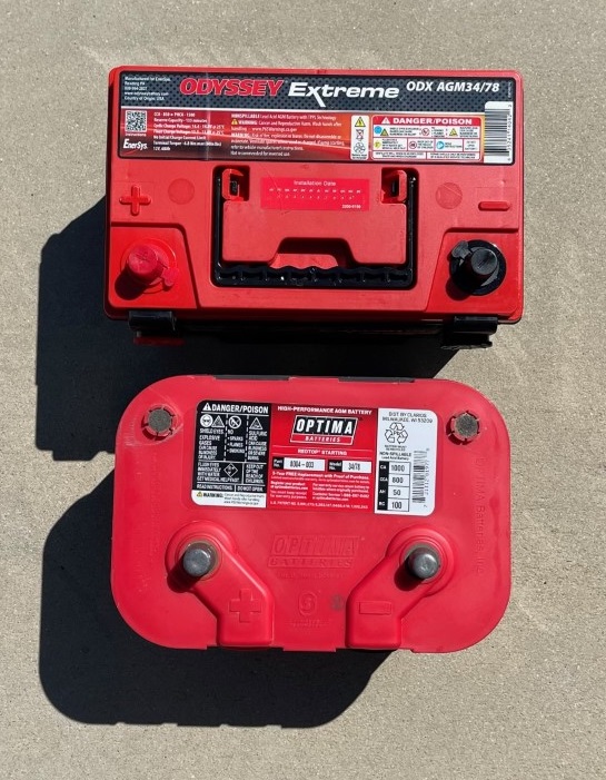

Well that was a fun read. I was out of town for a week (burning up the clutch in the rental car :ROFLMAO:).
I got the replacement battery ordered. Its almost the same size. It fits into the tray, but I'll need to come up with a new way to strap it down.
The battery does touch the AC lines. Assuming I can get it strapped securly in place, I don't think it will be a problem.
Pic1 - The replacement is +.9" wide. The other 2 are nearly identical.
Pic2 - Tight fit past the AC lines (even with the fuse panel completely out of the way).

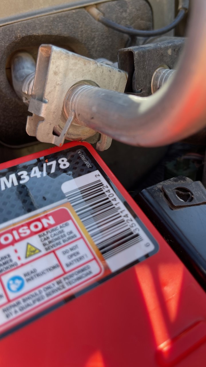

Pic3 - Fully seated in the tray, it just touches the AC line.

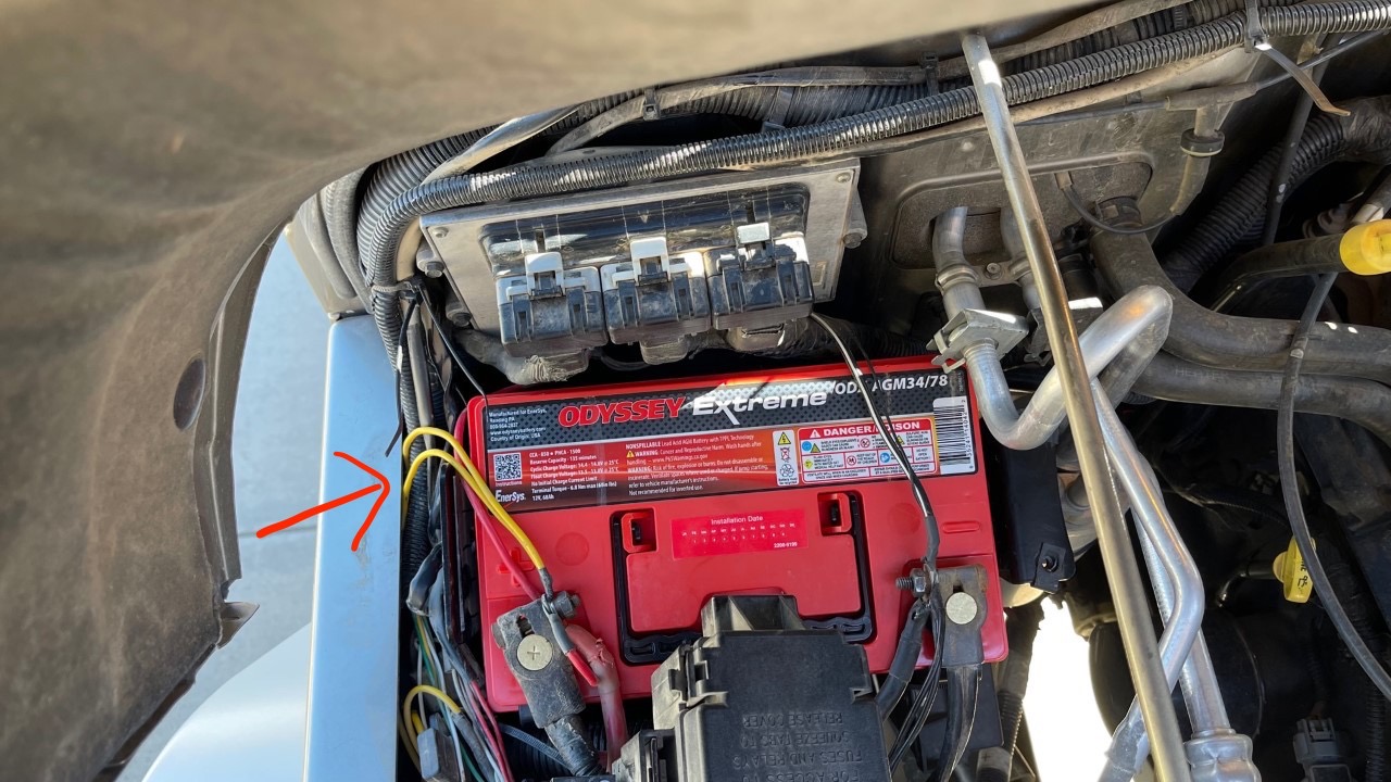

Pic4 - Fully installed

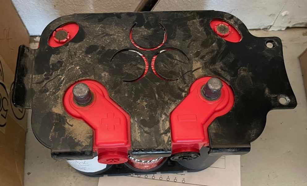

Pic5 - This is the custom Nemesis lid for the Optima. I don't think I can get it to fit, even if I hacked it up

A previous must have modified or replaced the battery mount for that Odyssey 34/78 not to fit. 34/78 batteries normally fit into a TJ perfectly, that's all I run.
Reactions: L J
PO used just about every accessory Nemesis makes. This Jeep was supposted to be a display at Easter Jeep Safari in 2020.
The tray and lid fit the Optima perfectly.
I asked them if they have a different lid, but they don't. They admit that the Optima Batteries are junk now. But TJ is probably too old to design a new battery tray.

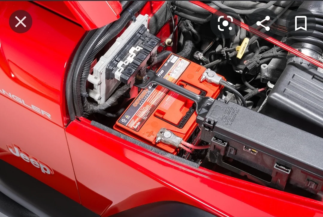

happened to notice a potential fire hazard.
them yellow wires have the potential to chafe the insulation off and arc directly to ground on the side of the fender.
not sure if it was a factory thing across all the model years but mine and others like the photo below have a piece of rubber trim along that edge just slipped on. red jeep isnt mine.. im just too lazy to go get a photo of mine.
Reactions: srimes
Thanks, those are the KC Lights. I didn't get everything exactly right when I reconnected. Originally I had the negative wires running across the top of the battery, probably a bad idea.
I might get one of those battery terminals with the extra connection points for accessories.
You guys keep showing off that trim... anyone have a source or part number? I need one before my next electrical fire.
From the posters picture...I'd try tucking those wires into the fender better and get more space for the battery.
Should be able to rig up a tie down...I have 3/4 angle iron holding my battery down. My dump trailer batteries are ratchet strapped to the bottom of the box...just cut off the excess strap and heated it up to melt it.

In no way am I suggesting there WILL be a electrical fire without the presence of that rubber strip... just pointing out simply the fact that wires making contact with a sharp edge and vibration could lead to a very possible oh shit situation.
obviously wire managing would be the correct method of attack to prevent said emergency.
