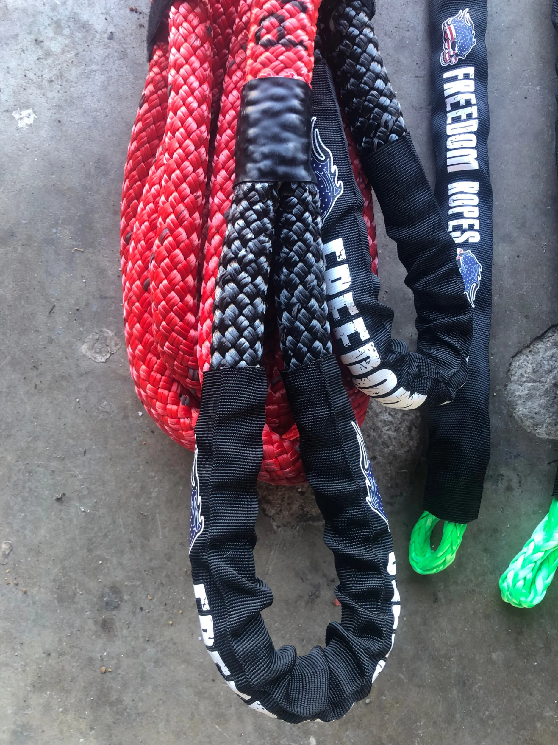

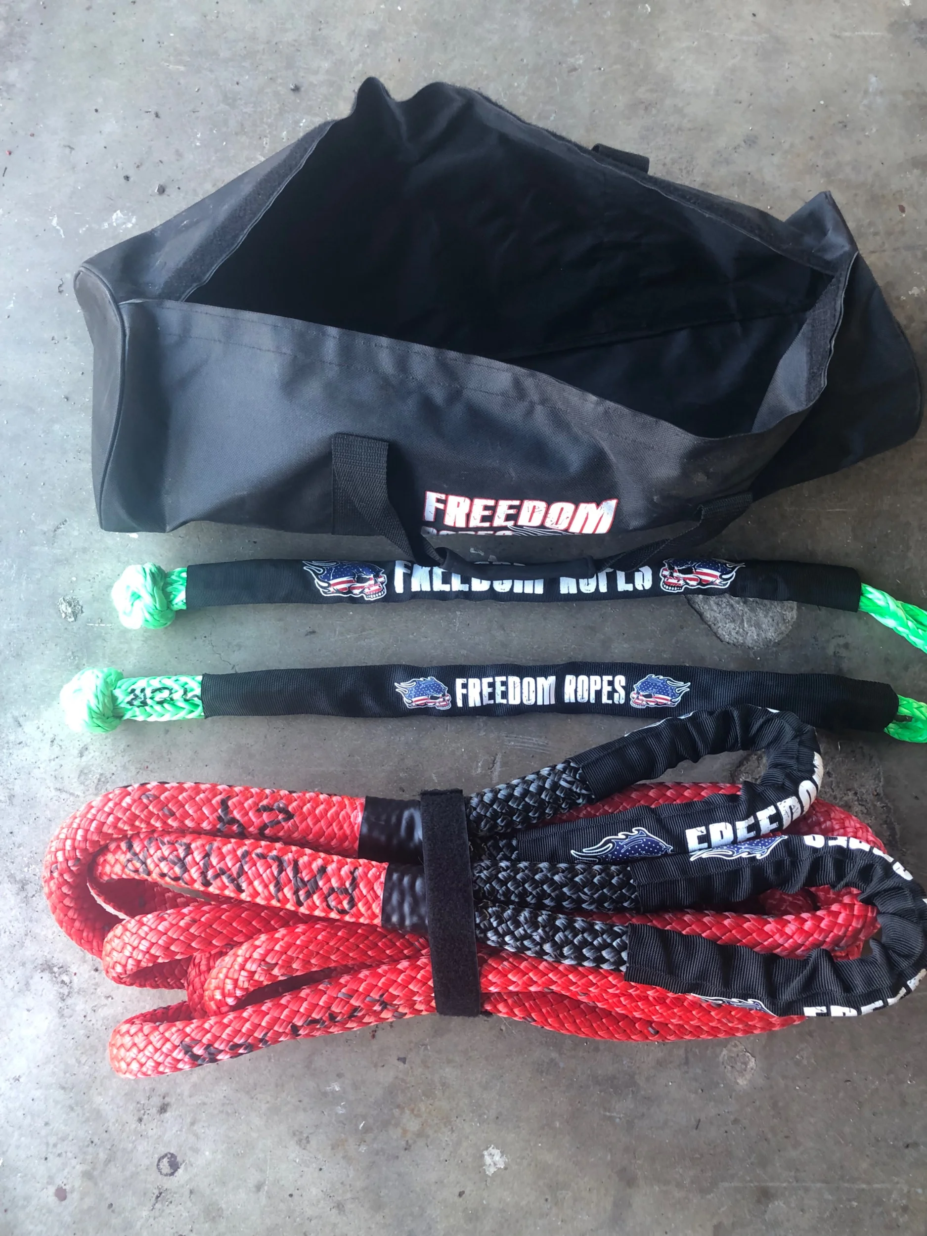

I went with a Freedom Rope 1”x30’ rope. The kit came with the rope, 2 soft shackles and a heavy duty bag with velcro closure. I went 1” because I have to pull out stuck off-road forklifts and trucks from pickups to semis. I bought mine at the local off-road expo and was able to compare several brands of ropes. Looking at so many ropes at one time it appears that many used the same base ropes. The main difference between them was how the eyes were constructed, what type of abrasion protection they used and if they had a reflective element added. I went with the slip cover vs the dipped abrasion protection. All claimed to have UV protection. When questioned directly all the venders admitted the base rope was Chinese and they were Assembled in the USA. Yankum the other high end ropes were not in display at the show and I’ve not physically seen one. I can’t remember what I paid for the kit but it was $150 or less with the show discount.
From my experience a longer rope will allow the pulling vehicle to be on a more solid footing and be able to get a better run up. I’ve had to use up to 80’ of strap to get the pulling vehicle on solid ground. 80% of my recoveries have been at night usually 3am and because the operator failed to walk the area to determine ground conditions properly.

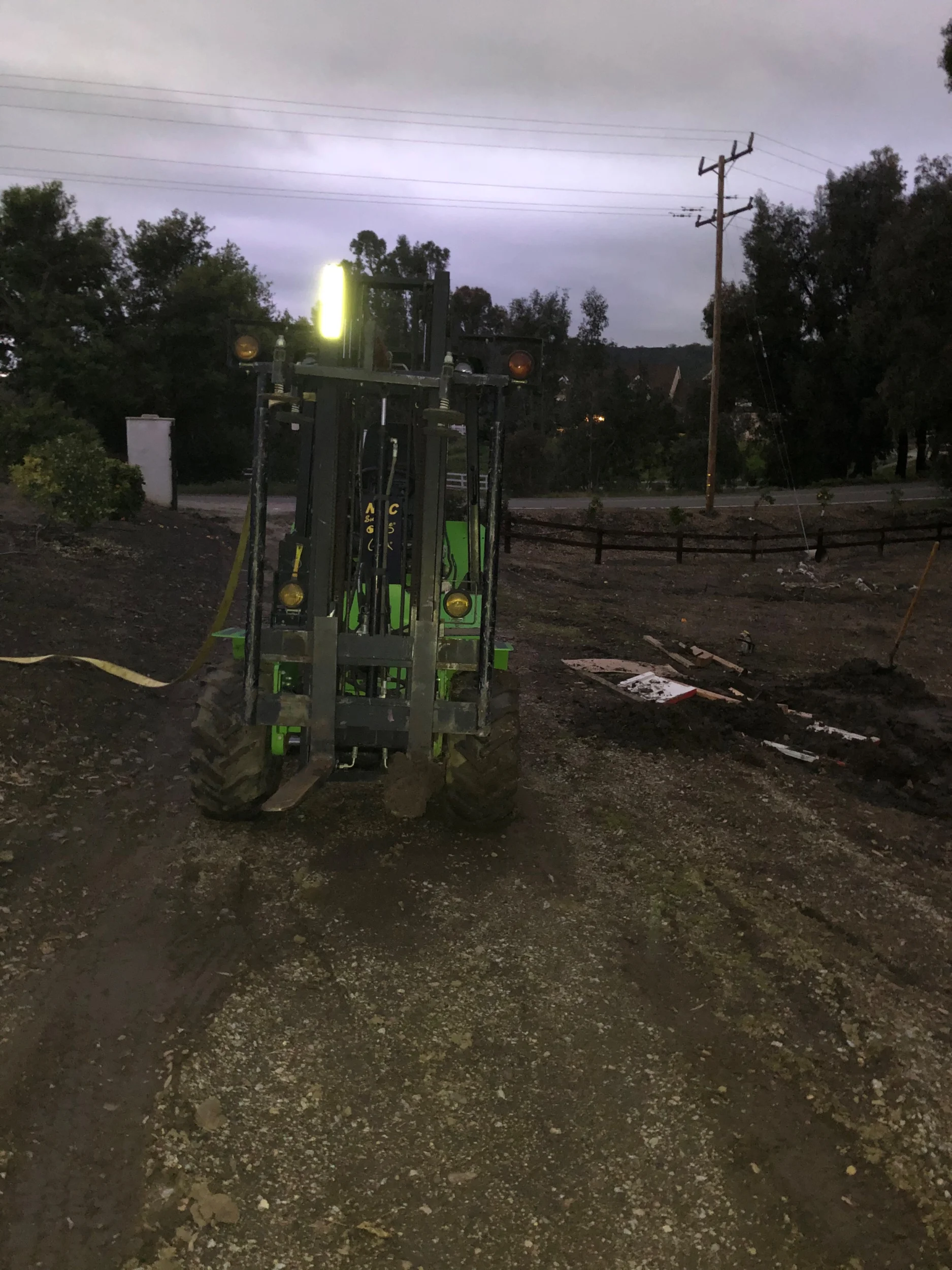

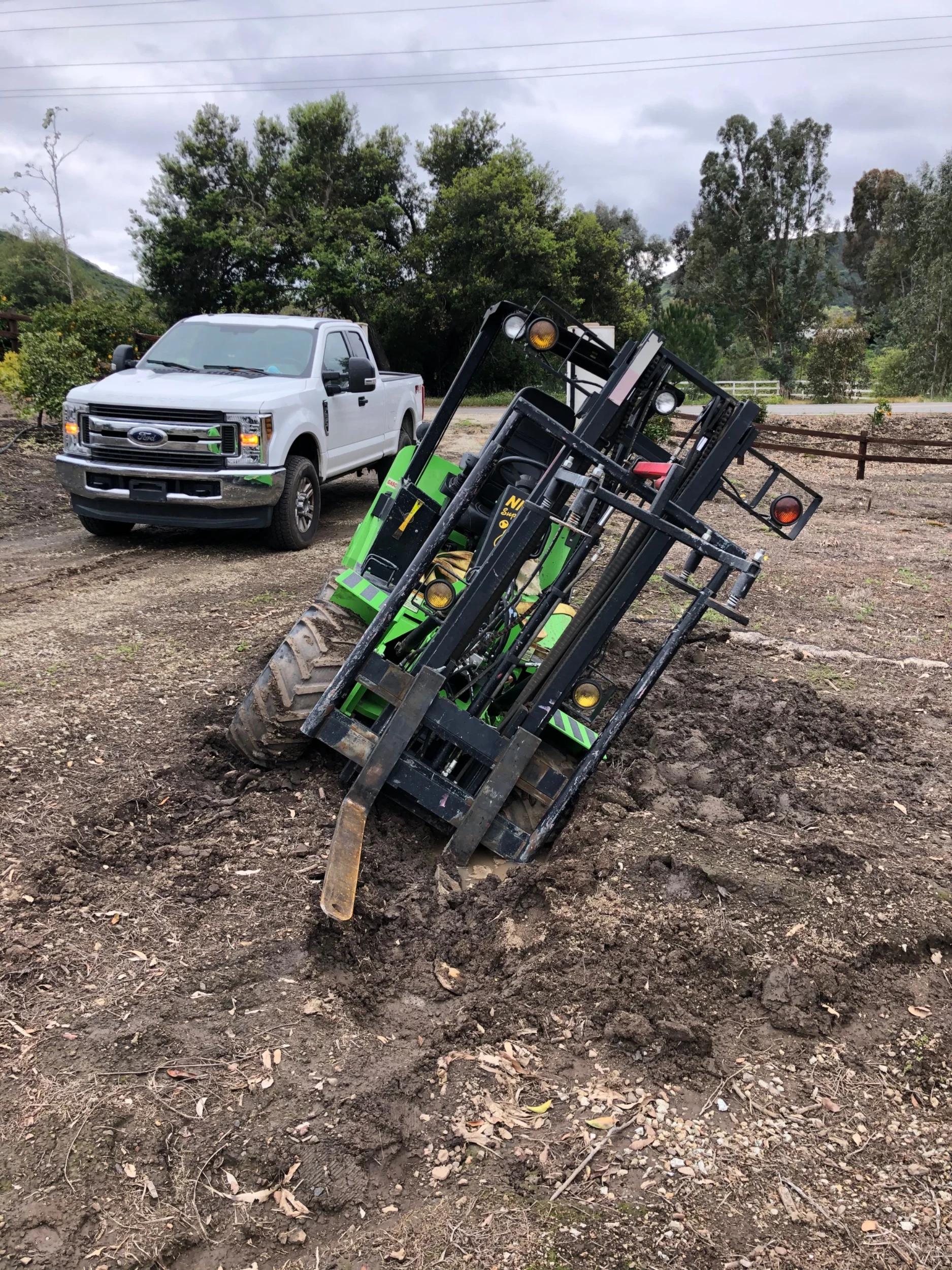

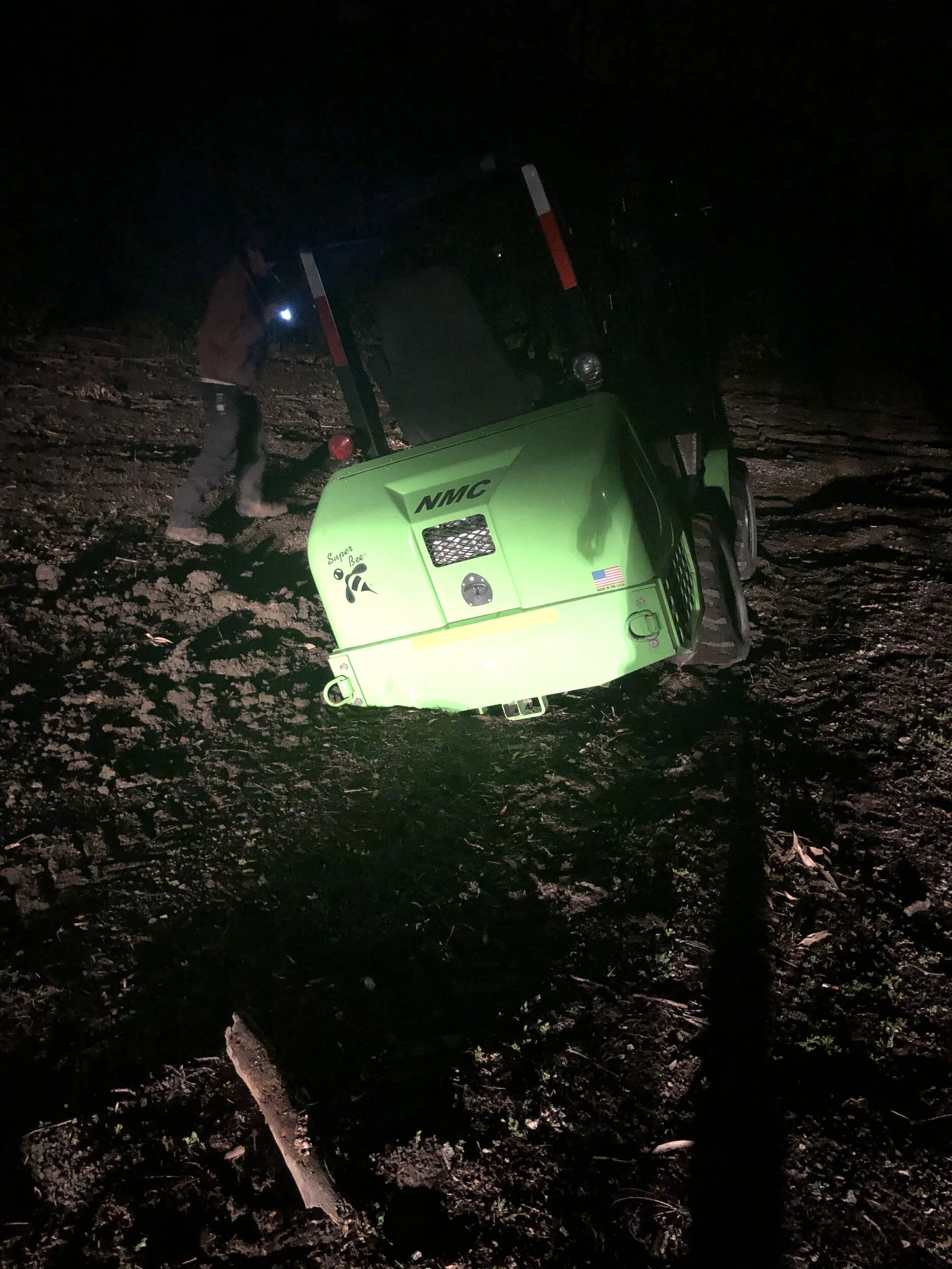

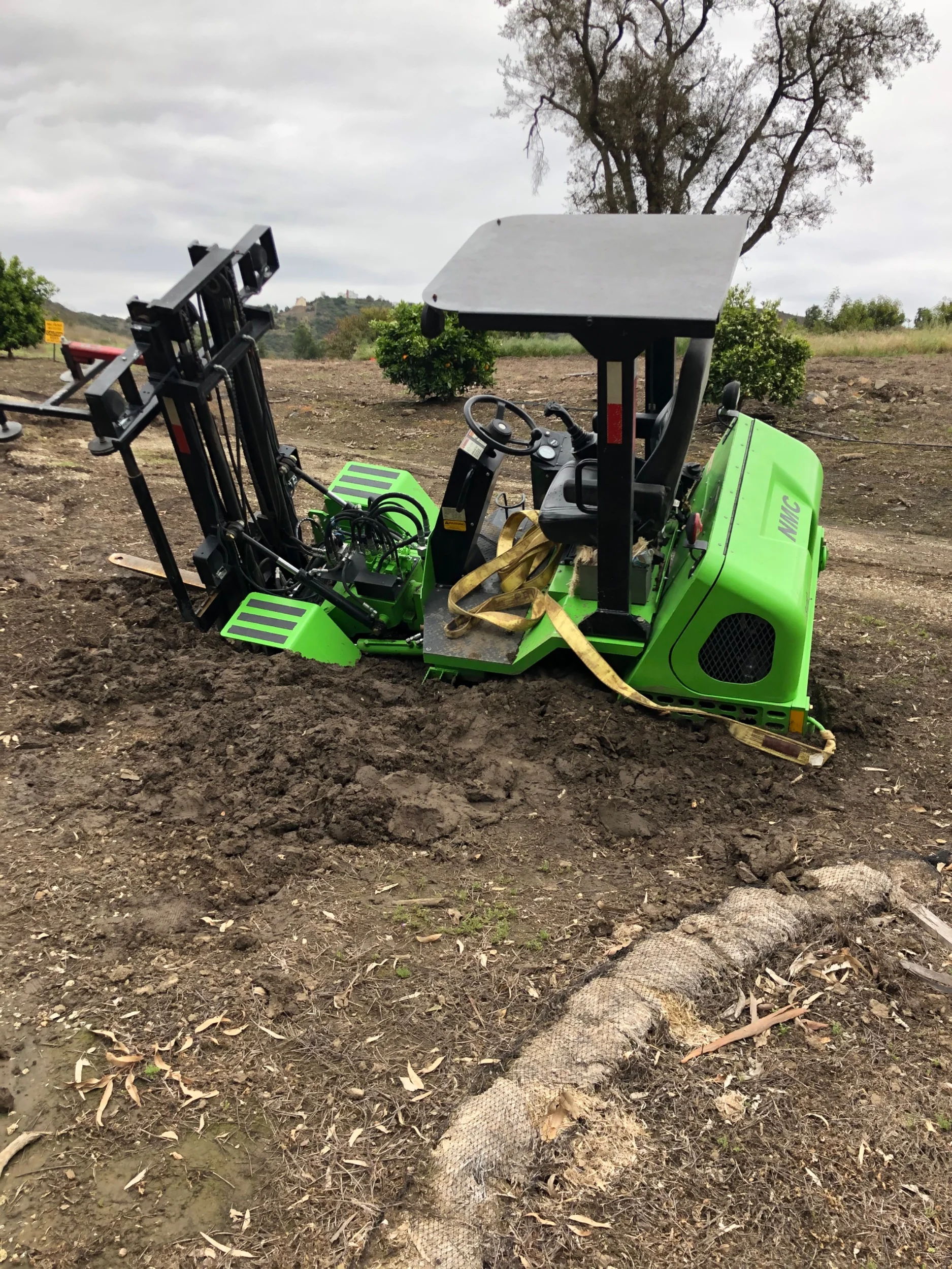

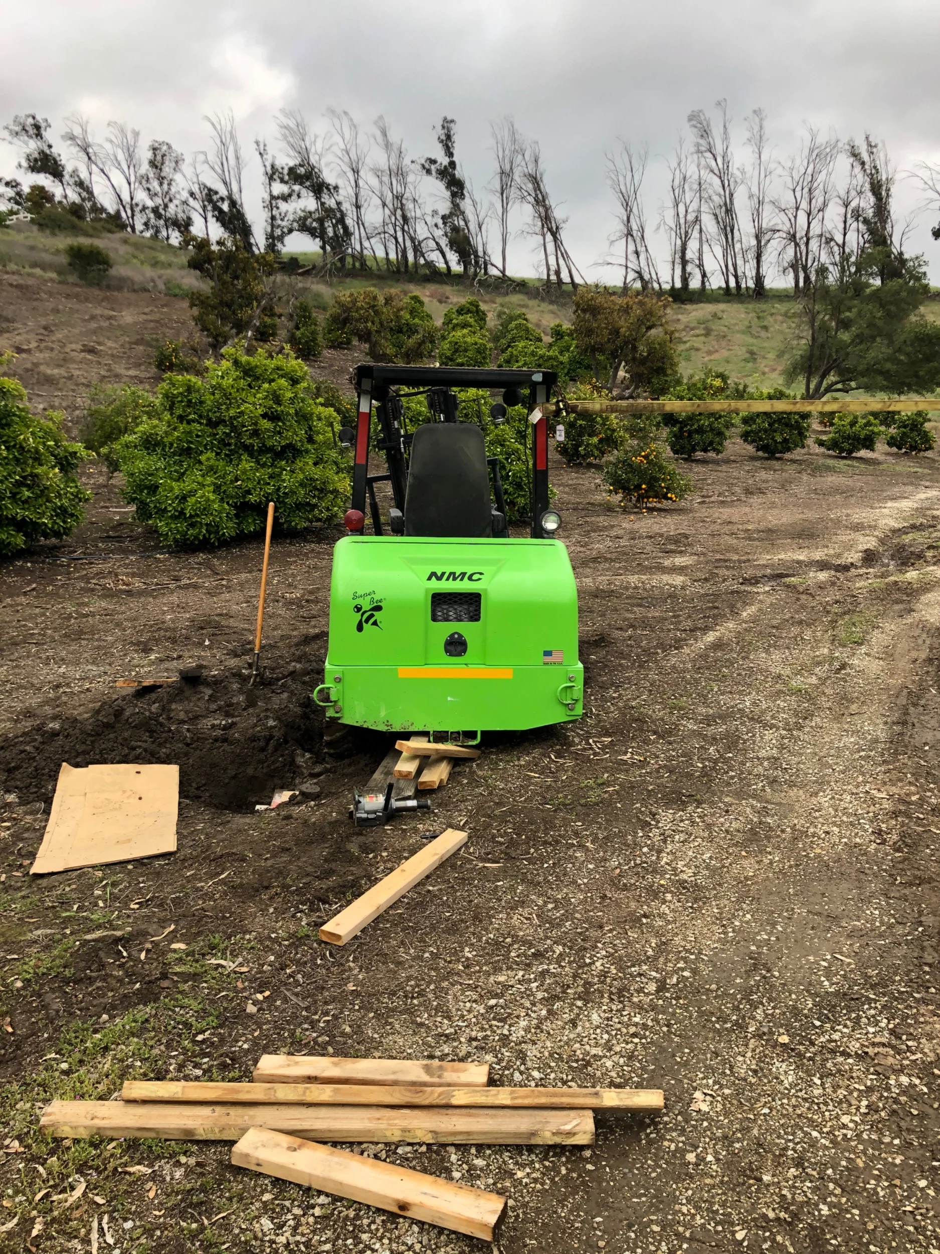

A kinetic rope is not a one all be all. Straps and chain have their place. Straps give better control when needed. When a Kinetic rope releases it’s stored energy it can’t be controlled. Chain is used when abrasion is an issue. Case in point. I got this call for a stuck forklift at 3am and since the operator was done unloading and placing our bees I told him to leave it and I would come out the next afternoon to extract it. Picture sent with and received by smartphone for the haters.😜
In the images below the left side of the forklift fell into a sink hole. There was a ground rise on the right and I had to place my tow rig on the level ground on top. I attached a chain on the left side of the ROP for a lateral pull so I could raise the left side to place cribbing. I attached 80’ of 3” strap to the pintle hitch of my F250. With it in 4lo, lockers on and tires down to 15psi I slowly righted it avoiding pull too far and laying it down on the opposite side once I broke suction. Once it was righted I had to lift the rear with a bottle jack because the rear weight was still buried in solid dirt. I placed cribbing down under the tires and drove it out. I could not just pull it out backward even with solid ground just inches behind the rear tire due it being hydrostatic drive and I was by myself. Full recovery took about 2.5 hr from arrival to leaving with it on the trailer.
Because each situation is different and I need to do things like this several times a year I have all the necessary supplies at the ready. Better to bring too much than too little because we tend to get stuck in the middle of nowhere. I know we are limited in space and weight with TJ but I pack 2 straps, soft and hard shackles and some cribbing when I go out. One of the straps will be replaced by the new Kinetic rope.
