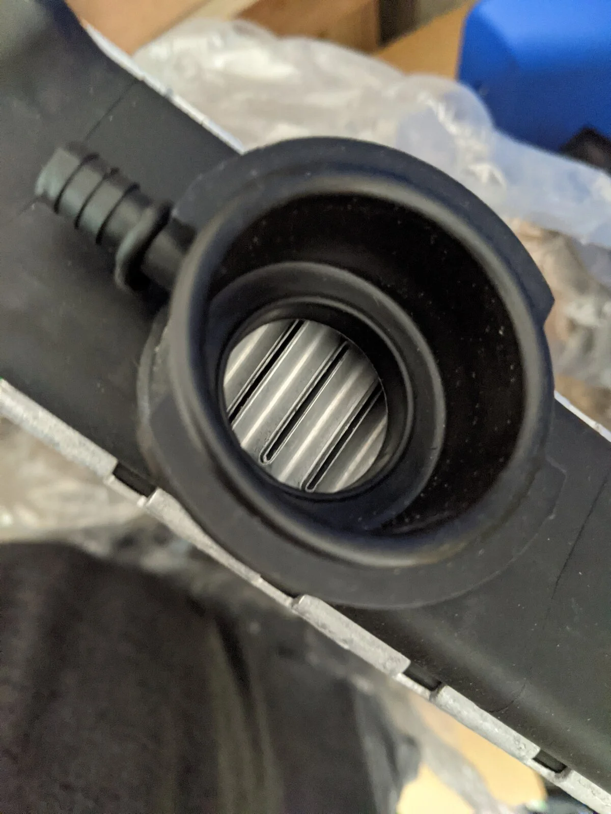

Mopar as far as I can tell. Looks just like the mopar ones I’ve been looking at ordering.

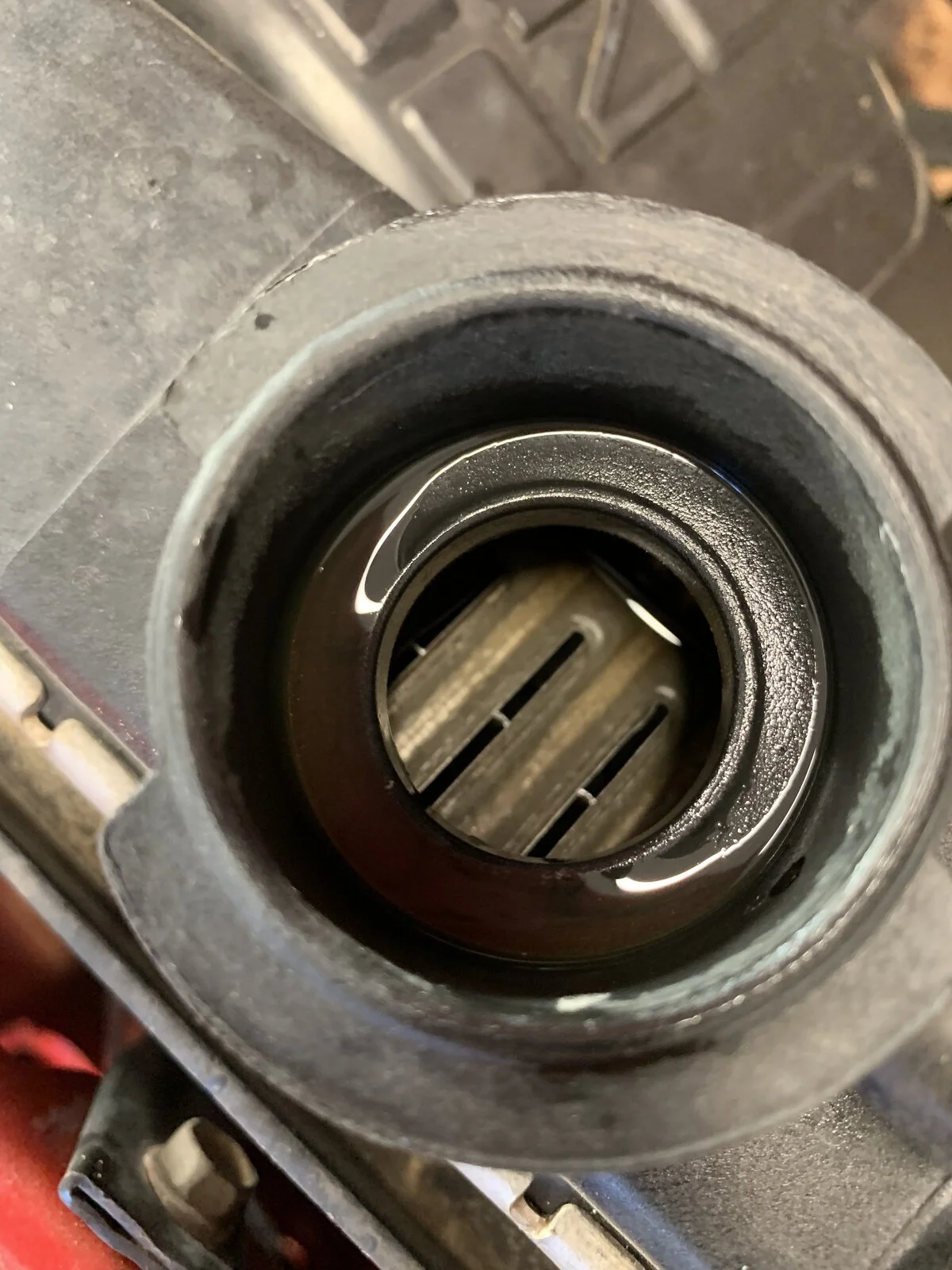

This a pic inside the radiator. When I drained and flushed the whole system, including the engine block, a few rust pieces came out but overall not much came out out and coolant was clean.
If it’s not the radiator, I’m not sure what could be causing the hwy temps to increase into the mid 220s (per OBD reader) but no issues driving around town or off-roading
Not a Mopar.
Mopar is a single core, lacking that little divider/bridge across the tube seen in your photo.
The way to know for certain is the Mopar logo molded into the lower tank above the drain valve.
