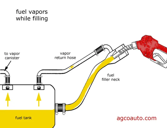

Are you venting to the filler with a large enough ID hose?
-6 AN, so 0.34″ ID. The issue is happening when I try to "top off" the tank and fit an extra gallon or two in and the fuel level momentarily raises to the level of the return hose. I'm thinking I either need to add an expansion chamber (section of larger ID hose) inline or connect 2 vent lines to the tank and put them in an inverted Y.
In a tank build for a local chevy, I created a momentary overfill space using 1.5" ID rubber hose for the entire vent line to control the flow. It is a feasible solution.

Just so you know, the real fix most are referring to is to drop the tank, and sand the edges of the plastic valve that the hose attaches to on the bottom. Ethanol in the gas causes the plastic to swell over time and the valve to not work properly - the regular Tj hose has zero issues.
