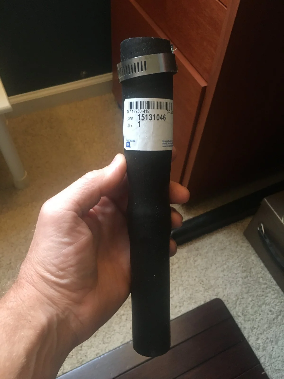

I found GM part 15131046 online with a Chevy dealer. It appears to be the same one shown in the overview on how to fix the TJ's fuel tank spit up problem. Search for it here: http://parts.royaloakschevy.com or maybe any Chevy dealer can get it. Not sure, but glad I found one.
So installed mine today, followed the instructions exactly, and it fit like a glove. I had no issues accessing the clamps, total time was about 30 mins. On mine (05 SE) I initially had the splash back. Before I knew about this issue I checked it out and found the vent hose was coming off so I pushed it back on and got gas. Not one problem, awesome. But the next fill up had both, slow filling and splash back.
With this hose I still have slow filling but no splashing. It does have a tiny amount of gas that forms around the filler neck because the flapper isn't a 100% seal. Far better than gas blowing out all over my freshly painted flare, however.

Since you've still got slow filling, did you check for any kinks in the new hose? My friend replaced his and it remedied the slow filing.
I had slow filling before the hose swap. It seems there is either slow filling or splash back depending on whether the plunger is stuck open or closed. Unfortunately, I have a bit of both with mine.
To answer the question, no kinks. The hose fits very well cut to the length the OP had specified.
