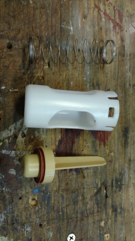

While i had to drop the tank to replace the fuel pump. I was able to remove the stuck valve and file off a slight bit of plastic from the "guides". Works like a charm and it only cost me labor.

Not too difficult. It took about an afternoon. I had to replace the fuel pump anyway. You have to be somewhat of a contortionist to get the valve out of the tank.

It would help if you had a 2nd elbow ;>). I used a small screwdriver like the ones used in electronics work to kinda pry one side of the "cage". after that it just popped off. The plastic used seemed to be very resilient to breakage. I was concerned about it breaking also. Then I just took a jewellers file and worked the "guides" until the valve floated free. I got the idea after watching this video.

SUCCESS!! :D Moves freely now, lets hope it stays that way.
