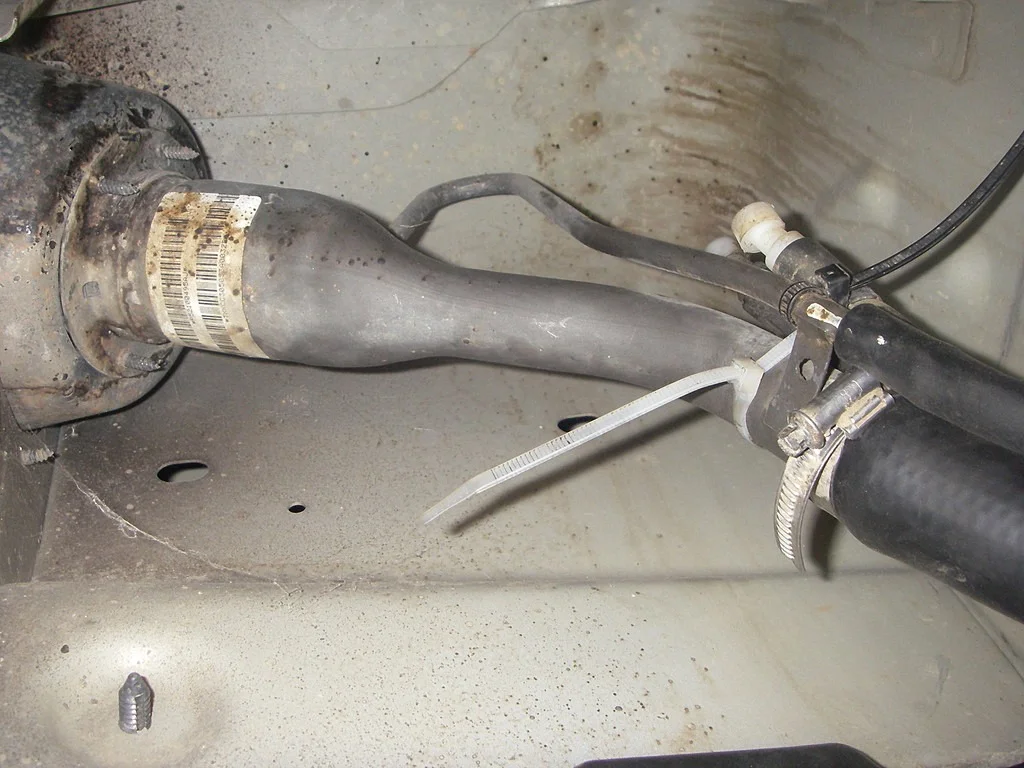

    On this subject, I have a side issue...
    The rubber vent tube that is zip-tied to the fill pipe (in this picture) with the little vent cap on it....
    Where does it attach at the other end ???? I found ours just shoved into the area above the tank but not connected to anything... Can't be right.. Any help very appreciated.
    Dave

    That is the rear diff vent tube. Double check it is still connected.

    Seems the previous owner or lazy mechanic didn't bother to reconnect the original diff vent tube, and just threw on a short hose and tucked it into the skid plate.... I've sorted it back to proper. Rob5589 thanks for the heads up... easy fixes are nice once in a while. Also thank you to the OP - the guidance was spot on - no more splash back at fuel time for us.

    Rob - looking closely at that picture it looks like there are actually two vent tubes.... is the 2nd one the transfer case vent? or?
    thanks much
    Dave

    The other one vents the gas tank.
