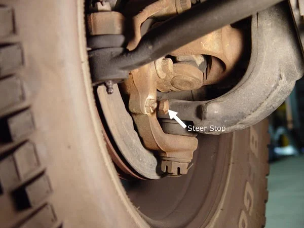

when you go full lock there is a stud on the knuckle that rubs against the axle. When you look it just looks like a bolt head that isn't holding anything down it is what stops your knuckles from trurning all of the way into the axle. Some people pull them off and put more washers in them to make it stop sooner than stock. Cover the heads with grease and see if the grinding goes away at full lock.
Found the source of the noise @ac_ .
My ravine rims are rubbing against the lower control arms at full lock.
Why, .. idk yet, .... its a stock jeep, it didnt rub with the stock tie rod.
