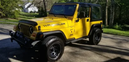

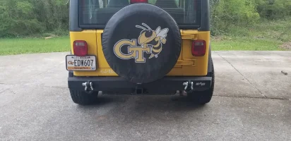

Several things to the TJ this week. Wife was out of town, so I took the time to do some things I have had planned.

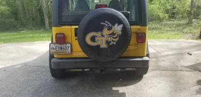

Replaced the factory rear bumper and trailer hitch with a new EAG bumper that I got for my anniversary back in February.

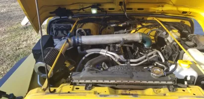

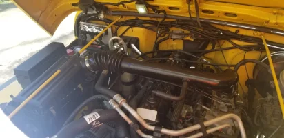

Restored the air intake back to factory with one I purchased on Ebay.
Earlier this week, the check engine light came on with code P0456. Further inspection today found a cracked hose on the emissions canister. I ordered a replacement, but in the meantime, I taped it up with some electrical tape.
