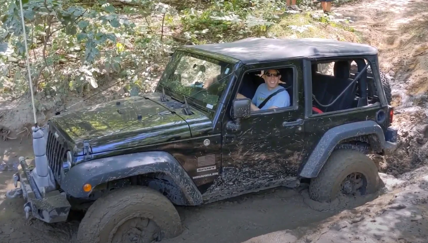

Here is a buddy in the Mud with 33" BFG AT's KO3's. He also has the 3.6L in that JK, so unlike our anemic 4.0L, he has to power to spin those puppies to try and clear them...No dice.

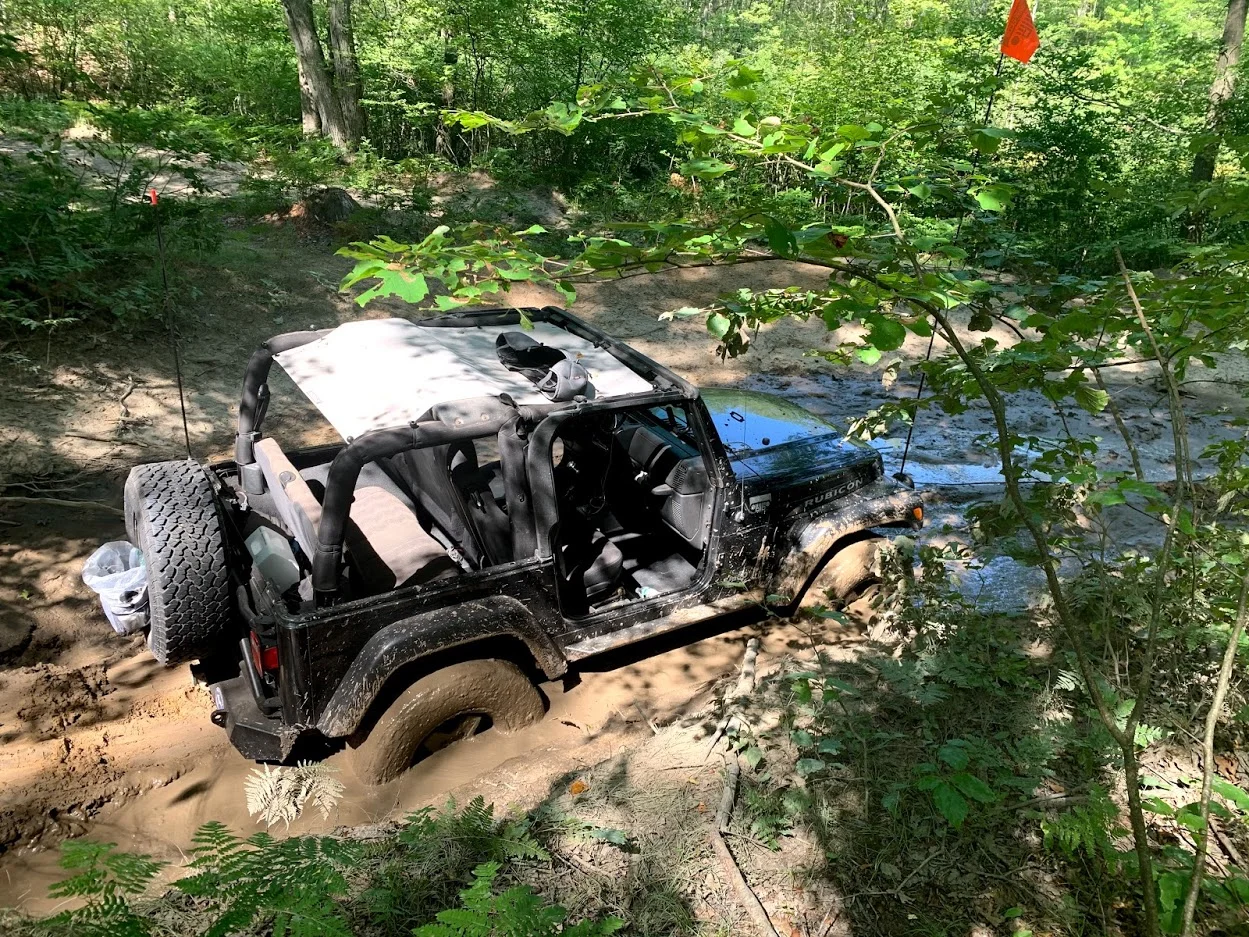

And because stupid is as stupid does, here is my TJ in the same pit with 33" BFG KM2's
Just to be clear, this is Michigan and our mud is a sticky clay. Its very fine, it gets in to everything and it packs down SOLID if you let it.
