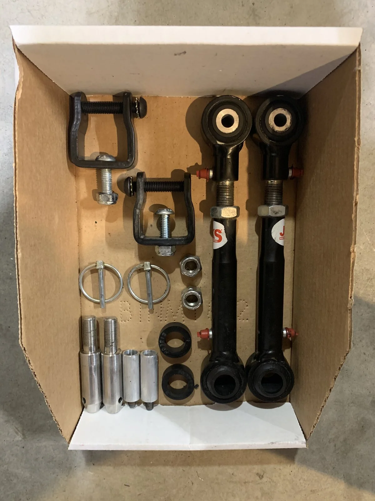

Considering they're $175 new, $100 doesn't seem bad. But I don't know the going rate.
I’ve seen a few on this forum go for 100-125$. Going to check them out tomorrow. If they’re in good shape i’m gonna go for it!
Reactions: Vasq
You can find jks for under 150 on amazon and rubicon express aswell so if the bushings are shot id just pass and order a new set

Well i picked them up! They’re in great shape, and came with all the hardware. Installing tomorrow :)

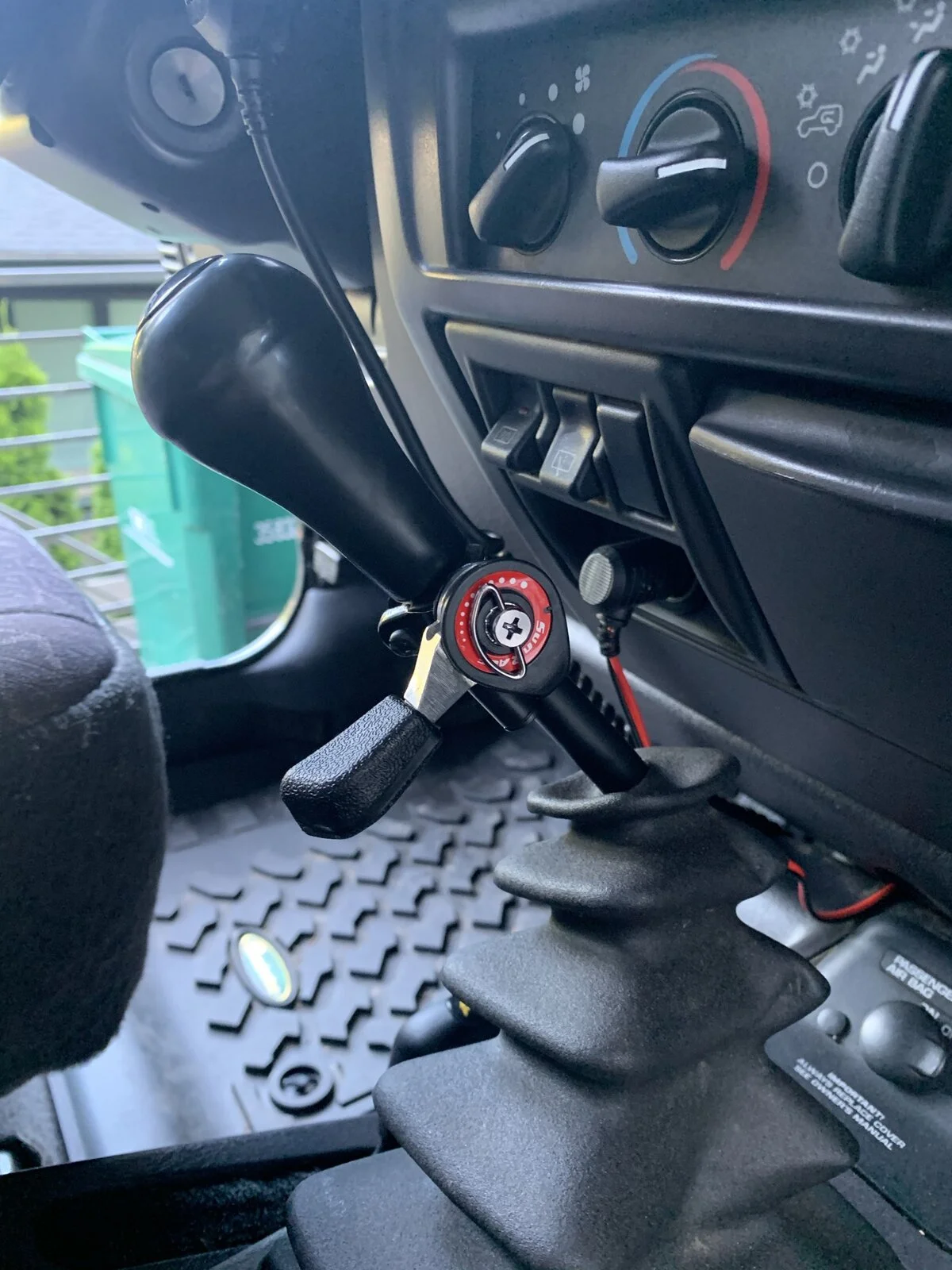

Haven’t written an update in a bit. Didn’t end up installing the JKS disconnects because found out we had to move houses, so everything got packed. I did however sneak in some time to hook up the hand throttle...

Hand throttle came in handy at the trail jam. Didn’t do too much rock crawling but i can imagine it’s even better for that.

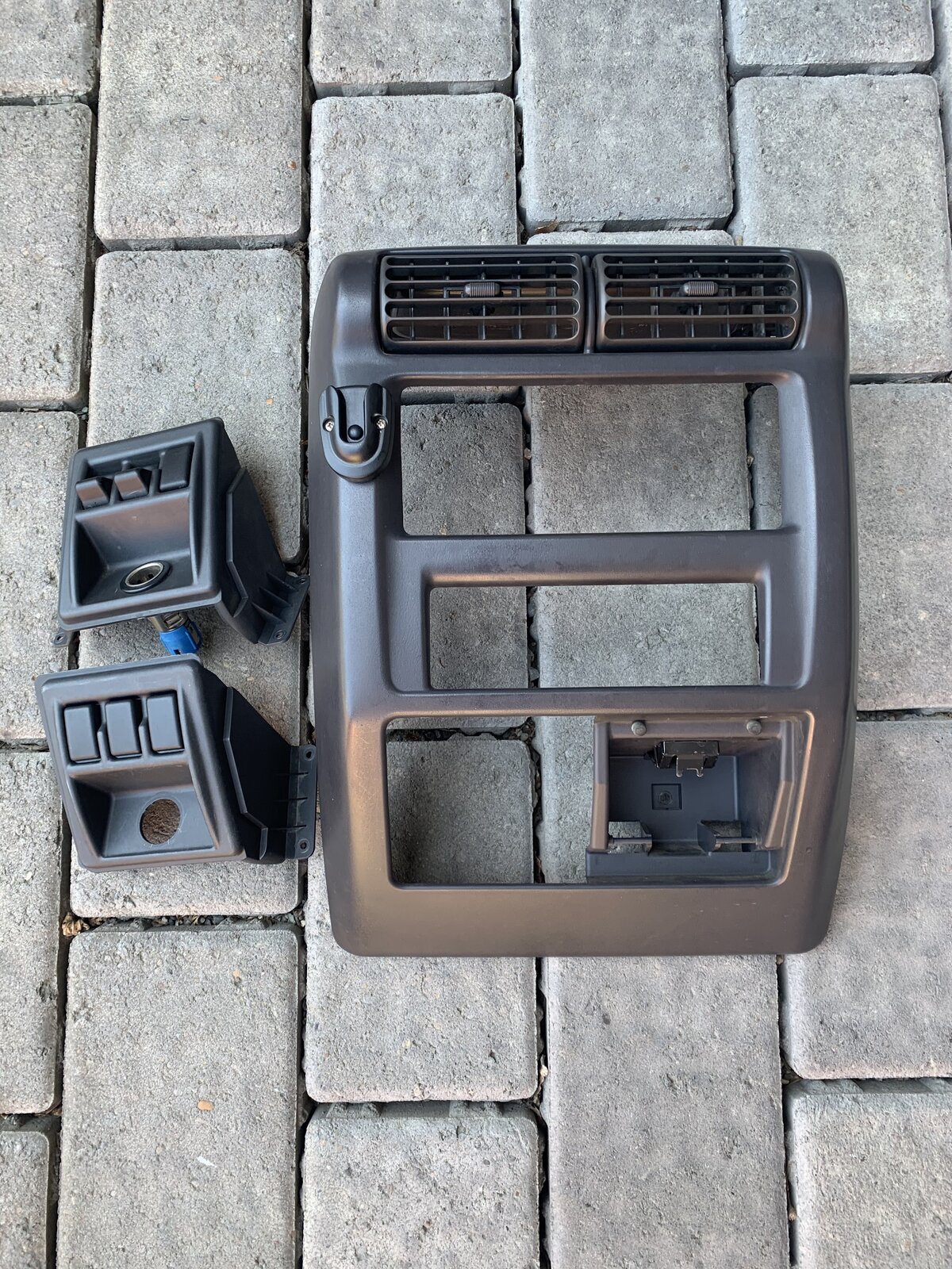

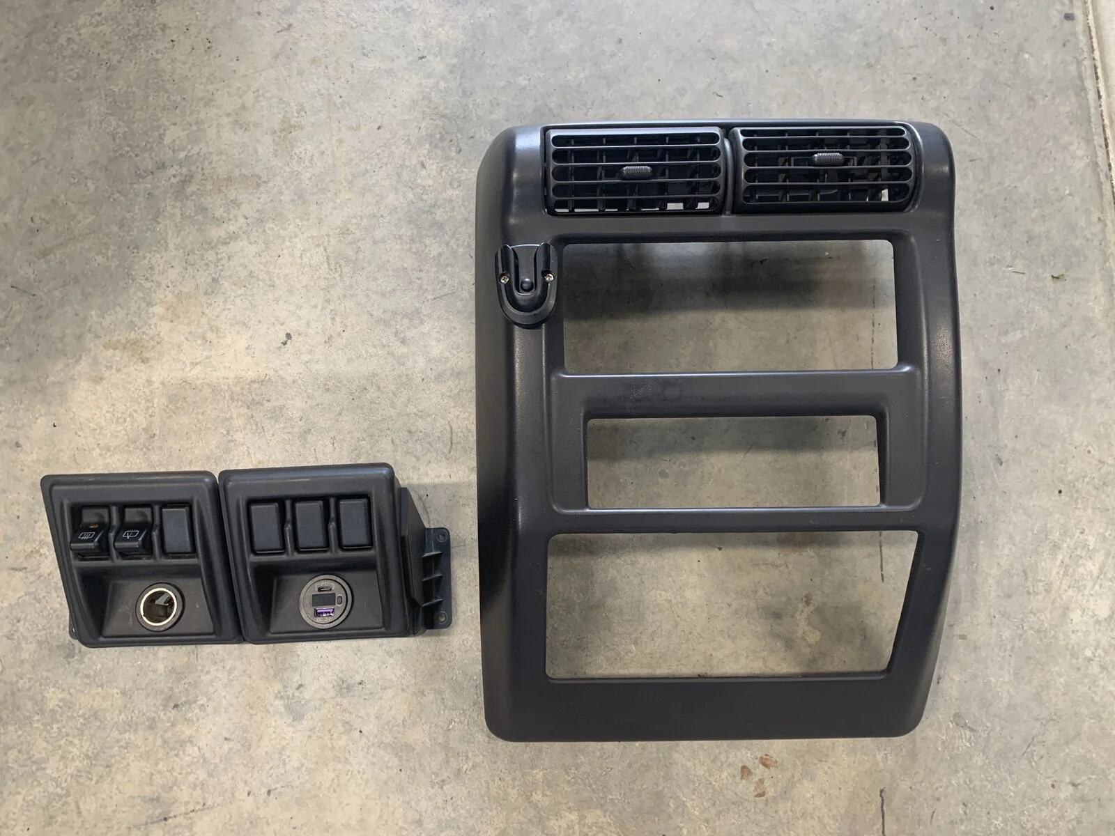

Also saw a mod a while back to add a second switch panel, and decided to try it as i had no use for the ash tray.
Visited that junkyard that @Vasq recommended. They’ve got loads of TJ’s and other wranglers
Also saw this little guy...
Body is basically completely gone, not many parts left. Huge project for someone, though i was tempted
Anyway, picked up an extra switch panel for half the price of ebay, and got to work!

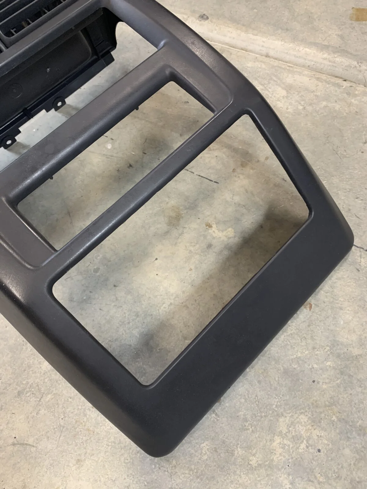

Marked the line

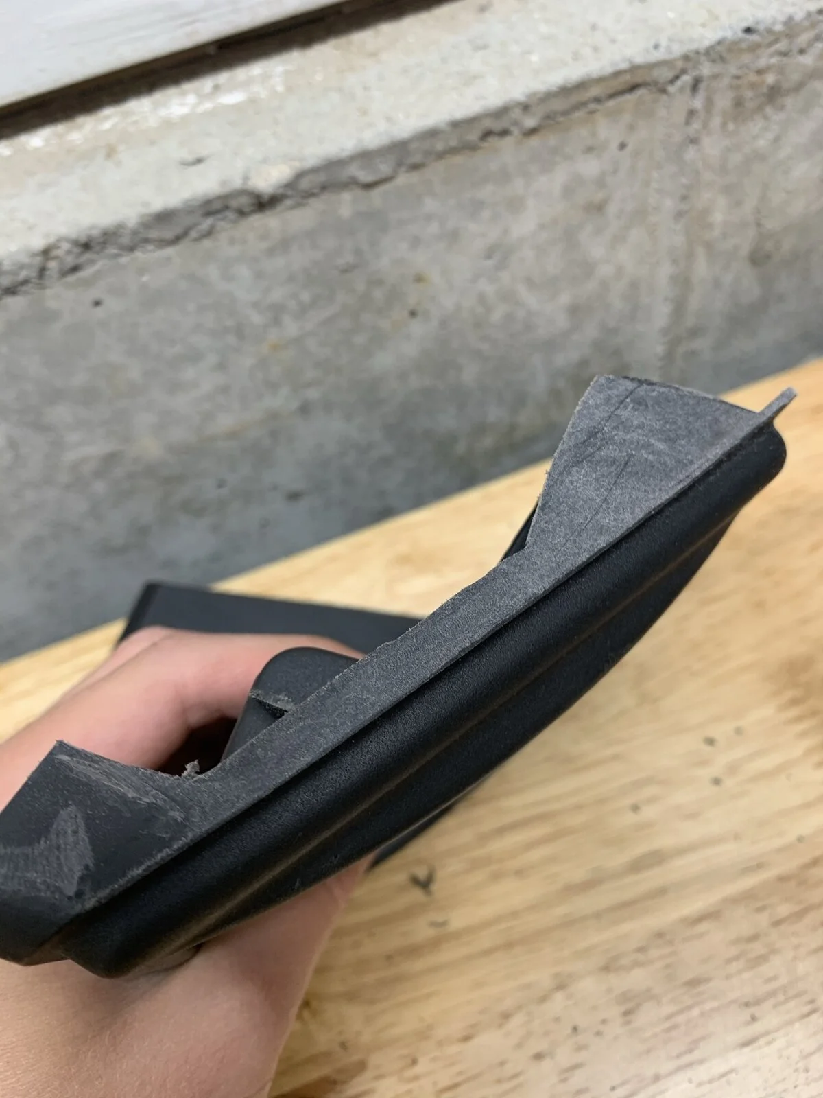

Made the cut, and used some files to get the finer details

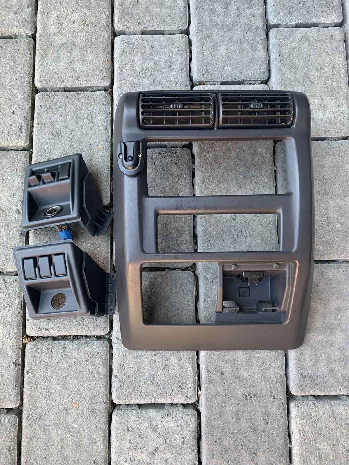

Then had to cut and shave down the edge of the new switch panel to fit beside the old one
Here they are being held together, which gives me an idea of areas i need to continue shaping

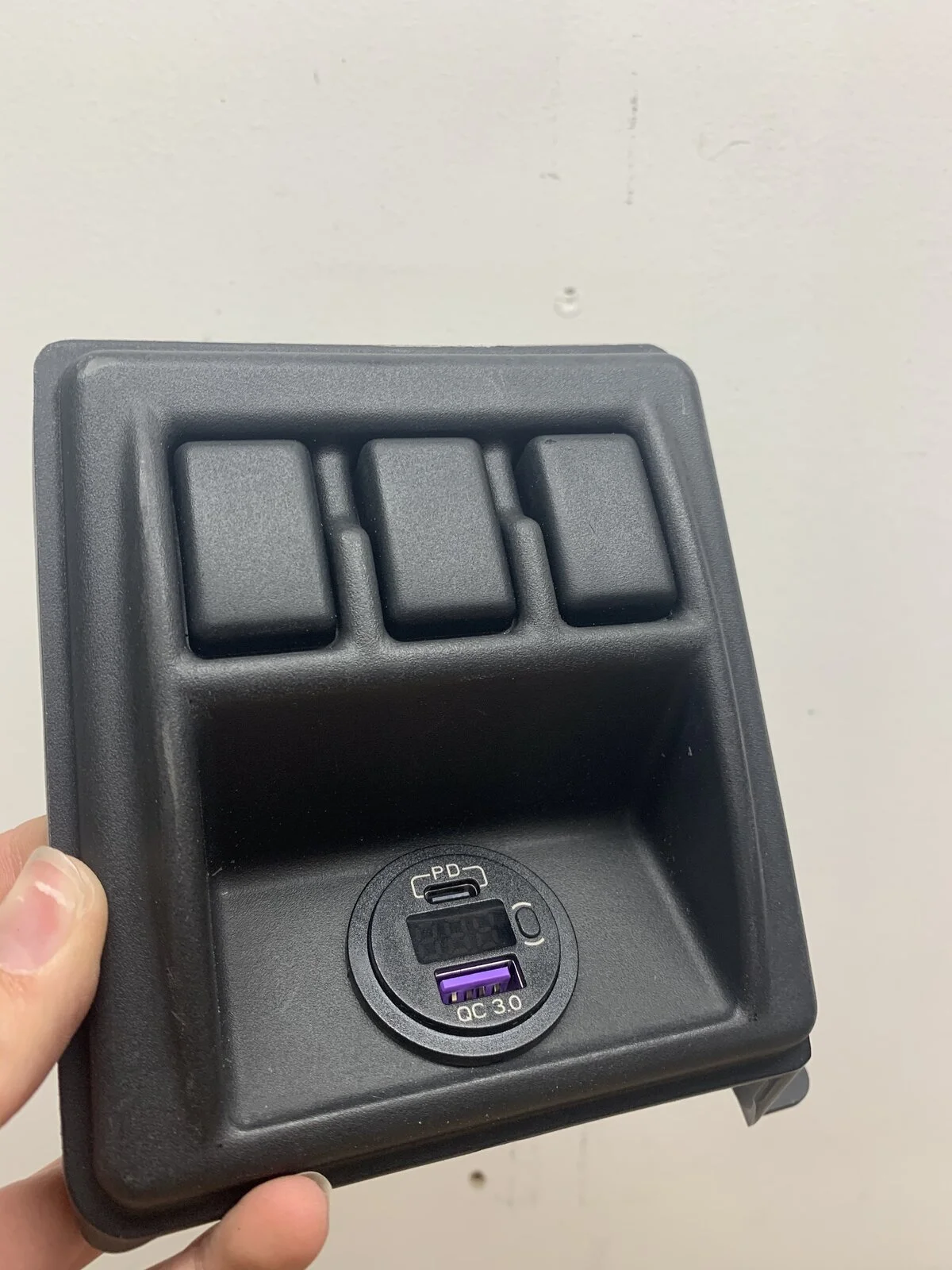

While i was at it i added a USB port to fill the extra cigarette lighter
And mounted the two together
Here’s what i’ve got so far!

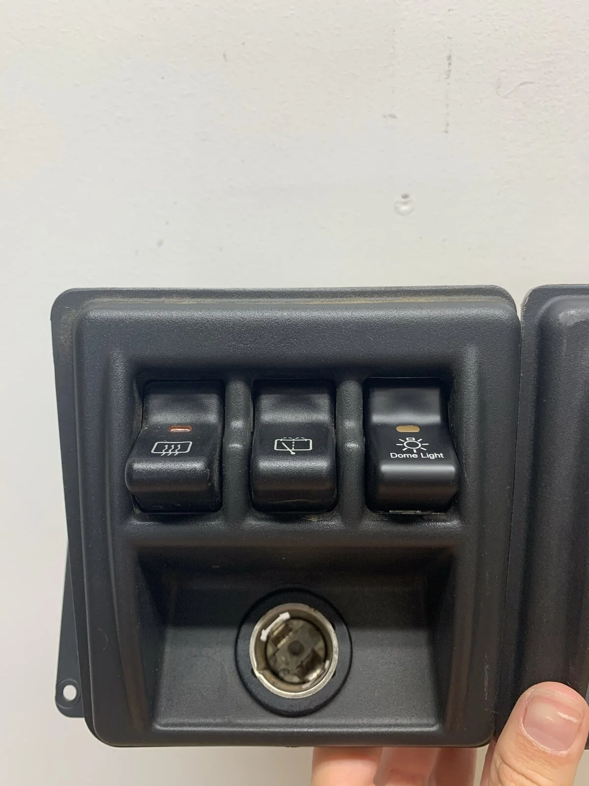

Also added a dome light switch. I’ve been wanting to control the dome light for a while, since i pulled the fuse so it’s not on when the doors are off
Test fit! Bit more trimming to do

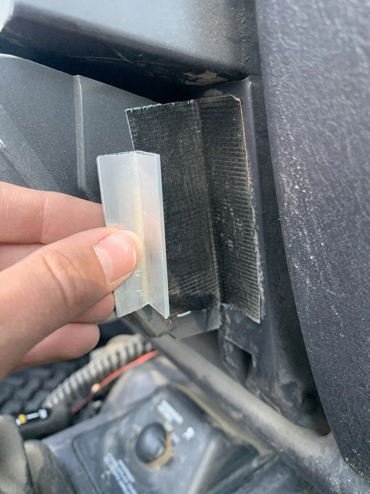

Did some more trimming and then made the mount for the new switch panel. Just used some small angle iron i have laying around to mount it
