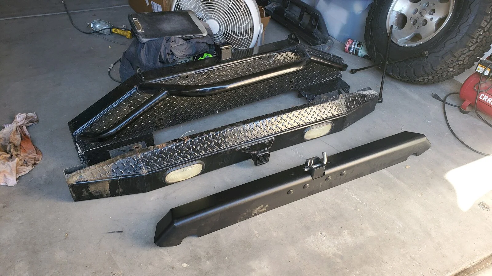

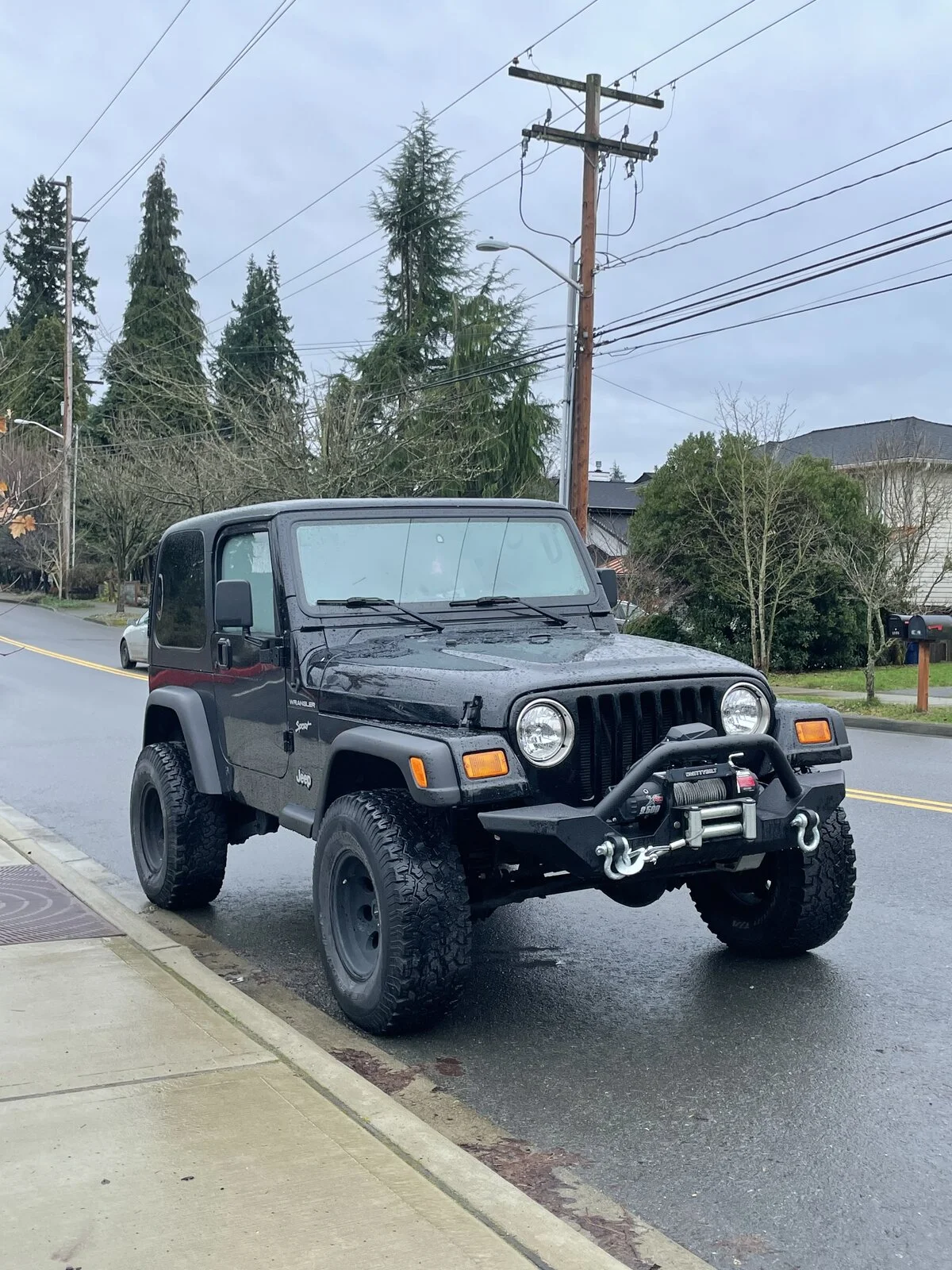

That’s a beast. You tow?

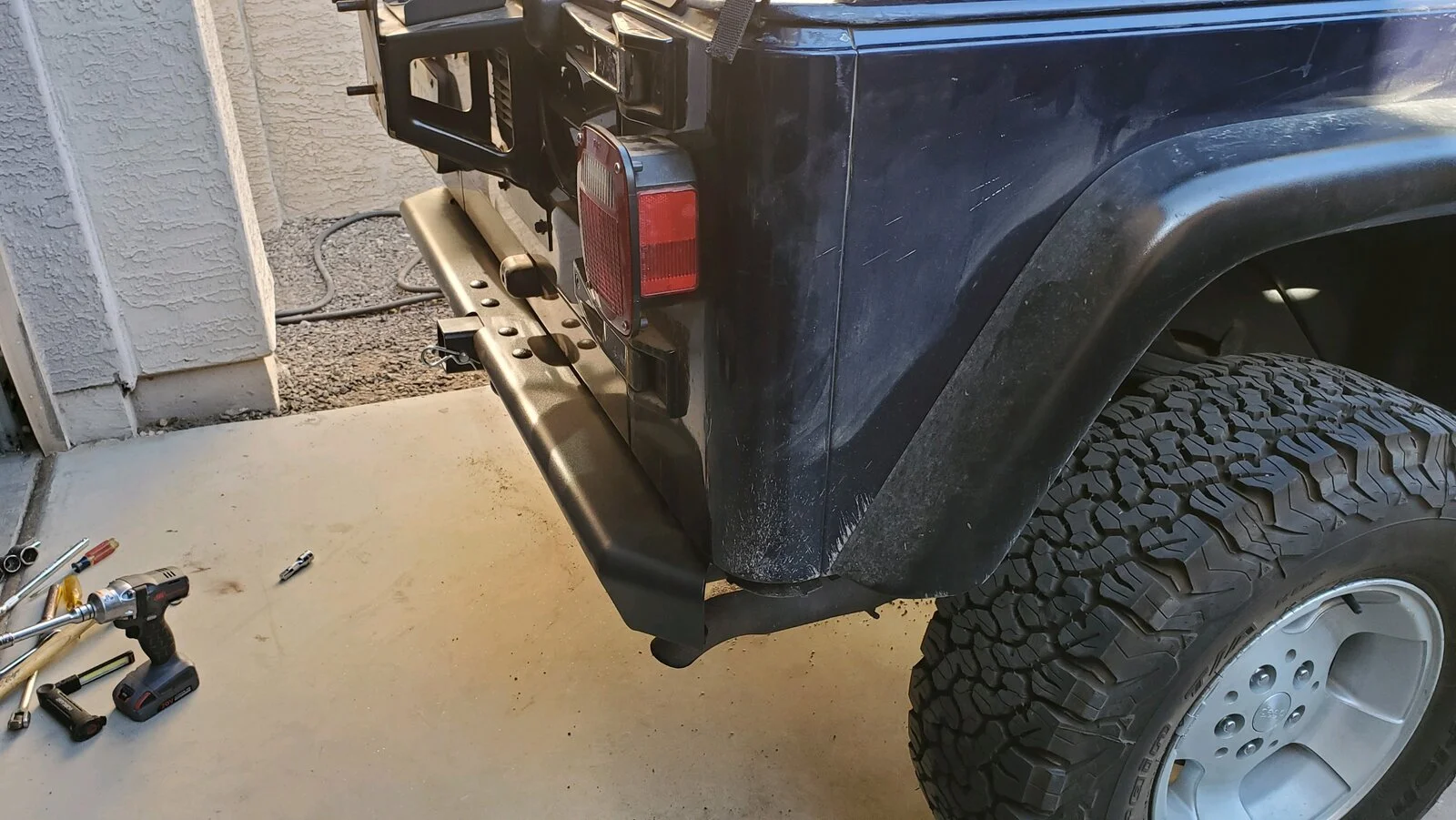

I’d be interested in your current savvy bumper for sure if you decide to switch
I may just toss both. I am not sure I can keep a straight face trying to sell them on Craigslist
Is that the savvy rear?I may just toss both. I am not sure I can keep a straight face trying to sell them on Craigslist
View attachment 298862.
How thick is the metal. Old bumpers make for good brackets. Such as cb mounts. Or welding practiceI may just toss both. I am not sure I can keep a straight face trying to sell them on Craigslist

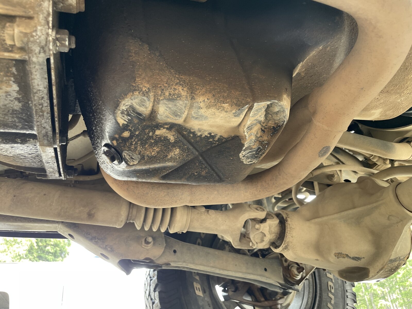

Also sustained some damage, obviously i need a new oil pan and savvy under armor, but can i keep driving it as is? It doesn’t leak and we’re moving houses so i don’t have time or space to work on it for a couple weeks.
Finally got some time in at Tahuya during the quadrawpaws fun run. Here’s a clip of why i need to check my bump stops (sorry for the quality)
If it doesn‘t leak, i think you should be fine.
Do i bother replacing it? Or just get armor
Replace it. The oil pick up tube/screen is in the middle of the pan. I'd want to at least check that and make sure it didn't get impacted. Based on where the dent is I doubt it did, but it would still bother me. FWIW, changing the pan is a bit of a pain, because you'll have to drop the exhaust to remove the pan. On the plus side, if you have a RMS leak, now would be the time to fix that!
How urgently do i need to replace it?
Only issue is i replaced the oil literally 3 days ago. And wouldn’t want 40$ worth of oil to go to waste.
