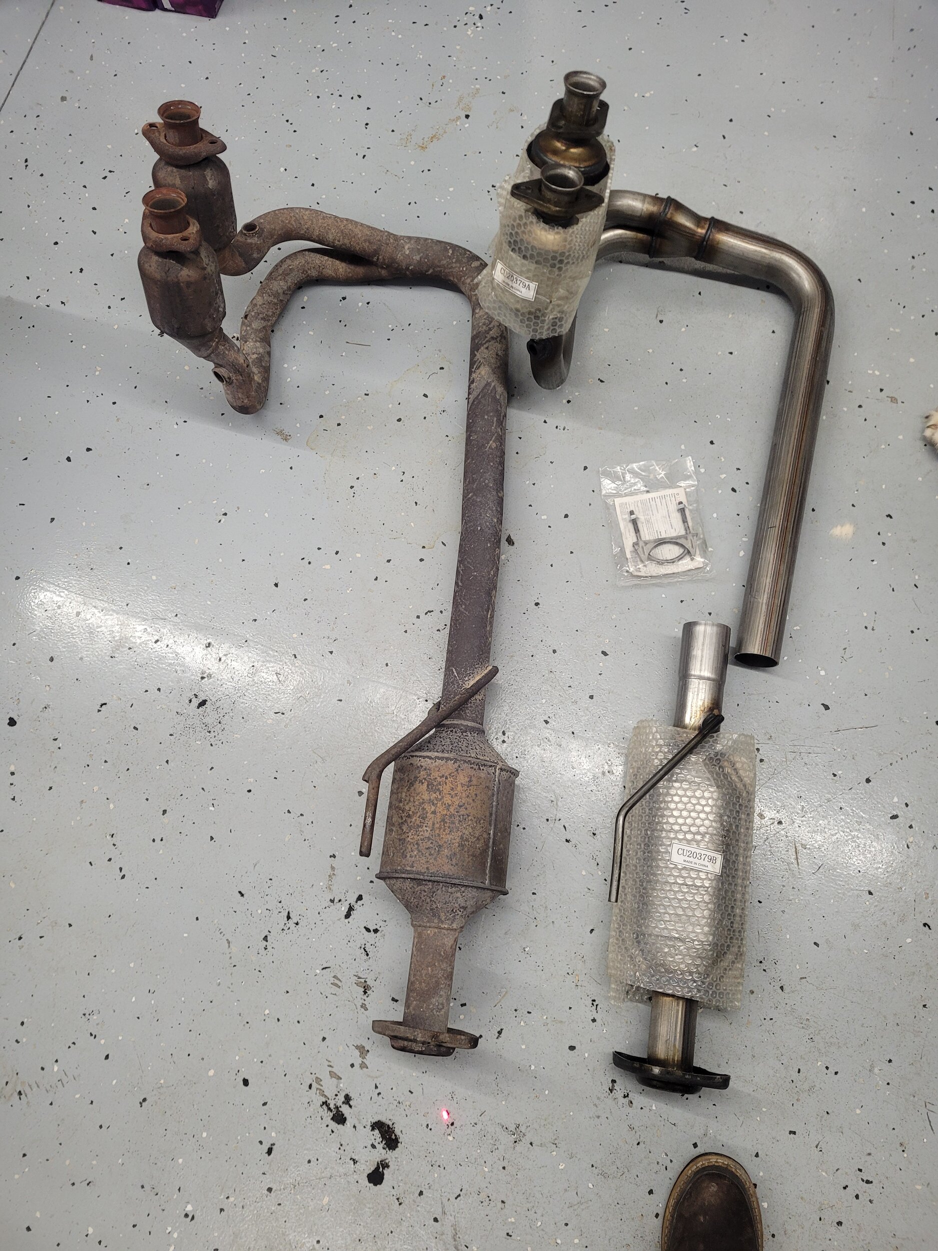

I received and installed mine tonight. I can confirm that it bolts up no problem on a 03 TJ.
Buy the way, I didn't go back and reread all the above posts but someone mentioned stainless steel. This system is not stainless. A magnet sticks to it anyway. Still a great deal.
