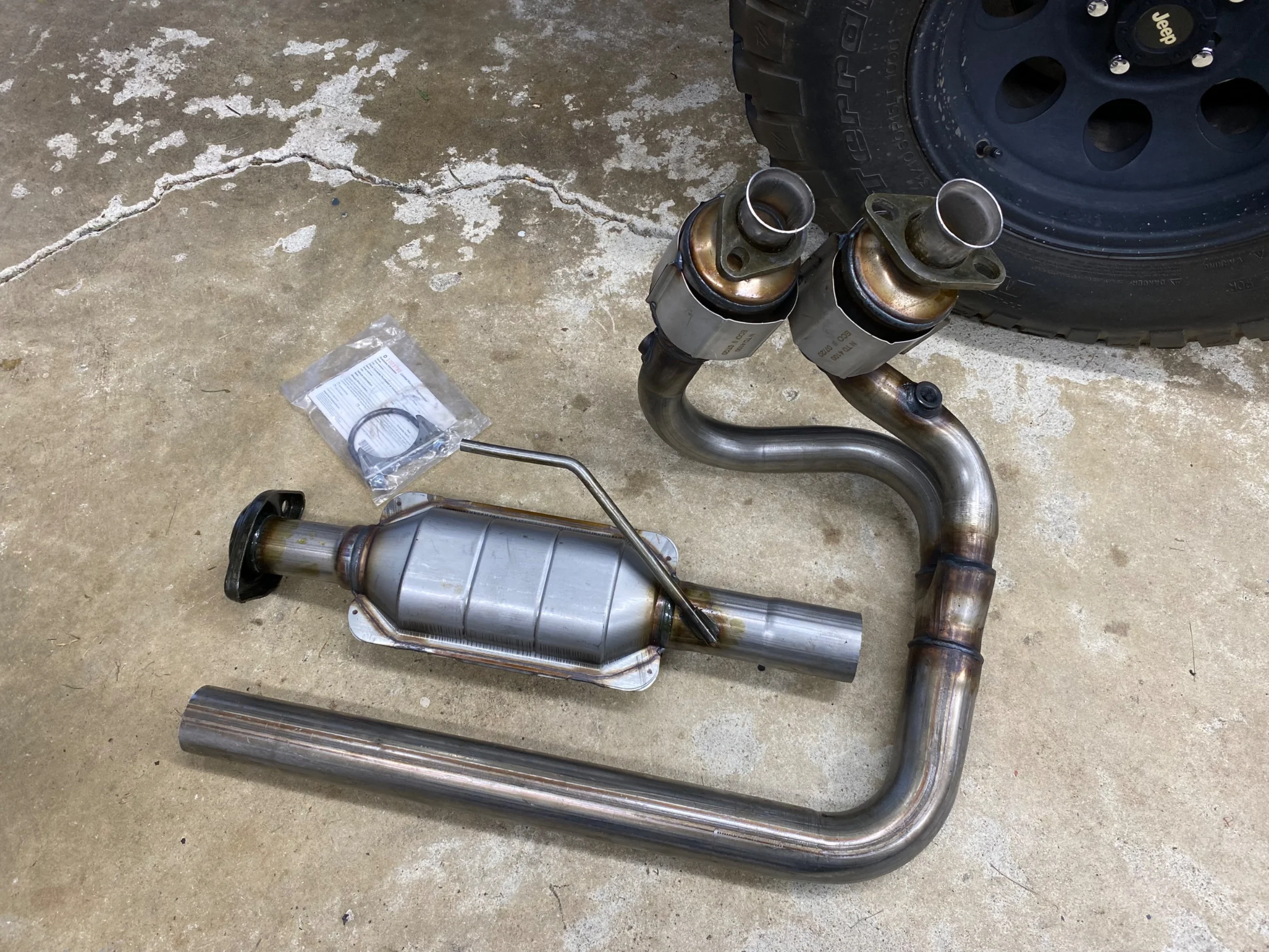

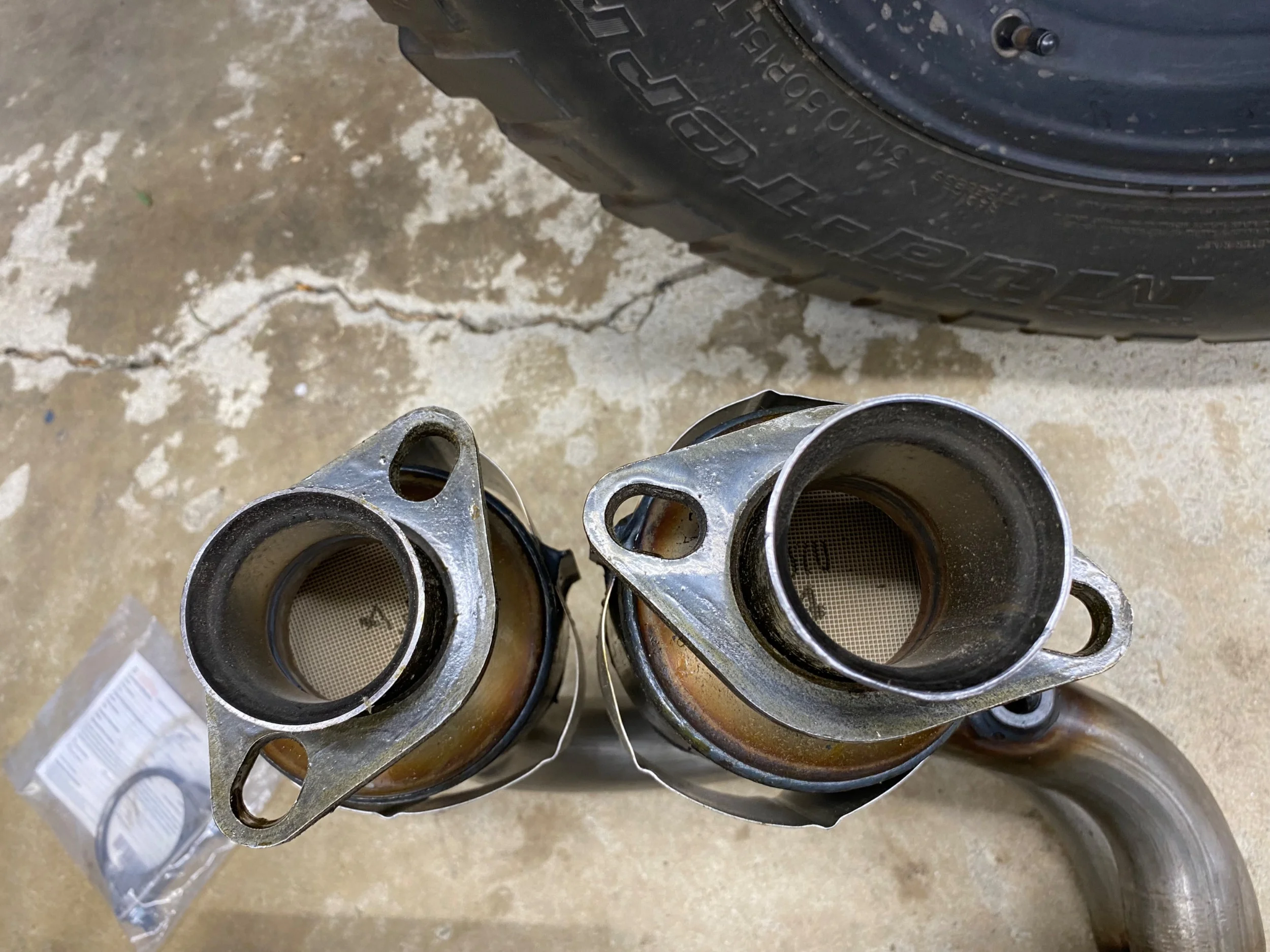

Mine arrived today. Box was a little damaged and a small flat spot on one of the cat flanges. Will be packing it up and sticking it in the attic until I need it.

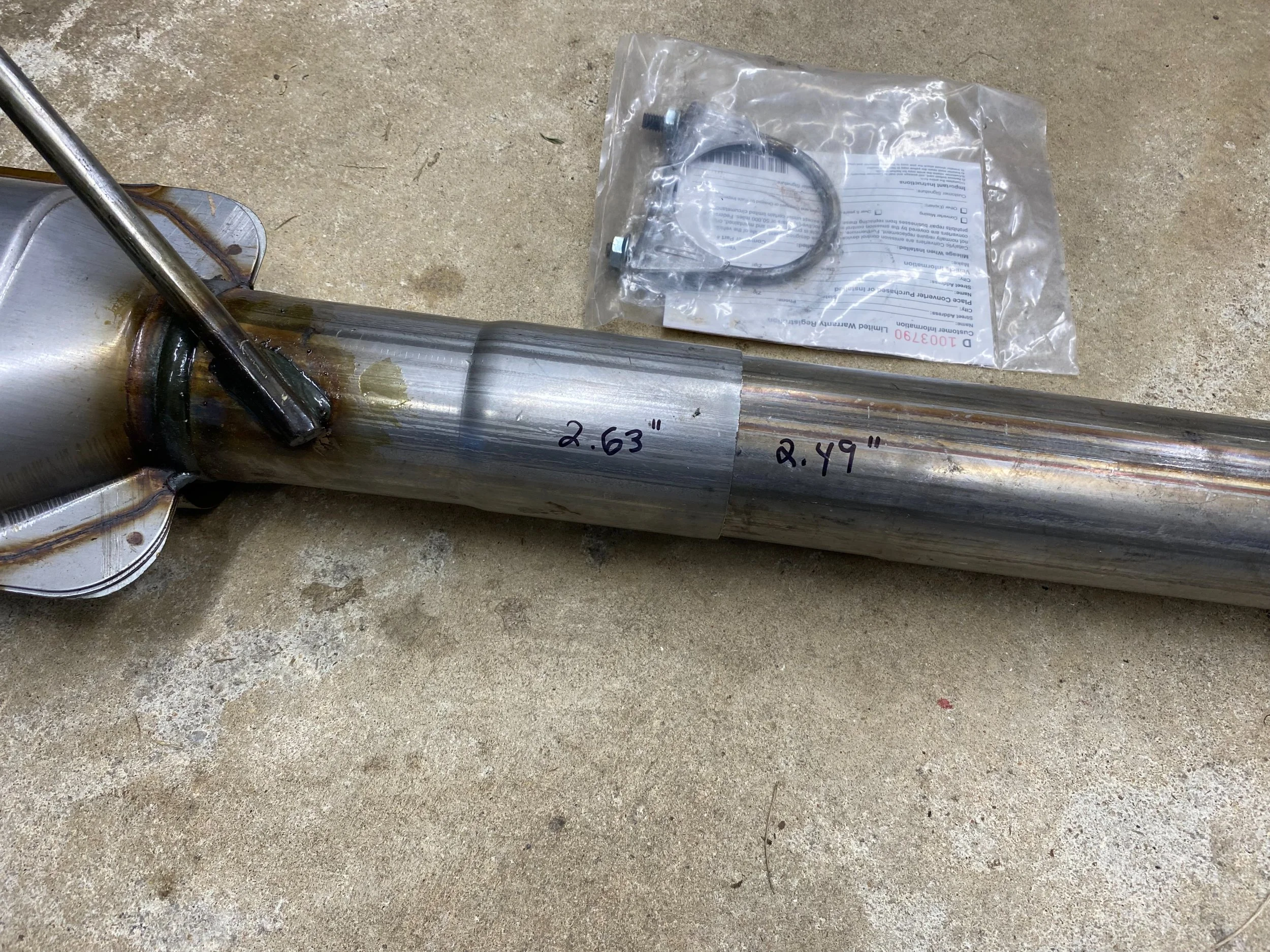

If I wanted to connect these two with one of those wide band type clamps instead of the supplied U-bolt, what is the proper term for them to search for one?
Are there any that are better than the others?

Something like this?
https://www.amazon.com/dp/B078TVV4FT?tag=wranglerorg-20
Why not the u-bolt clamp?
Ahh, yes. Thank you.
I like how this is 2 pieces compared to the 1 piece that my jeep came with. I feel like it would be easier to take apart in the future if I'm doing something like removing the oil pan. My experience with U-bolts usually involves dimpling the tubing make it hard to separate. Unless what I've worked on was overtightened or something.
Do those type of clamps require any type of material to seal it? Like an RTV or something. Probably dumb questions, but I've never used anything like them.
The Walker style ones I used with my muffler have a small amount of black sealant on them between the bolts. The band style can leak where the band curves/bends up into the bolt section.
