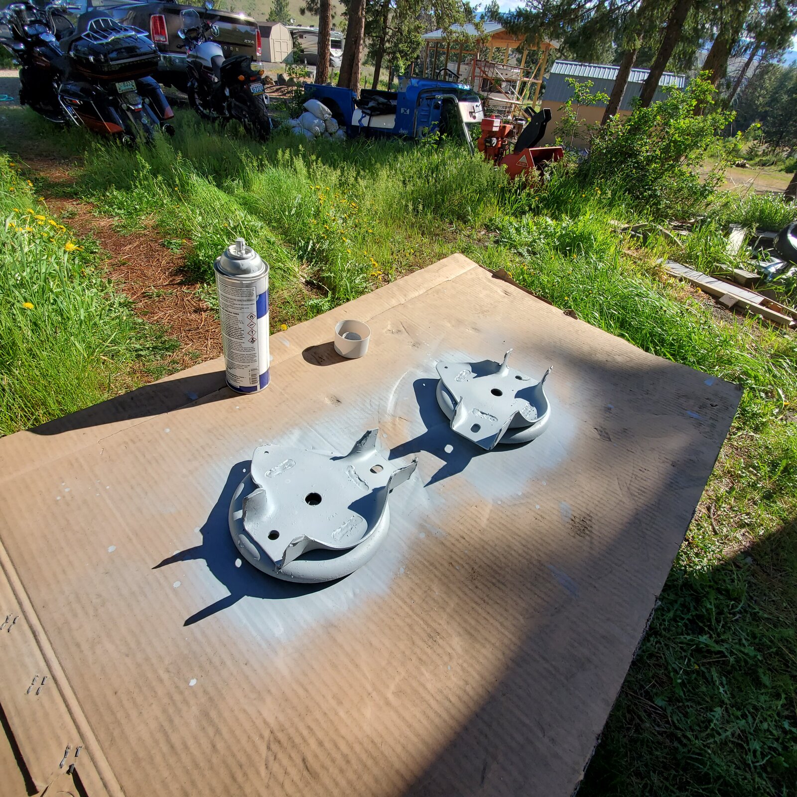

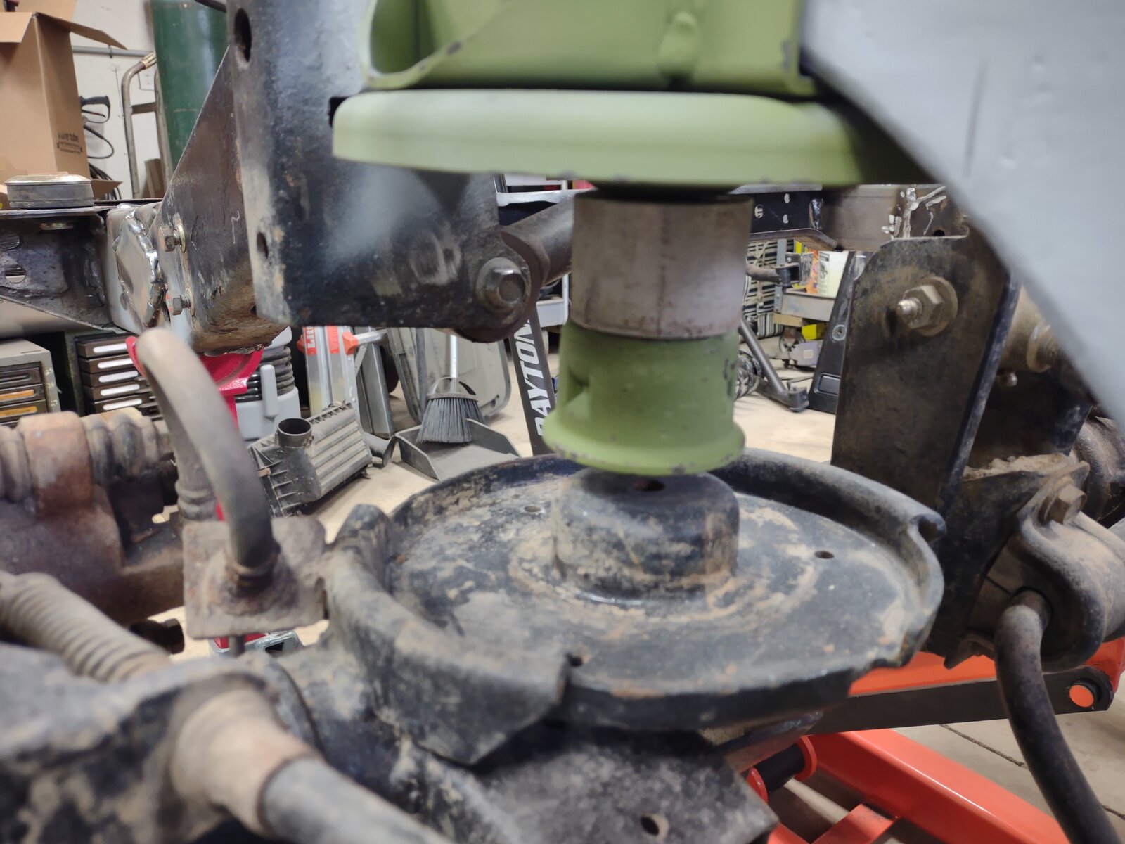

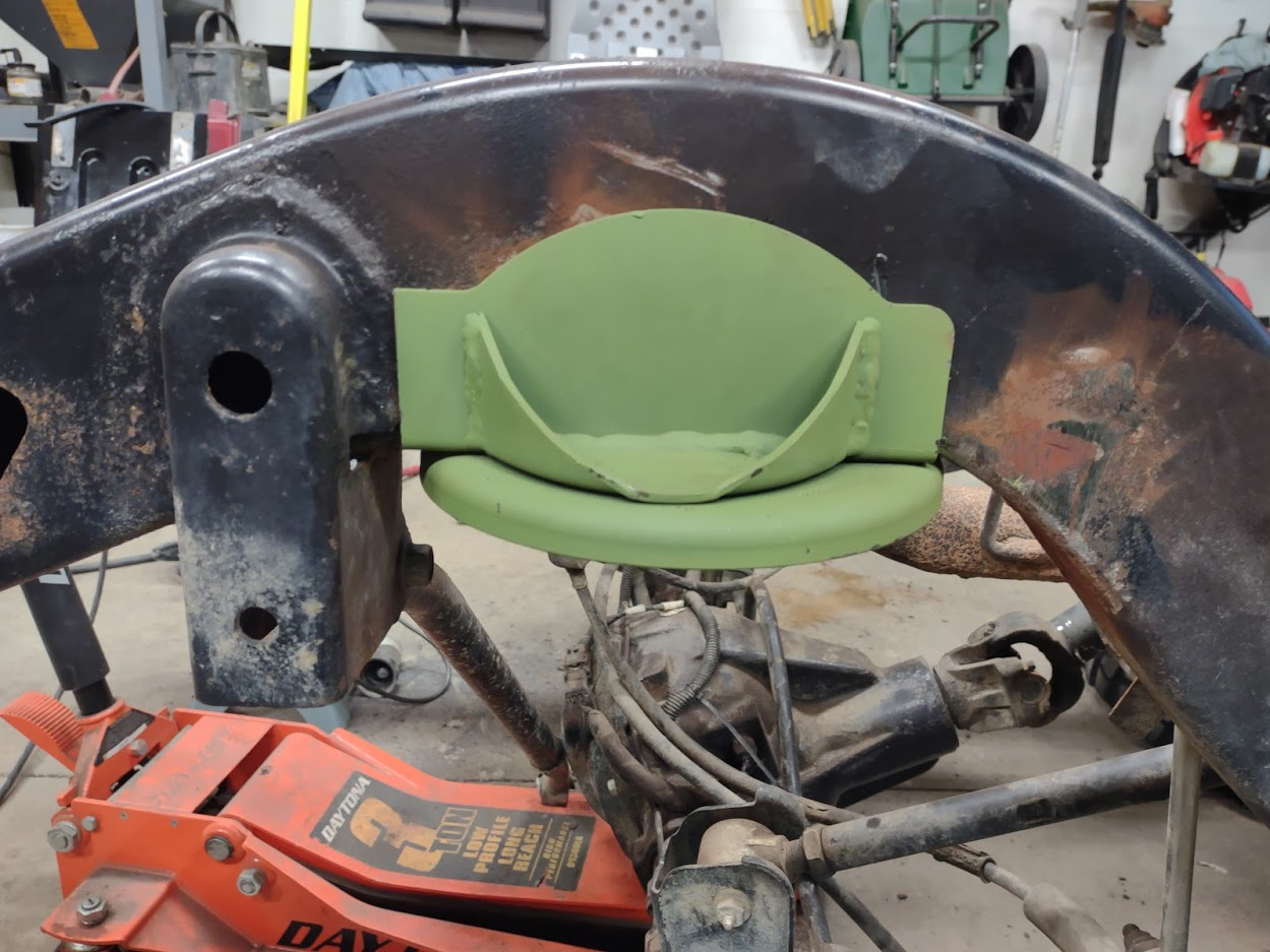

Its a piece of cake, really. My process was get a good reference to frame height, sitting on its own weight (I used the two rear corners). Then I pulled the springs and supported the frame. Cut the buckets out...some quick work with a 4" cutting wheel on a side grinder probably a half hour, max. You'll also need to cut the long end flush to the bucket (notice in my picture the u-channel that wraps the frame is about even with the bucket). Clean the paint off the frame and put the perches in place with clamps. I dropped it back down on the springs to make sure my heights were relatively close (I'm within an 1/8", IIRC). Pull the springs again and check bump alignment. adjust if necessary. When they look good, burn em in and paint.

Mine are Dorman replacements. My factory originals were rotten. The important parts are the same...

Regarding outboard, that is a whole lot more work than just moving the upper perch. It's the last "mod" to the Jeep before it's done. My bumps line up almost perfect after the relocation.View attachment 259853
