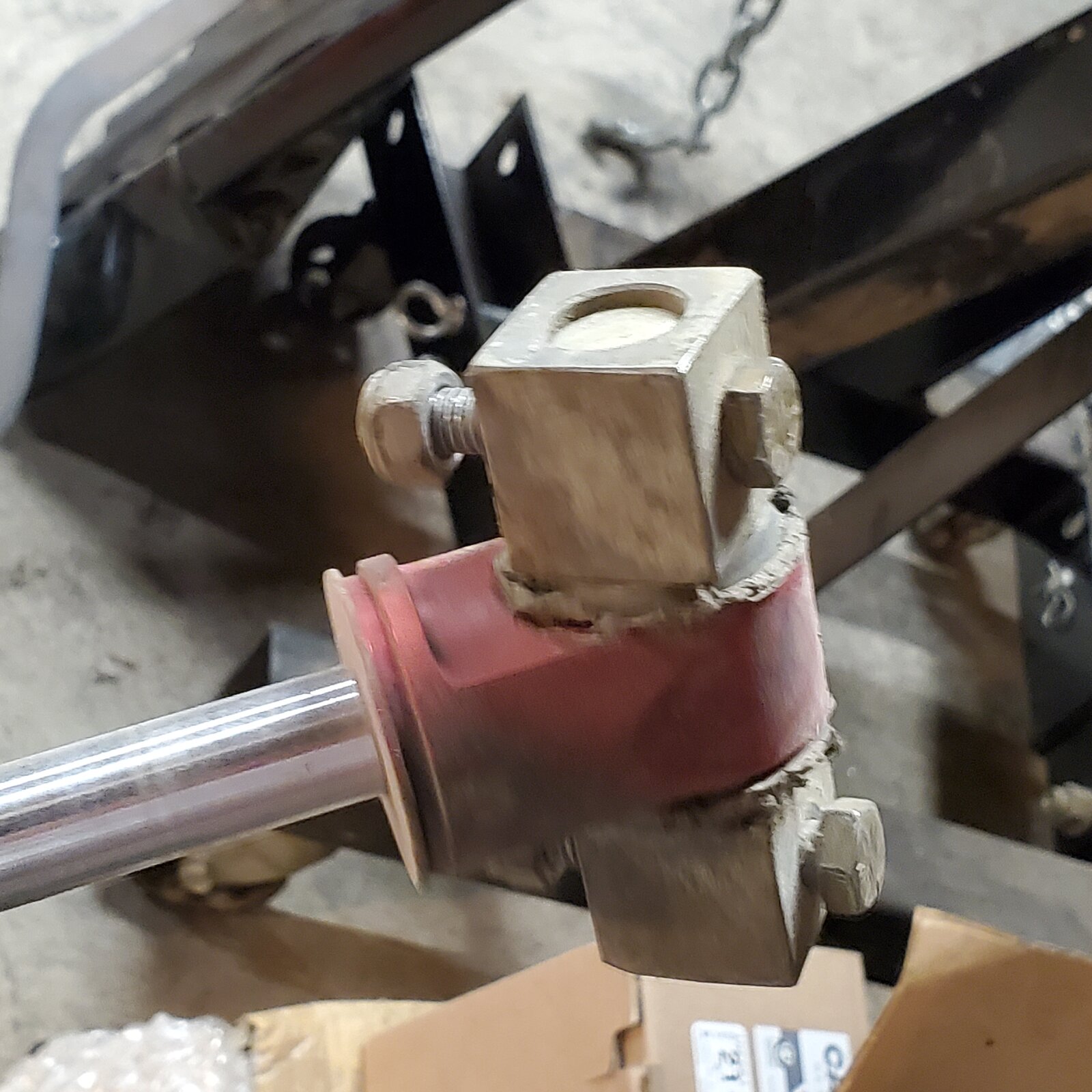

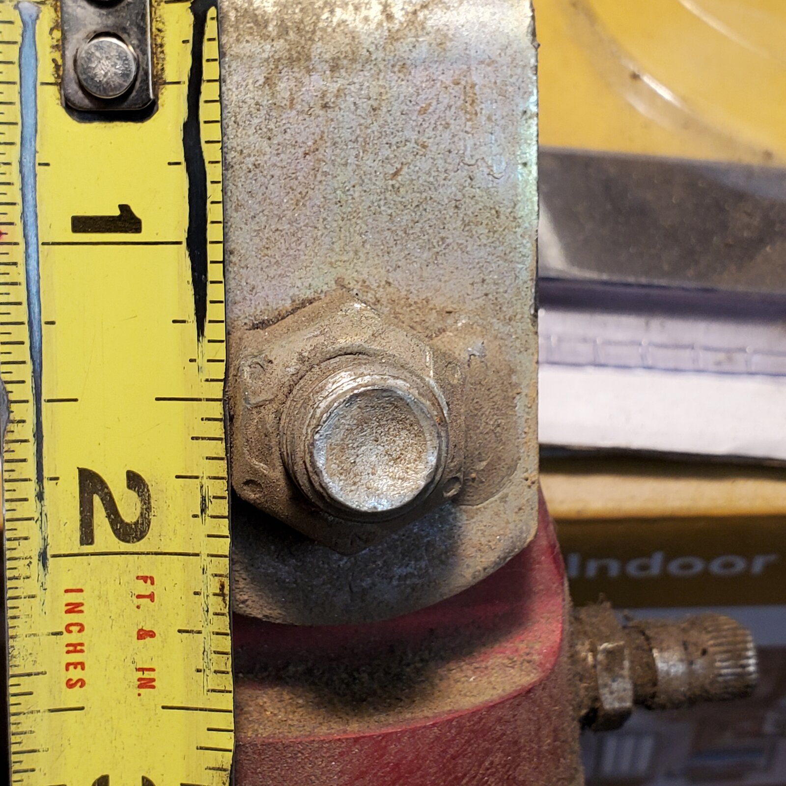

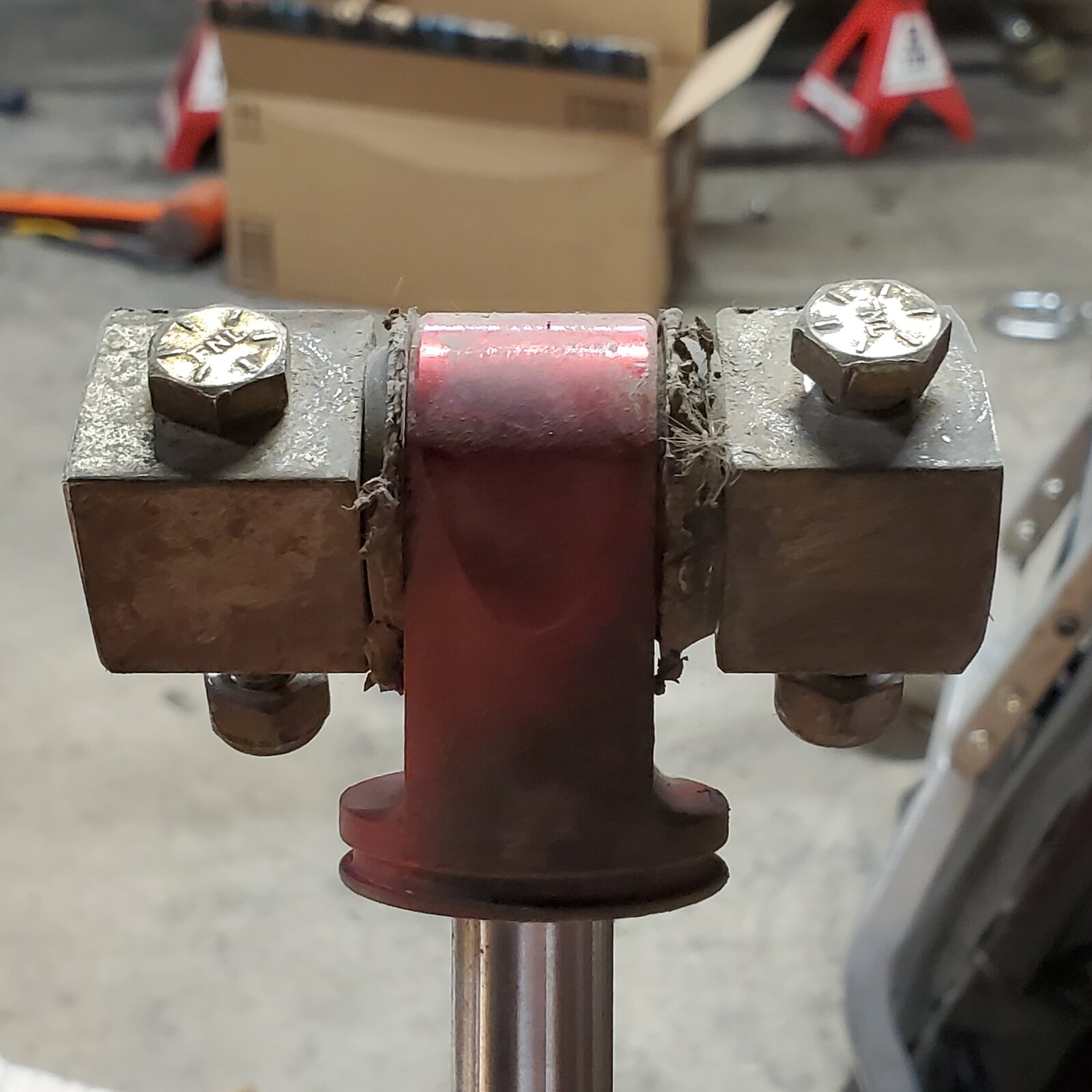

I'll have to get you numbers tomorrow or Saturday but here what they look like. I have the stem adapters for the fronts and then the bar pin eliminators for the bottoms. It's the rears I'm not sure yet how they would fit? And if I remember the information correctly they can be mounted either direction.
FRONTS
REARS

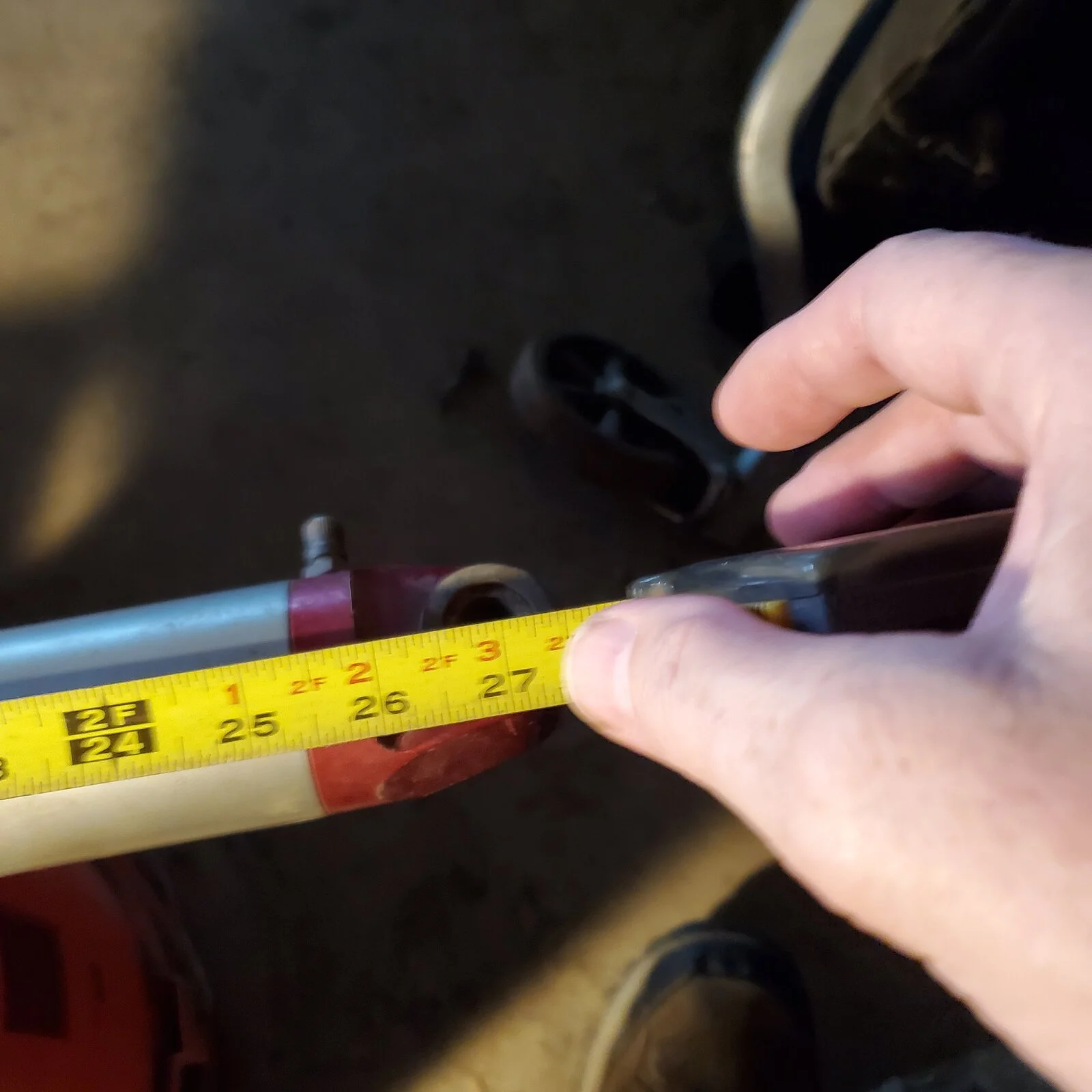

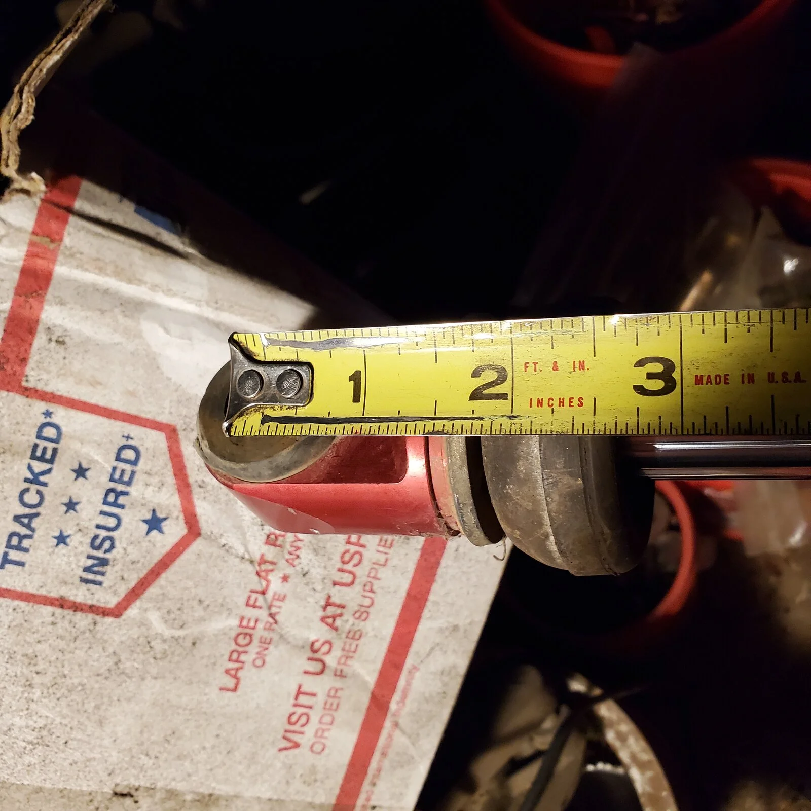

OK got some numbers for ya.
Extended length is 26 7/8"
Collapsed length is 18" as close as I can tell.
And then the JKS pin eliminator is 1 11/16" as close as I can tell.

The bar pin eliminator on the bottom doesn't change the length but I figured I'd give you a picture of them.

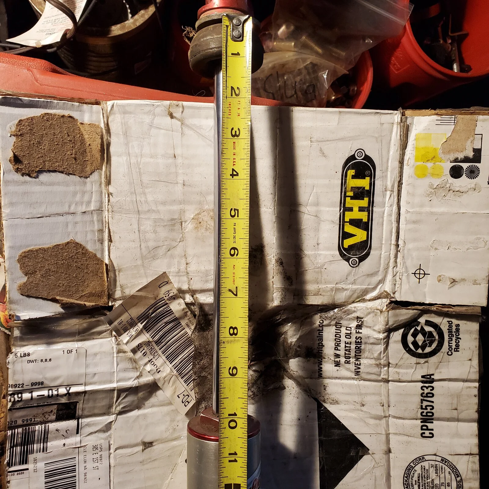

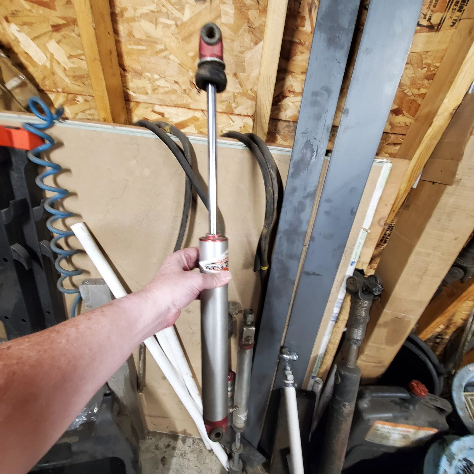

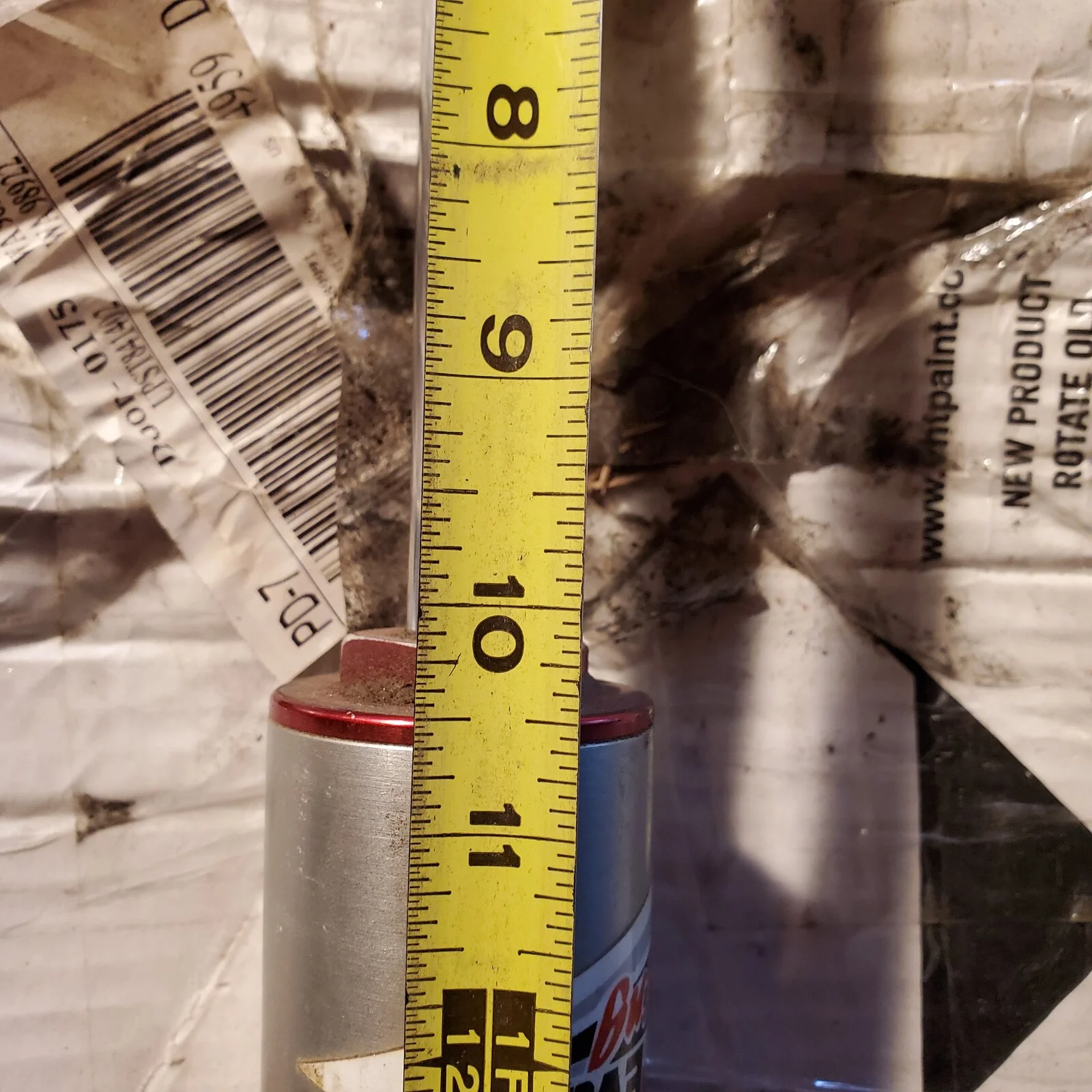

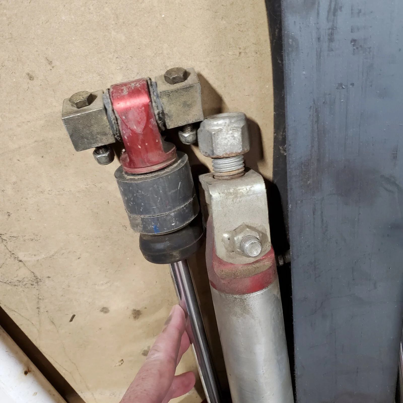

Ok, I've been thinking about this, and looking at your numbers. If I subtract the collapsed length from the extended length I get 8 7/8" travel. That doesn't look proportionally correct in the picture of you holding the shock in post #3502, so I'm wondering if you can measure the shock shaft, including the rubber isolator on the shaft. These look like nice shocks and something I would like to try. I'm driving through Ellensberg area around Sept 4 with my wife for our anniversary. That would be a good time to pick them up, come home, and set them up.
Thanks, all in the name of...
Yep I'll go back and measure stuff again for you.
Looking at their chart I'd guess they have to be either a 10" or 11" travel and I'm guessing 10" travel.
I tried scaling the picture and I get 12” but my science could be off a little.😉

So I'll measure the shaft for you and measure the lengths again.
I look forward to it.
Also, I need to correct something, these are steel shock bodies with Aluminum Billet design. They can be rebuilt and re-Valved!
Okay I hope this helps. There is 10" of shaft showing so I'll SWAG it in the Name Of Science and guess they are a 10" travel shock.
But it's still showing 27" from eye to eye which is an inch longer than their specs unless I am measuring it incorrectly which is possible since I'm such a HACK anyhow.
Hope this helps a little more.
