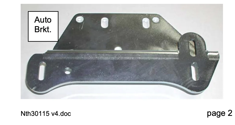

Well there was a transmission mount in the parts. If it was the correct part it could make it easier.
I was just thinking they were going UCF, so I got confused. Let me know the plan and I’ll figure it out!
I don't know if it was the correct transmission mount other than it looked like the one I had. If you look at this thread in the first picture it's the 2nd item on the left with the oval cutout in it. Gray in color. That is the transmission mount.
https://wranglertjforum.com/threads/what-are-these-nth-degree-parts.55360/
I looked into this, and this is the Auto Bracket. The other one pictured in the thread is the manual bracket. We'd need this one for the 42rle. ☹️
Reactions: Wildman
I looked into this, and this is the Auto Bracket. The other one pictured in the thread is the manual bracket. We'd need this one for the 42rle. ☹️View attachment 279430
Interesting since I used the other one on my auto.
Well them I think we'd just be better off to:
1) Build our own bracket or get the Lo-Pro UCF bracket and make it fit.
2) Get a crossmember kit and install it and then don't have to worry about the bracket at all.
my 04 auto has the 1 from Wildmans pics.
i tried a plate mount with bushings on the ends and it transferred a lot of vibration (my trail mirrors shook like crazy at a standstill).
then i got to readin some and found info about how we use a 3point sys and how changin it to a 4 point increases torque on our drive shafts and shock load on diff gears and blah blah blah....i changed it.
i took the OE mount and chopped 5/8" of the depth of it and kept the OE rubber in the middle (might still have it somewhere). then reworked my tubes to work with that, it all fit under a 2.5" drop skid.
and this brings us back to Wildmans issue with engine torque and that shock tower clearance...........i think his sys is gonna be rigid and it's not gonna twist that much because of those cross members locking that drive line. plates on the driveline force it to move a T lever support sys thats rigid in comparison to a center mount that it can rock on.
