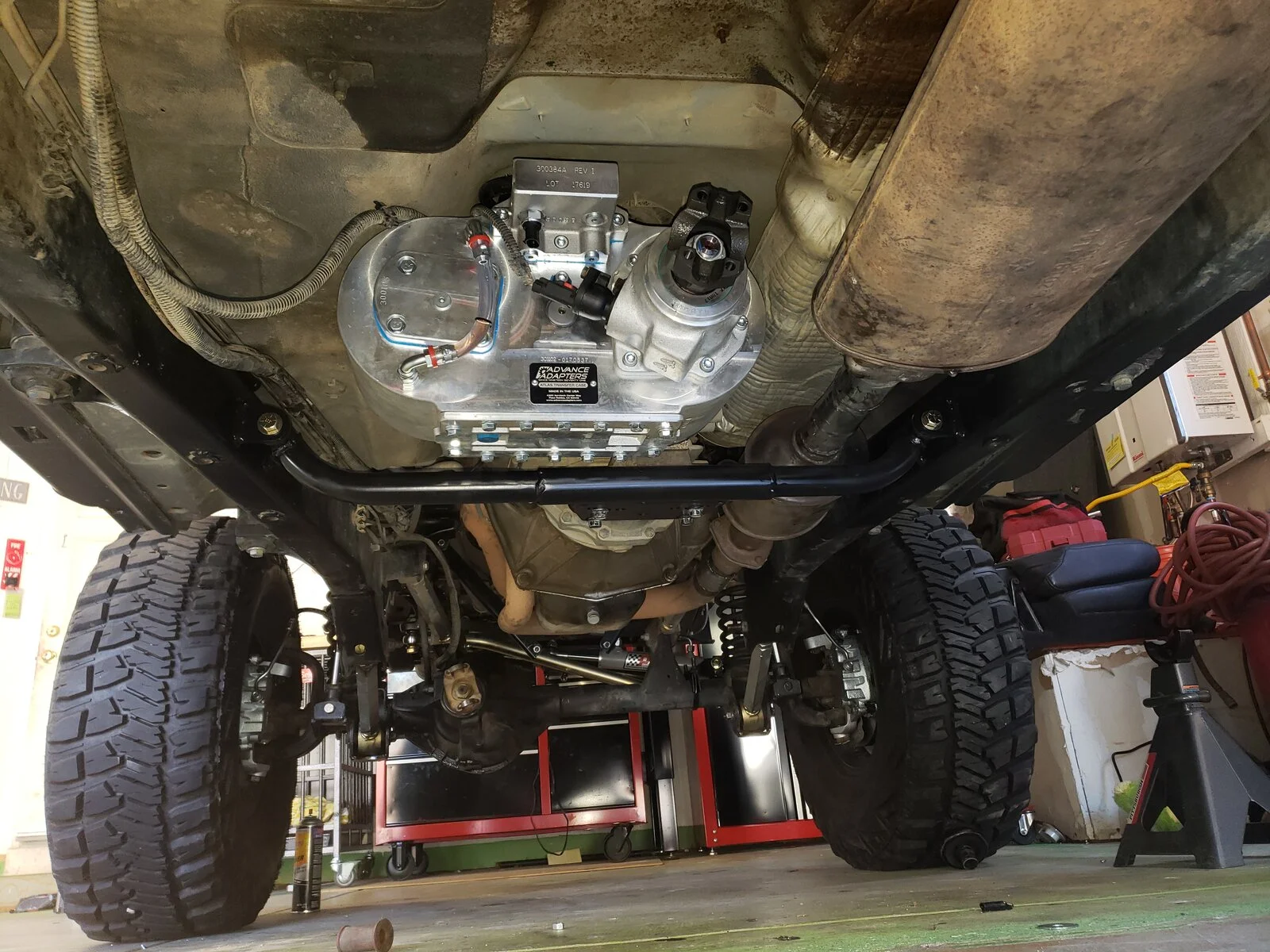

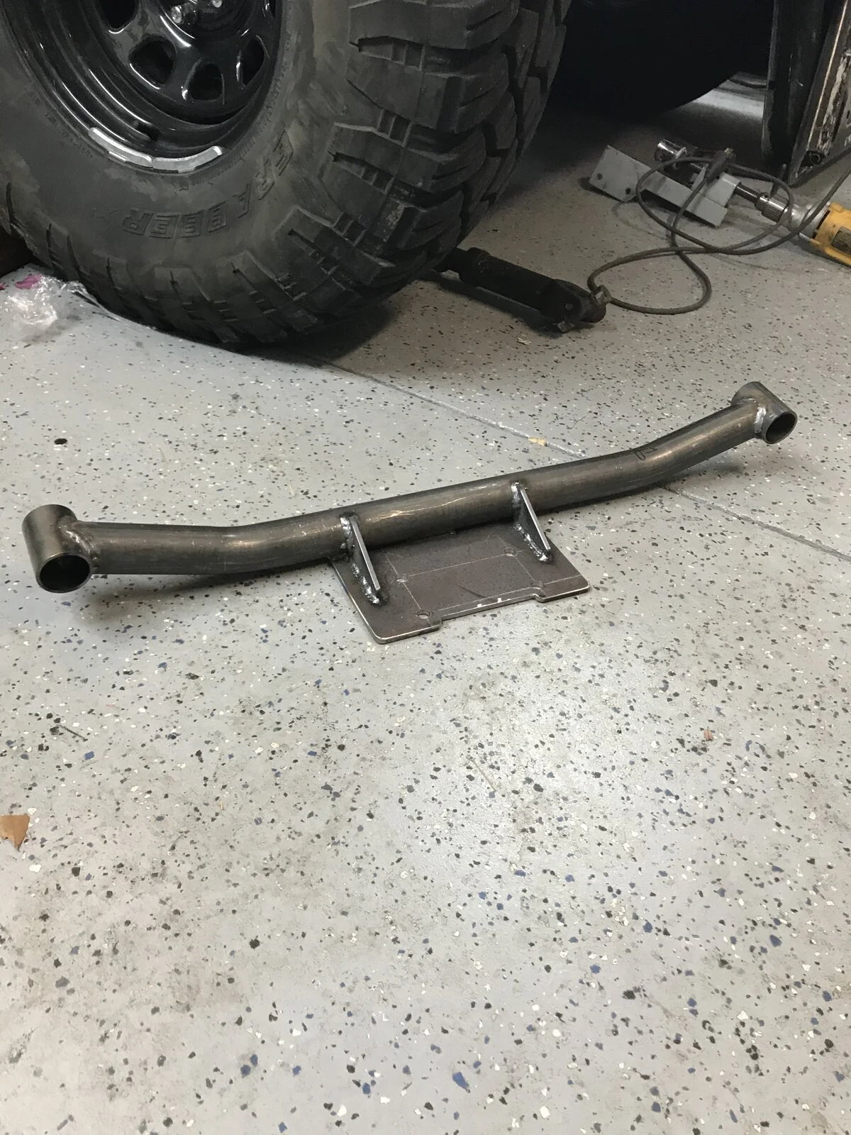

Jeremy,
Something like this for a crossmember and tranny mount. You can get rubber or poly bushings for the ends.
Here is a different setup but you get the idea. The only difference would be that unless we get a kit the DOM is straight since I don't have a bender.
Here is GenRights kit.
https://genright.com/products/universal-transmission-crossmember-kit.html

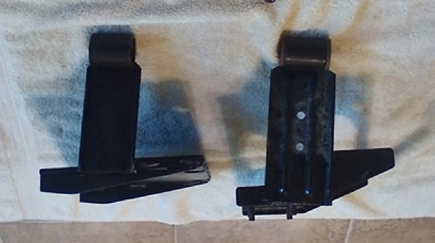

this is the only pic i have of what i did vs a stock bracket. to make room to keep the rubber mount,
basically just 2 plates (1/4 and 3/8) and 2 gussets with a few holes. probably strong enough i didn't even need the gussets. and could weld to anything.

Jeremy,
