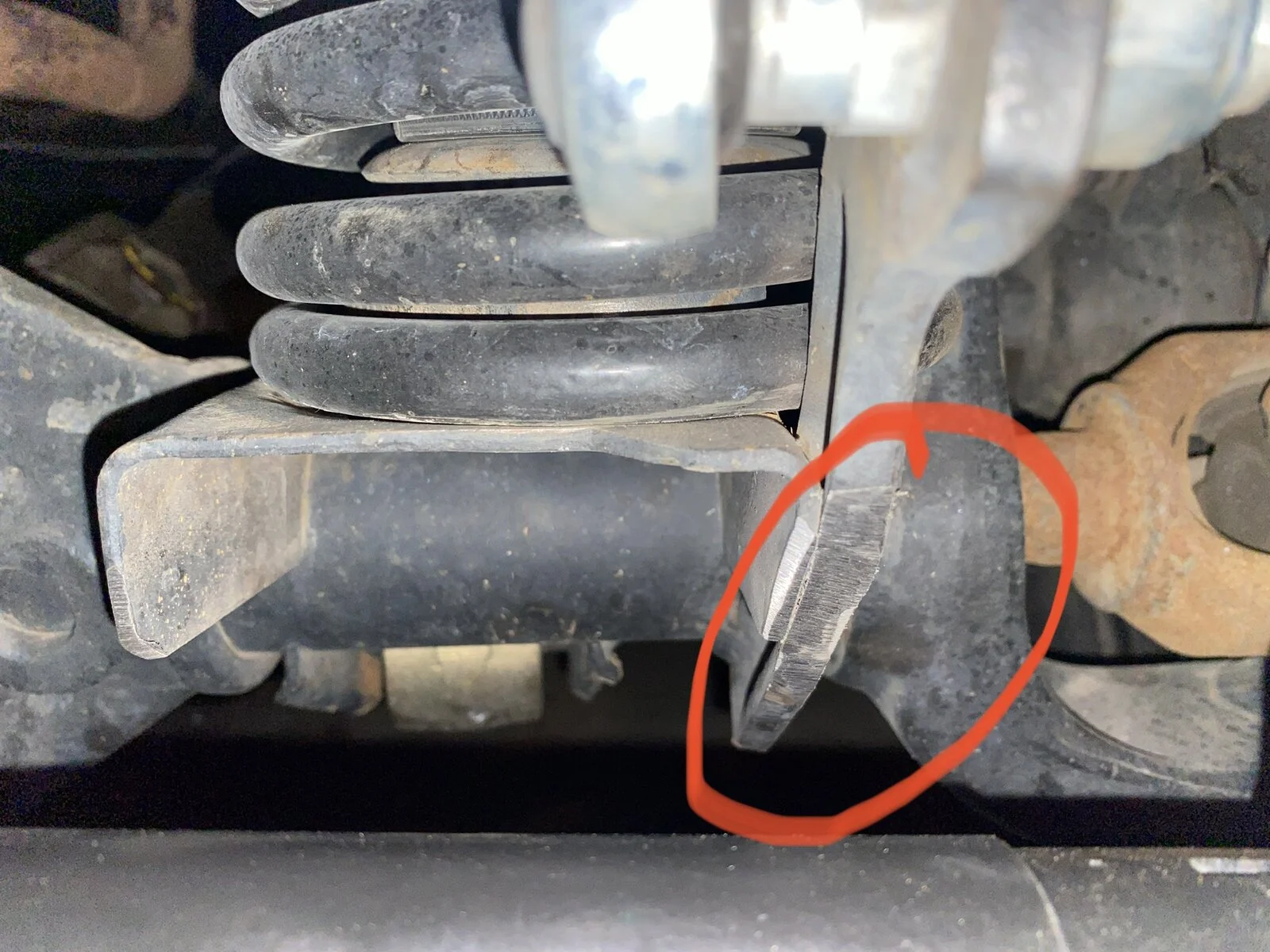

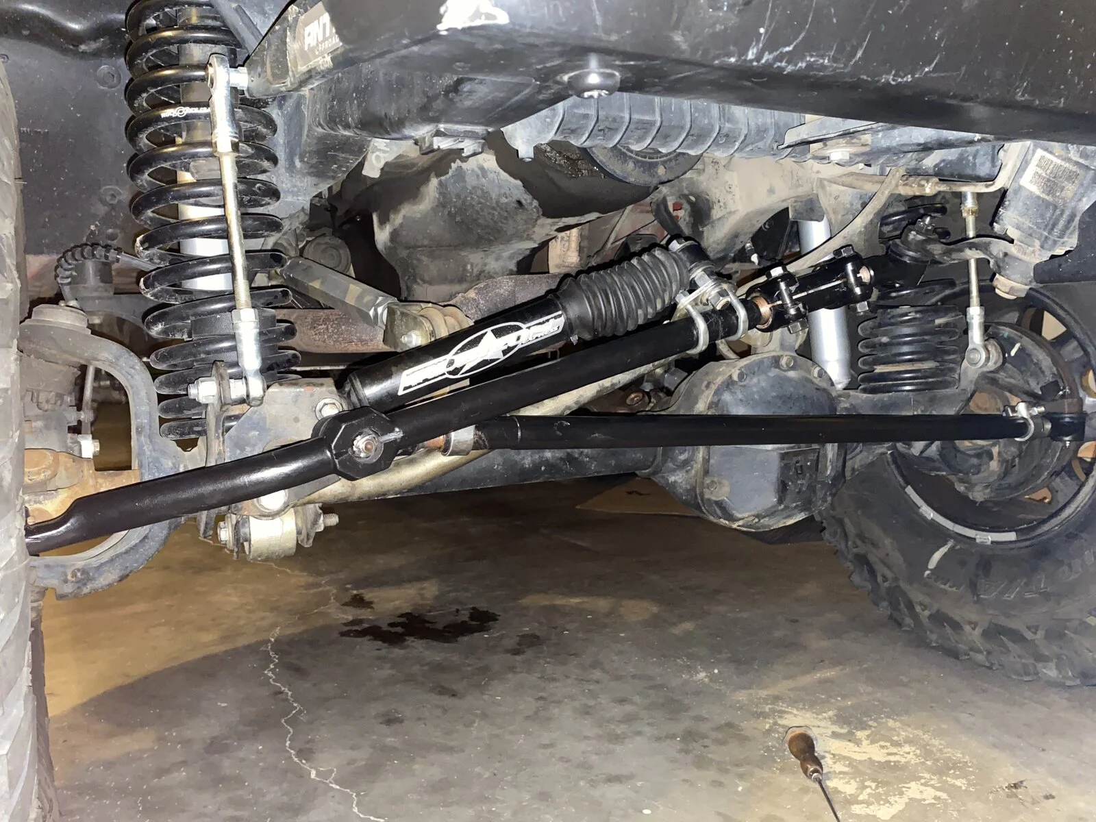

I finally got around to installing the Currie Currectylinc Steering I bought from @sjalkian! I clearanced some around the drivers side perch on the sway bar axle mount. It looked like it would be fine, but better safe than sorry. This thing is beefy. I aligned it and took it for a drive. I honestly can’t believe it! It is so much better. Everything is more stable. It’s 100% better. Sooo glad I bought this!
You can see in the pic below where I clearanced. The ZJ TB coupling has two lock rings. One of them can rub there if the nut end of the bolt sticks out toward it.

Are you thinking a tie rod flip next or run it as is until you join the bent Currie club?
Reactions: JMT
I’m an unofficial member of the BCC since I bought it bent. Now I want to get into the club officially. Then I’ll Tie Rod Flip. That way I get the best of all worlds. 😂
Question: if I do the TR Flip, does it move it enough that it clears and is guaranteed not to hit rocks?
Boy, it’s so much better now! My first thought was “I love how much better the steering is.” My second thought was “PSC Hydro.”
You want a guarantee that it won't hit the rocks? Move to Florida..... Heck I have my steering up higher than your tie rod flip and I still hit rocks so I'd say NO.
There’s definitely no guarantee, so I’d say solve the problems you have (e.g. bend it a few times). But I gained about 2” with the flip.
Anecdotally, @tworley has had way more damage on his tie rod than any anyone I’m aware of and he’s not flipped yet (due to other aftermarket brackets being there). The rest of us have bent them, but usually not severely enough to need to deal with it until after getting home. I don’t know if it being moved up would have protected it in this situation but I think he just was in bad spots though, he came down hard on it last summer when we needed to run back to a tow rig to fix it.
