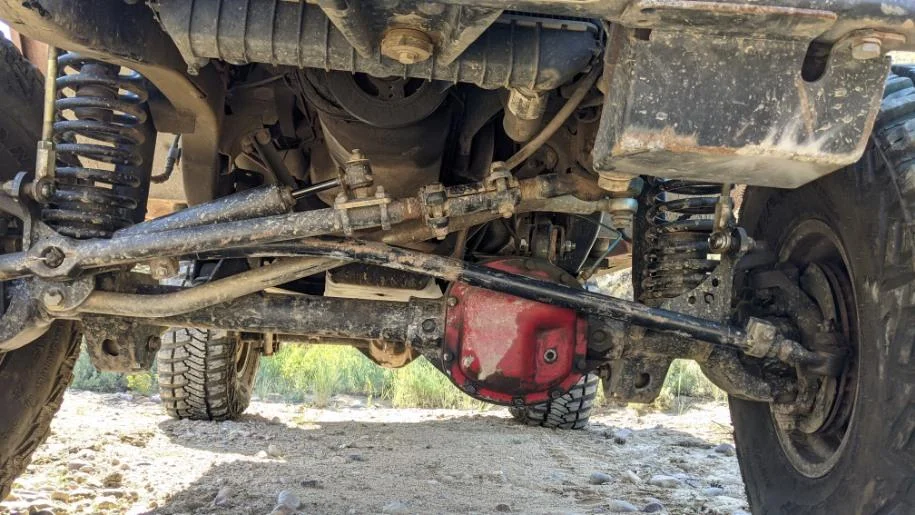

I can’t tell you how much better the steering and whole front end is. I knew the first seam I drove over 10 yards out of my driveway. It only got better on the highway.
I’d also been working on my pinion and shaft angles front and rear. I’ve been trying to work out the harmonic vibes. I’m up to about 75mph until I can detect them. They’re just slight now, almost livable. The fact I have 35’s with the 456 gears may be a contributing factor since the shaft is turning slower.
And a fun pic. I’ve been keeping up my driving. Every few days I hit some trails for 30 minutes to an hour.

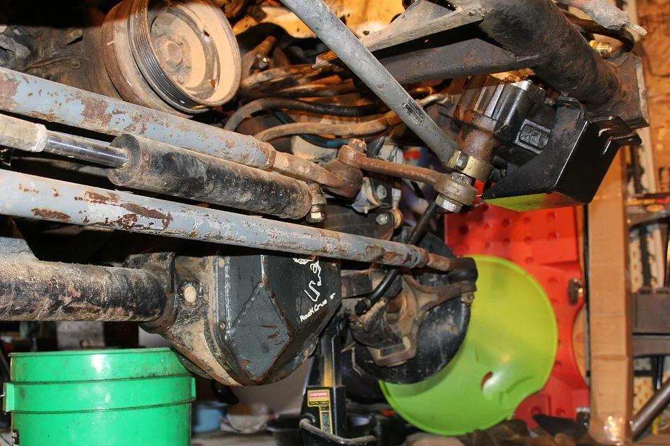

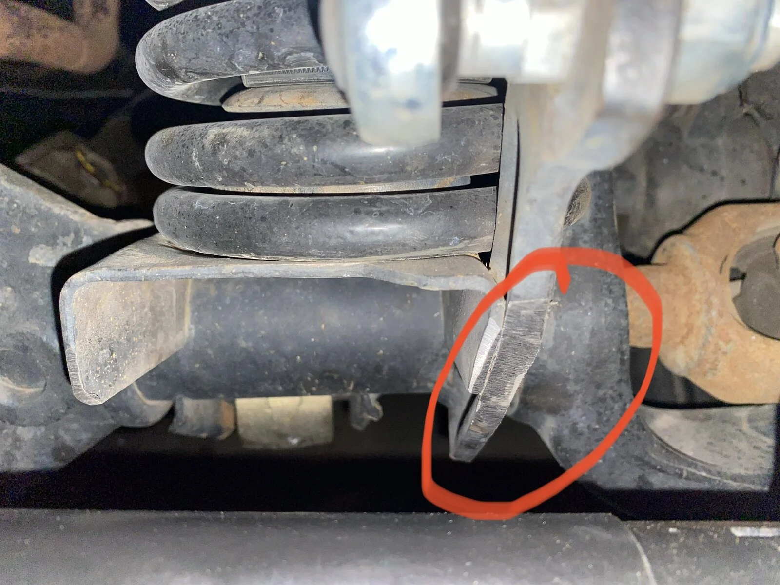

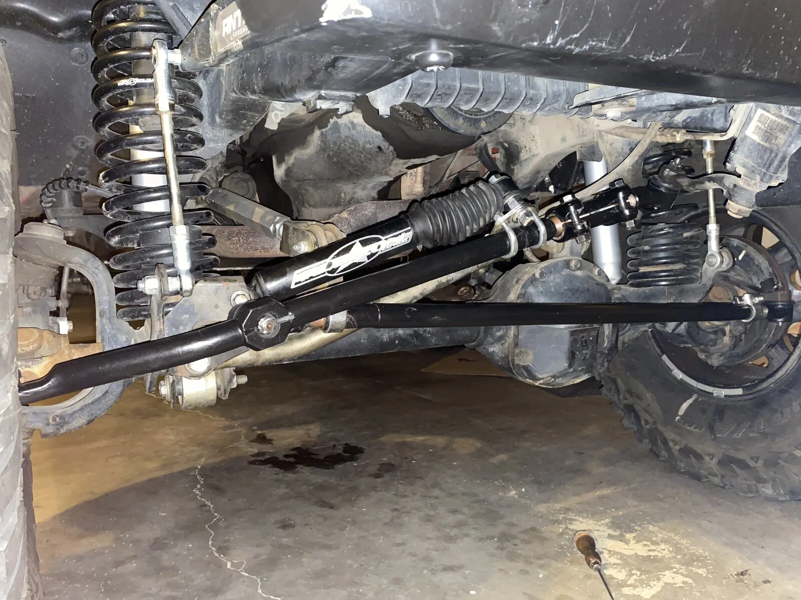

I finally got around to installing the Currie Currectylinc Steering I bought from @sjalkian! I clearanced some around the drivers side perch on the sway bar axle mount. It looked like it would be fine, but better safe than sorry. This thing is beefy. I aligned it and took it for a drive. I honestly can’t believe it! It is so much better. Everything is more stable. It’s 100% better. Sooo glad I bought this!
You can see in the pic below where I clearanced. The ZJ TB coupling has two lock rings. One of them can rub there if the nut end of the bolt sticks out toward it.
So glad it worked out for. Looks awesome on there. Great job making it look new again. You think it’s good now, wait til you get in the rocks. That’s where the beef shines!!

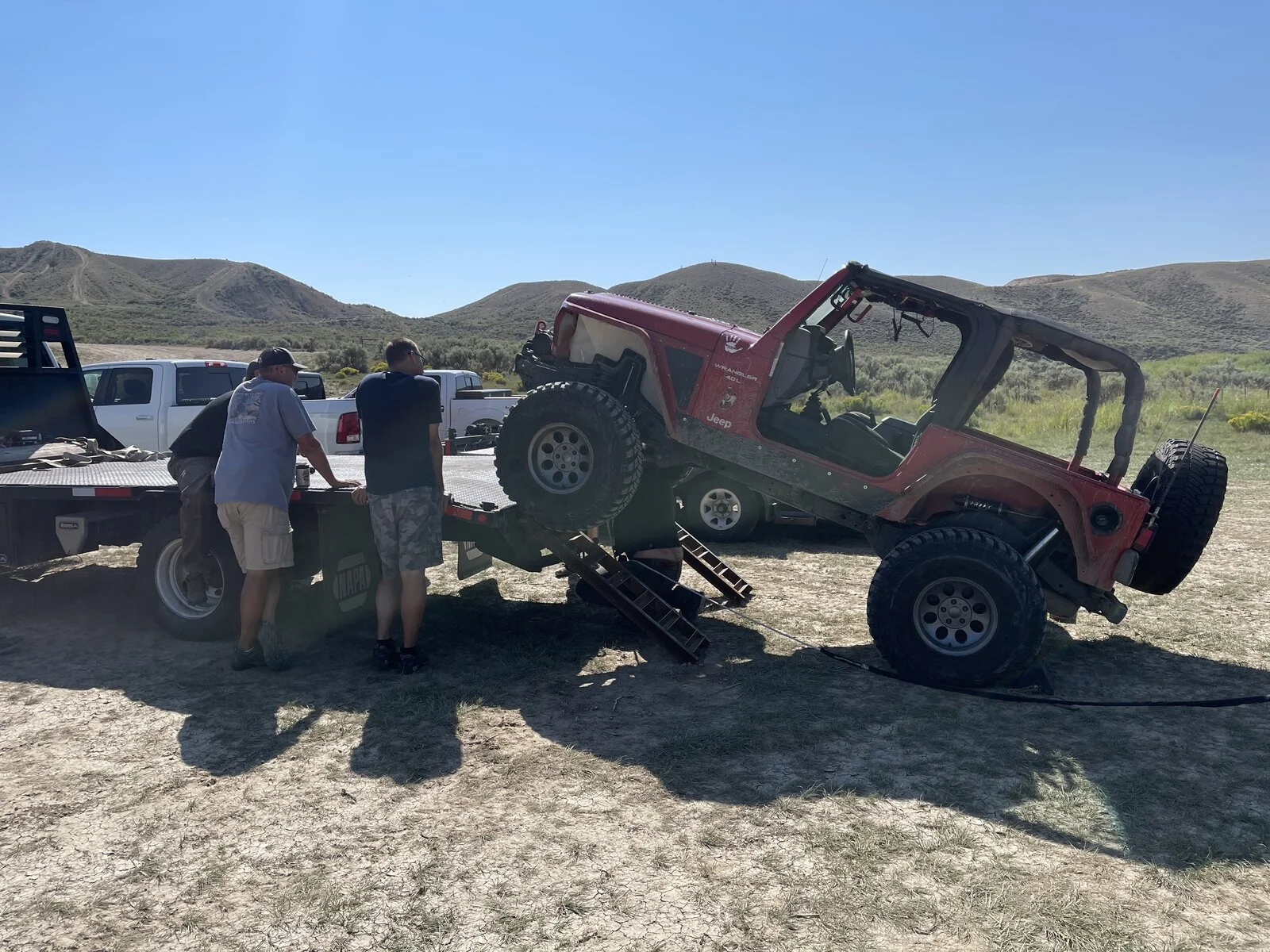

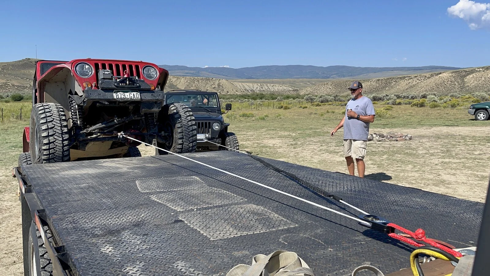

Pretty proud of that one :ROFLMAO: Not even 5 min into the trail.
Mine has been bent a handful of times. A 20-ton shop press makes it pretty easy to fix. I dont think a TRE flip would have made much of a difference here. FWIW--I do have the BMB sway links and the tapered insert fitting on hand, just need to cut off the Artec links. I have a laundry list of things I'd like to get done this winter.
Yeah, that time was just bad luck coming down on a rock in the exact wrong spot. Any TR would have been toast (I guess other than @NashvilleTJ ’s with his setup).

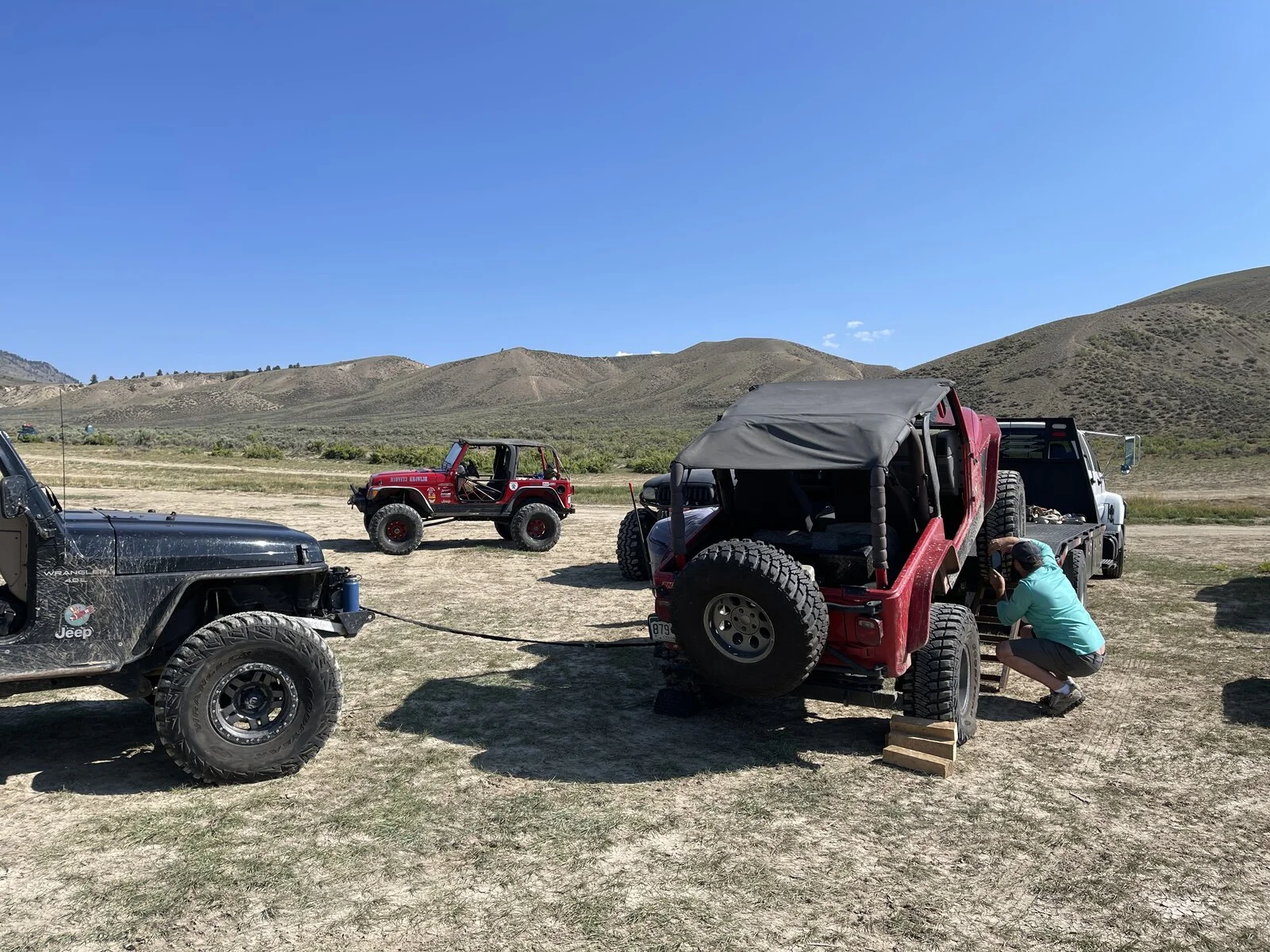

Creative solution! Good way to go when you don't have trees nearby.
I've thrown a snatch strap around a tree and unbent my ZJ tie rod myself a few times. Plenty to use here on the east coast. Once, half way home at a random office parking lot when the bumpsteer became too much.

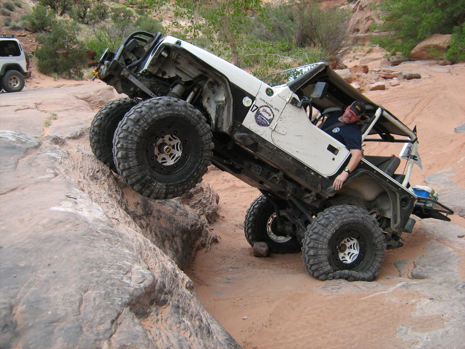

Guy I've wheeled with several times from here in Spokane who went to Moab about the same time we did for Moab 2021. I think he took his TJ and his buggy. This is a video of his buggy on Pritchett. Tell me what you think went wrong.
At least he can say he tried.
Reactions: Irun
Anyone else think he didn't air down or didn't air down enough? When he starts bouncing on his tires it seems quite apparent. Maybe I'm off, so I'm asking for correction if I just aren't seeing things correctly.
Agree, looks like he could have cut his tire pressure in half.
But that likely wouldn't help him for bellying it out like he did on that line.
Reactions: JMT

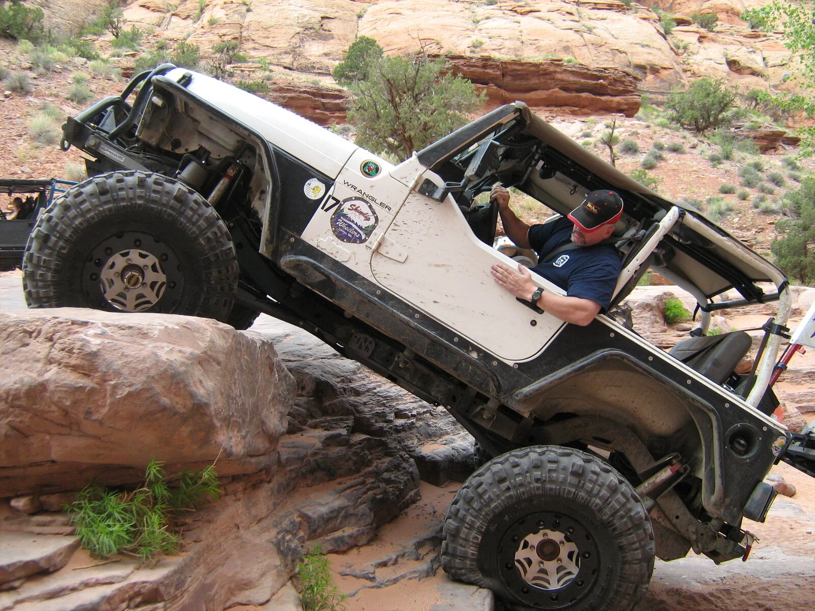

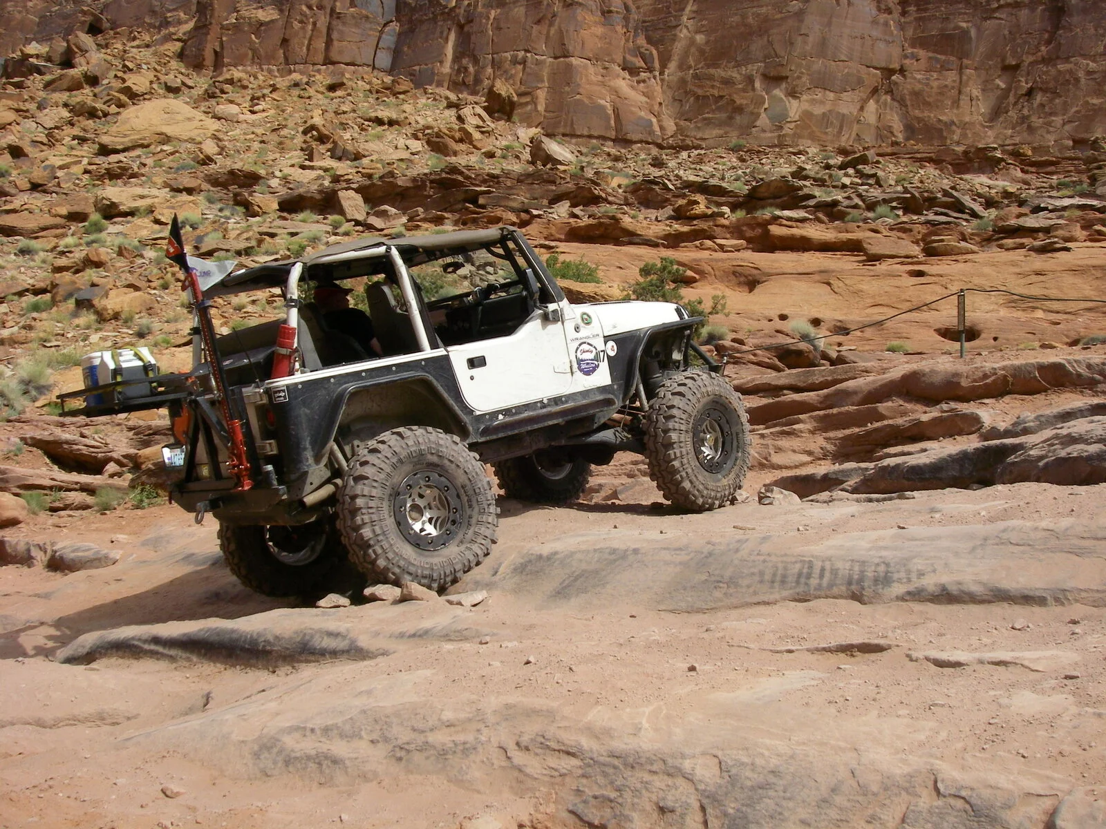

I can tell you since I've ran the TSL SX tires that you seriously have to be under about 6 PSI to get any flex out of the sidewalls.
Now remember that my TJ is a PIG and I was running 3 PSI in my tires at this time. And UNLESS you have dual beadlock wheels you aren't going to be doing that.
This is on Pritchett Canyon BTW.
Damn lookie here I have TWO legs...
Again 3 PSI
I think I'd taken them back up to 5 or 6 PSI here. And I weigh 5K lbs. Where I'd guess that this buggy is max 3K lbs?
