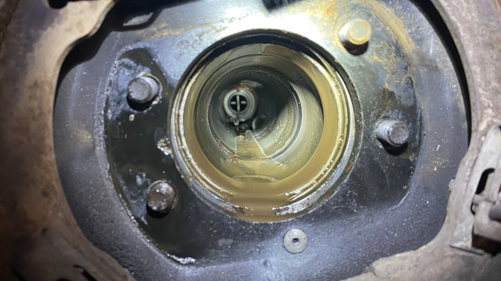

It looks like chunks in the tube and shavings around the race when you zoom in.
Yeah, that’s rust from the upper part of the axle tube right behind where the exhaust dumps. That area gets hot and cool and has rusted due to the stupid exhaust. Chunks of rust fell into the tub and spoiled the gear lube in the shaft. The gear oil was replaced about 2 weeks ago and the tube was cleaned about 1 week ago. The bearing on the shaft was actually still good, but it’s a situation that needs to be corrected.

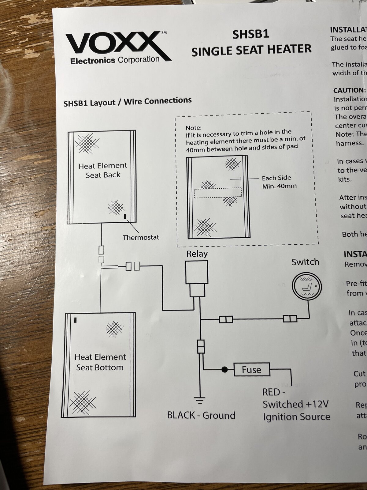

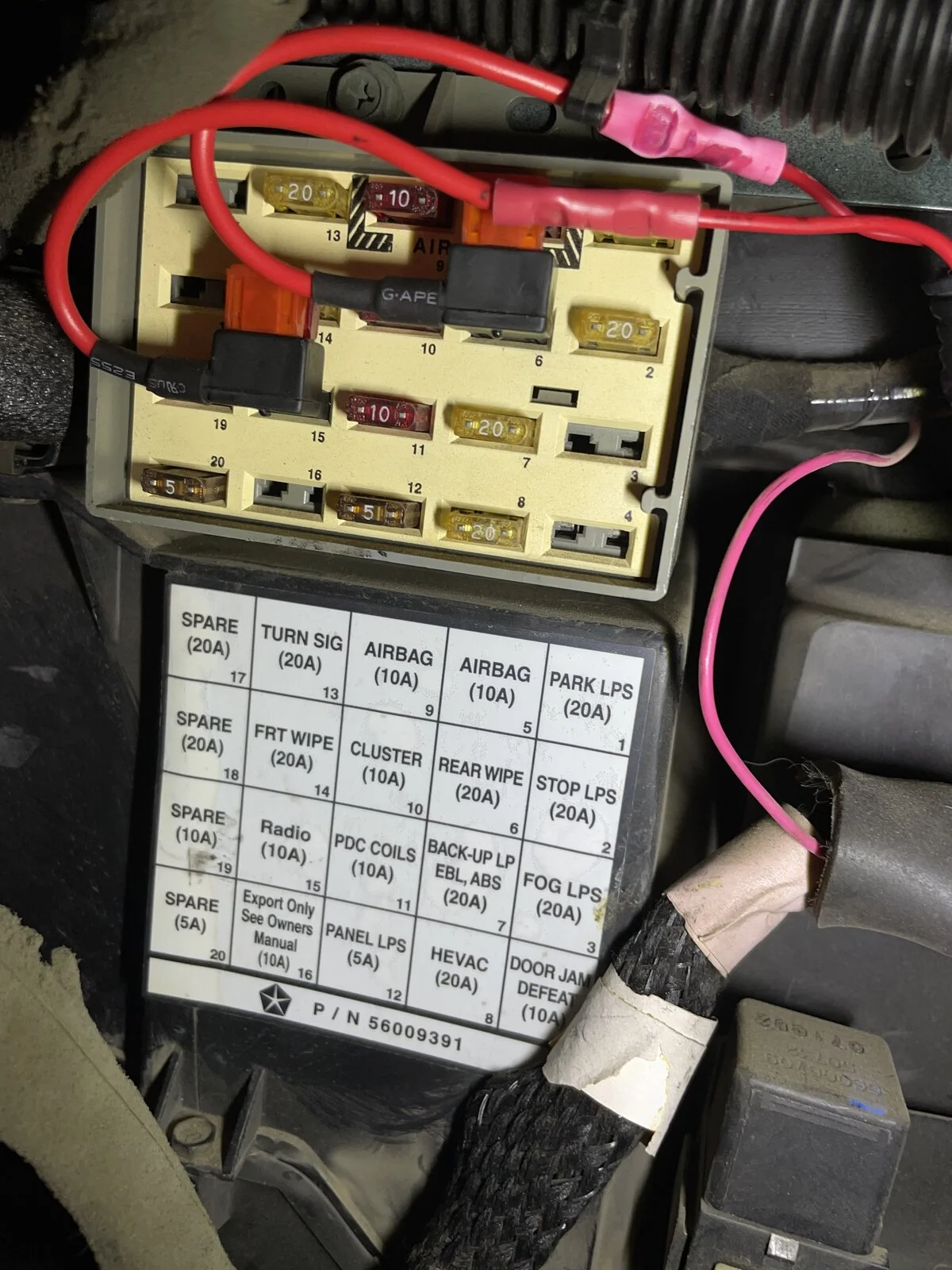

I hate electrical. I hope this is easy enough, but I gotta find a fuse to tap into that’s only when I turn the key on, and my instructions said “ground the brown wire” and I can’t find a brown wire. 😂 I also am wondering if I should put them under the seat covers or go under the actual stock fabric. I will need a few days to do this at the same time I do some sound deadening and BedRug. It will change the inside of the Jeep for sure.

Yeah, auto electrical work isn’t my favorite either. I used those tap-a-circuit things in the fuse box behind the glove box;
I’m sure your 05‘s fuse box is different than in my 97, though. The fuses provided with my seat heater are 7.5 amp for each so a switched 15 amp circuit should cover two seats. I used the 20 amp circuit for the rear wiper (which I don’t have since no hard top). Here’s the wiring diagram with mine:

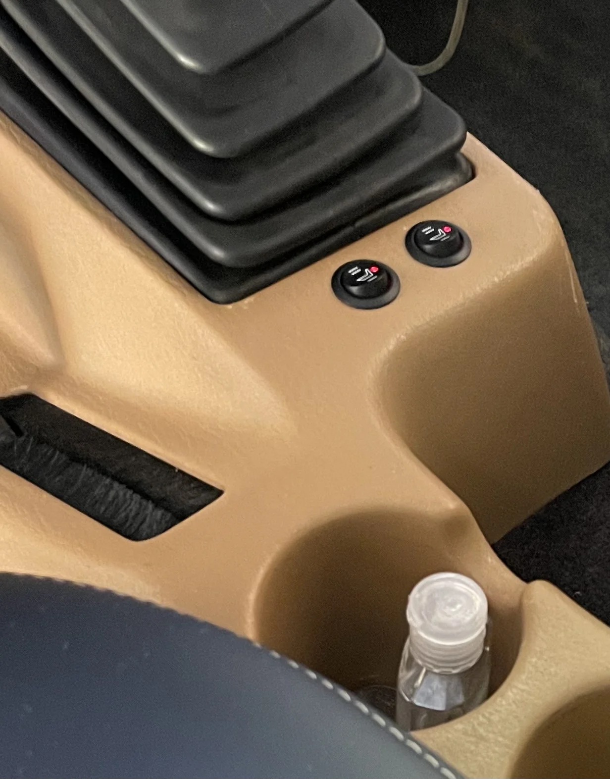

The switches worked well in the center console (for ease of wiring and use):

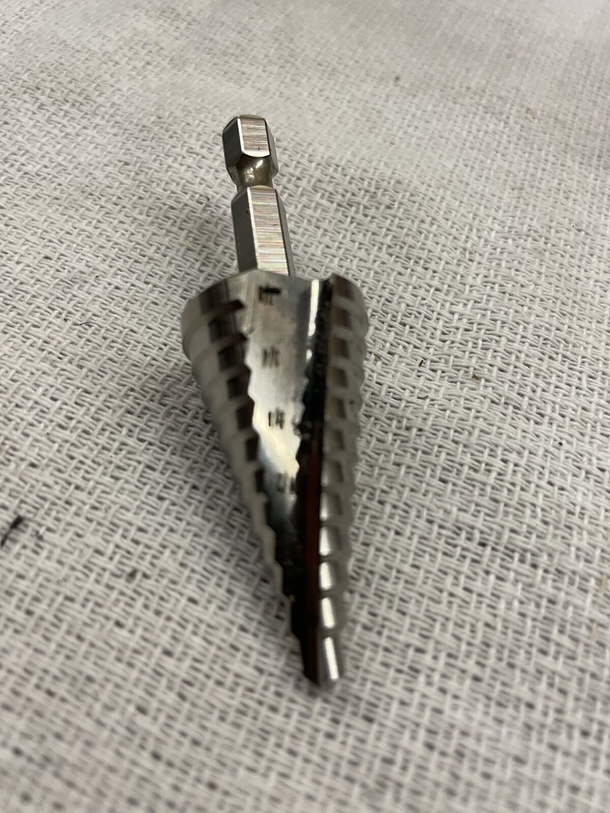

One of these stepped drill bits is perfect for making holes in the plastic:
One of these stepped drill bits is perfect for making holes in the plastic:View attachment 298607
Very clean and very helpful! I have a hardtop and all the parts for the rear wiper, but I’ve never put all the parts together. I’m familiar with that fuse board behind the glove box. I will look over my diagram and see what I can tap into because I really like how clean the tap a circuit solution is. I also have a stepped drill bit, so I can do that for the two switches. Very helpful wiring diagram too. Thank you so much for taking the time to post all this. Merry Christmas. It’s still the 25th here!
ya i missed this ............1 is prefect shiny and clean........ and this 1 is contaminated. not all rusty either, some of that is shiny new shards.

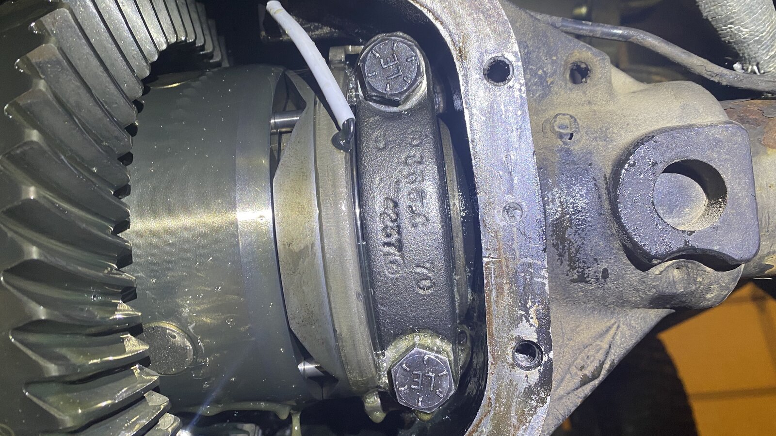

so SYE, driveshaft, pinion all verified ..................what if that carrier bearing is whacked and under load it's givin to some shear and that's our bitch? is this possible?
I can check that bearing out.

again just a guess but could coincide with the rotational noise. as the pinion comes around under load it's pushin the ring and the carrier bearing gives it pushes offline, when the pinion tooth clears the stress relieves and you get that cluck when it comes back in.

I got into the differential. I took some pics of everything and you can see them down below. Also, take careful note of the shards are found in the differential. These were mostly on the driver side where the carrier bearing was. I can’t find anything wrong with the carrier bearings or the ring or pinion teeth. There’s a slight rough spot on top of one of the pinion teeth. I’ve taken a picture of it. I can feel it when I rub my nail across it. The pinion bearing seems super tight. So, I still don’t know what’s going on if anything back here. Hoping some of your good eyes can see something.
Races look fine.

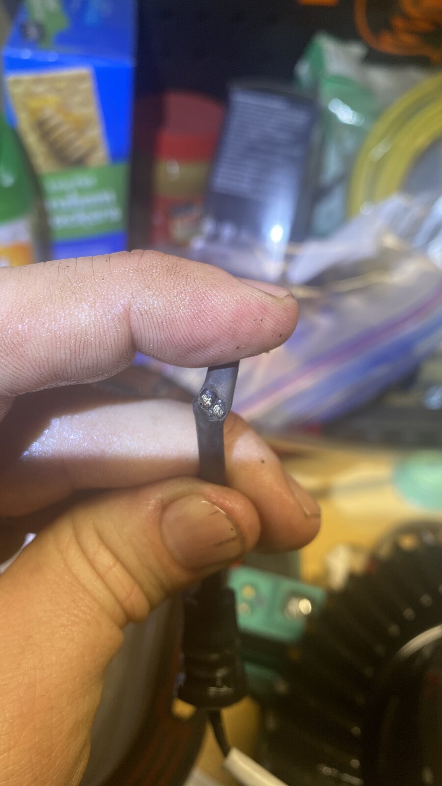

The electrical sheath was compromised on both wires. Could this have something to do with it?
