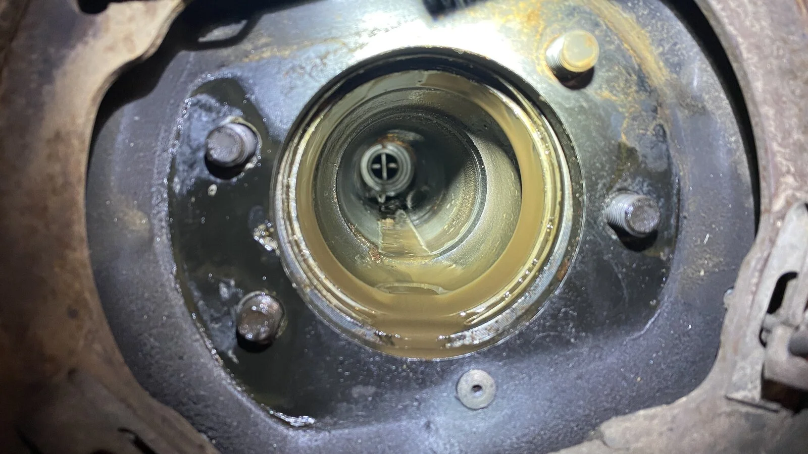

- Changed rear axle shafts and bearings. Some rust in the passenger axle tube due to the exhaust dump above the axle. Something to correct later. Cleaned up.
