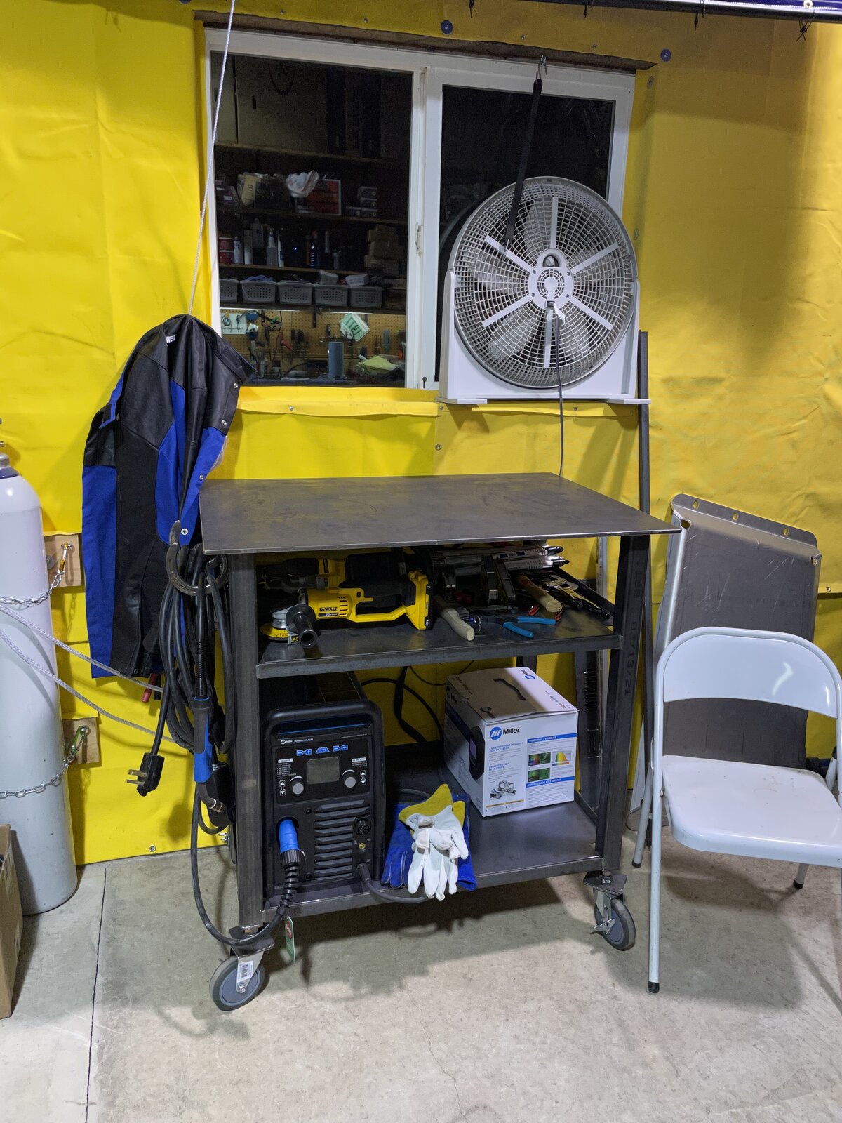

I made this simple table as my first project. Space is an issue in my garage too. In addition to being a table to weld on, it gives me space to store all the new welding stuff and what I didn’t expect is how much I use the extra flat surface when I’m not welding. I also put casters on it so I can move around easily (it’s heavy).
Nice setup. I also like the not so obvious tank retention device and the UCF skid hiding behind the chair. 👍🏻

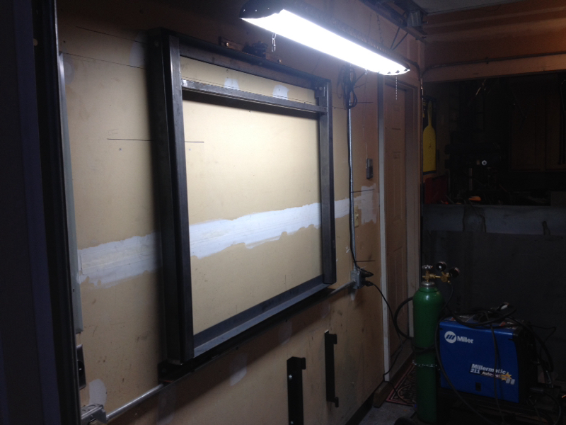

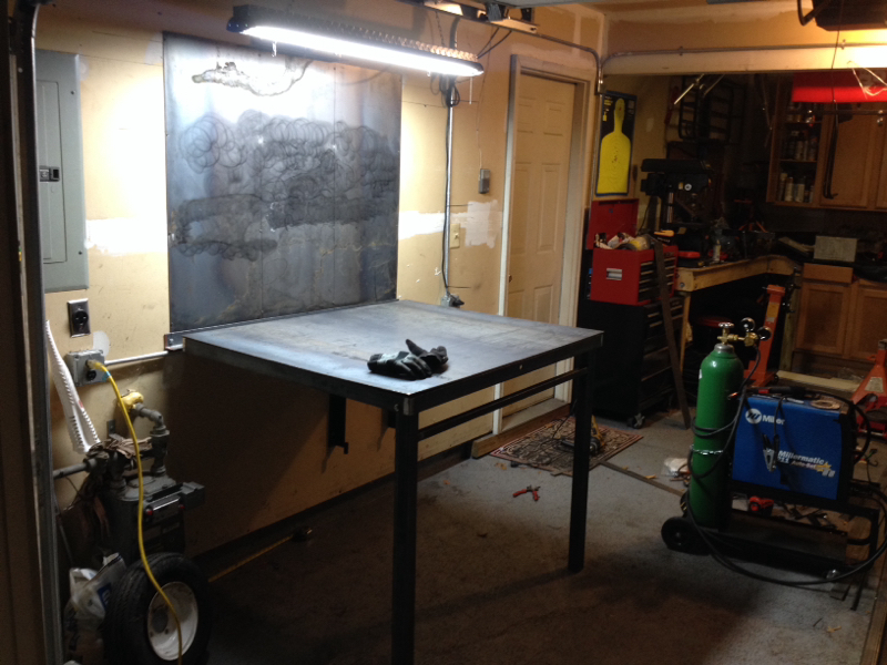

in my old garage i had a plate mounted on hinges to the wall, with a pair of drop down legs, when not needed it would fold up against the wall.

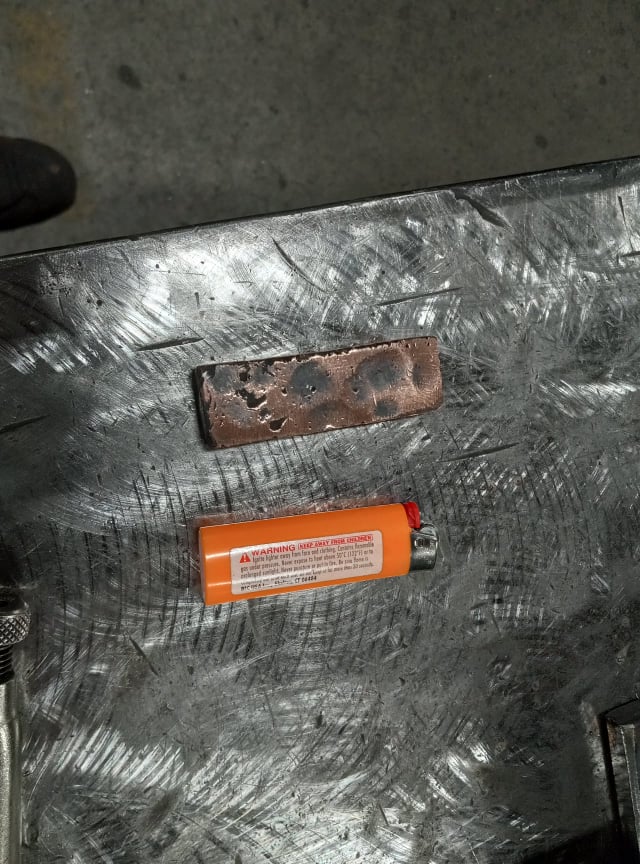

keep your eyes open for a chunk of copper, i have 1 about the size of a bic lighter it's great for plug filling old holes or joining sloppy cut corners. weld doesn't stick to it well.

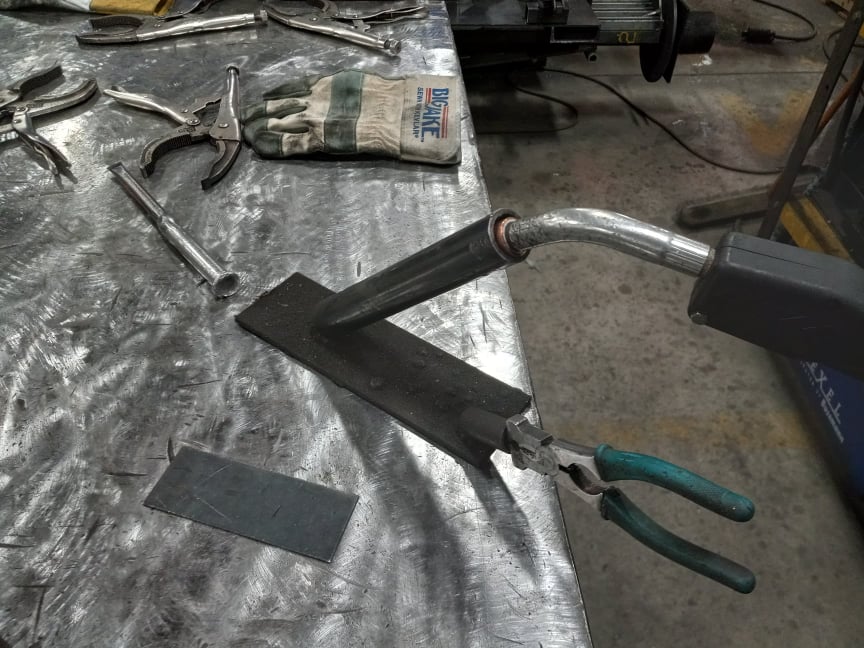

find a couple pieces of old pipe and weld them to a small scrap plate, you can tack or clamp it close to your work area to hold your gun and welpers.
find a couple pieces of old pipe and weld them to a small scrap plate, you can tack or camp it close to your work area to hold your gun and welpers.

EDIT: The copper is a good idea. @Alex01 suggested the same for filling holes.

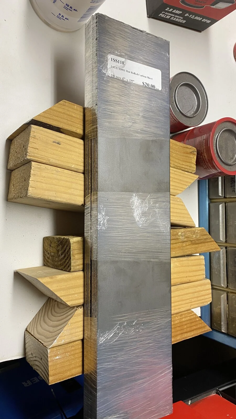

$175 for 1/4” plate that’s 2’x3’
$136 for 3/16” plate that’s 2’x3’
At those prices I decided to contemplate between a plate for bench top welding or a welding cart. I’ve already scoured FB Marketplace.

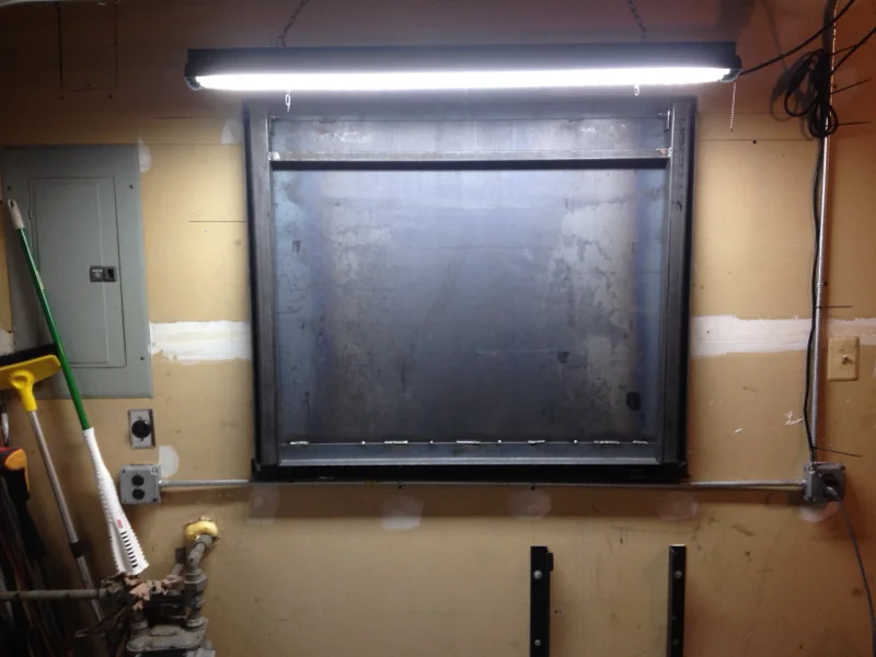

Go to page 10 of this thread and see the bench he built.
That’s a great way to do it, and you can build it where it’s the right height for your arms, which is 6-8” below your elbows.
It folds down
And back up into the wall for storage.
I checked it out. Really great idea. Super nice and smart way to do it since you can customize the height to your needs, which from what I read is 6-8” below your elbows.
dam, sorry. i get this crap for free, i know steel has gone up in cost but thats kinda crazy.
when you inquire about buying steel from a steel vendor, always inquire about "drops" or leftovers from others cuts, usually they can be had cheaper, since they are often odd sized remnants and your not askin for it to be cut or sheared to any particular size.

I have a few metal shop that have cut off racks you can buy out of by the pound, one other one he just looks at it and say a price.
3/16" steel is about 7-1/2# per sq. ft., 1/4" is about 10#. We (the shop I work at) pay about $1.20 per pound, but we buy 100K per week. If you can get a suitable size rem for around $2/#, I'd jump on it. If they have to cut it to your spec, there's likely going to be a minimum labor charge added.
Beg forgiveness for ignorance, but what is rem steel?
For 3/16" steel
7.5lbs x 6 sq ft = 45 lbs x $2/lb = $90
Geez, I checked Alcobra. $27.75/sq ft for remnant 3/16” plate. Lots of steel distributors here but none answering the phone and it’s before 5pm. 🤷‍♂️ I’m going to try CdA metals in Spokane again tomorrow. They have a good rep.
