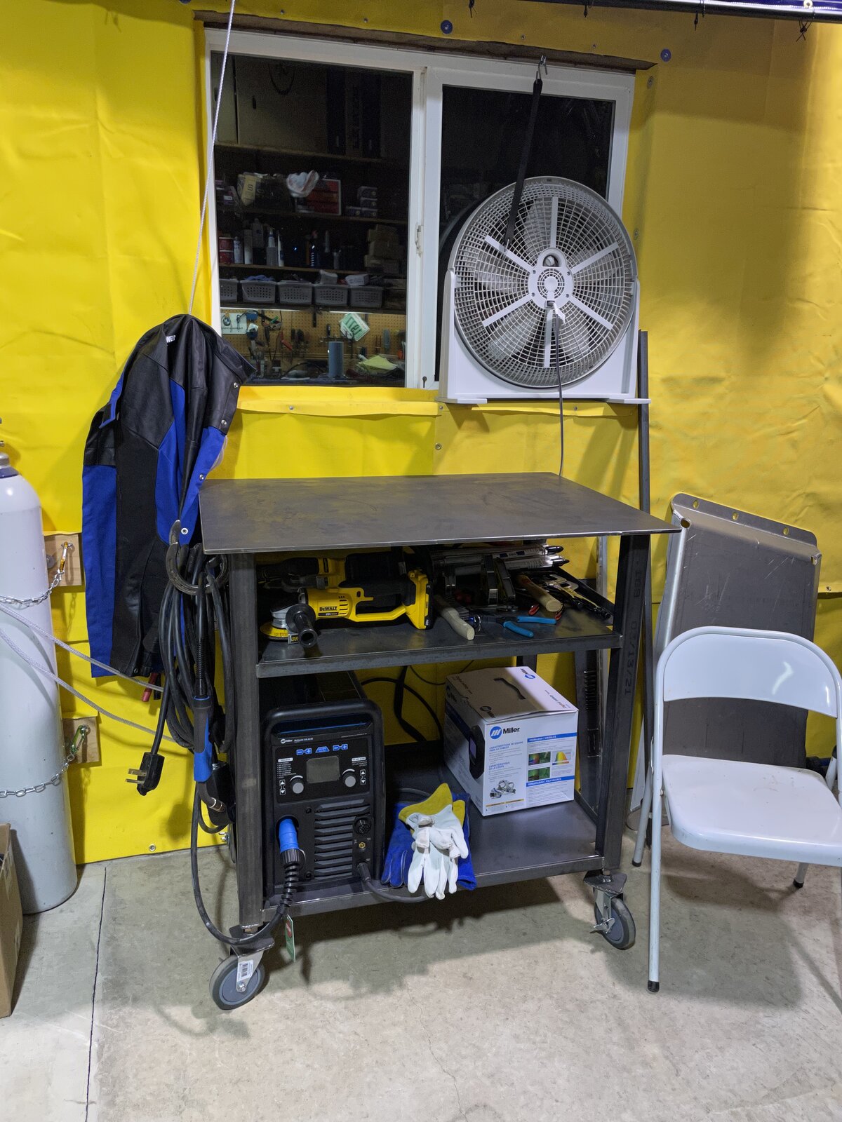

I made this simple table as my first project. Space is an issue in my garage too. In addition to being a table to weld on, it gives me space to store all the new welding stuff and what I didn’t expect is how much I use the extra flat surface when I’m not welding. I also put casters on it so I can move around easily (it’s heavy).
Reactions: JMT and Wildman
