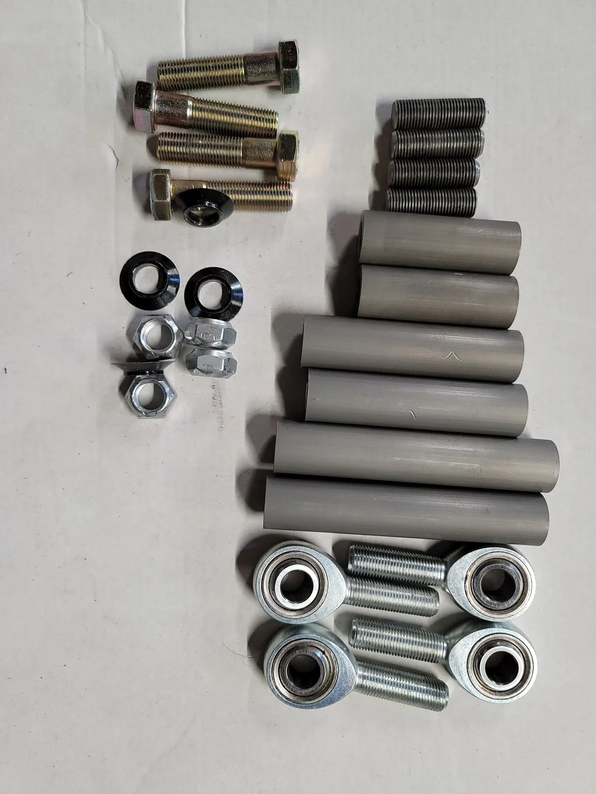

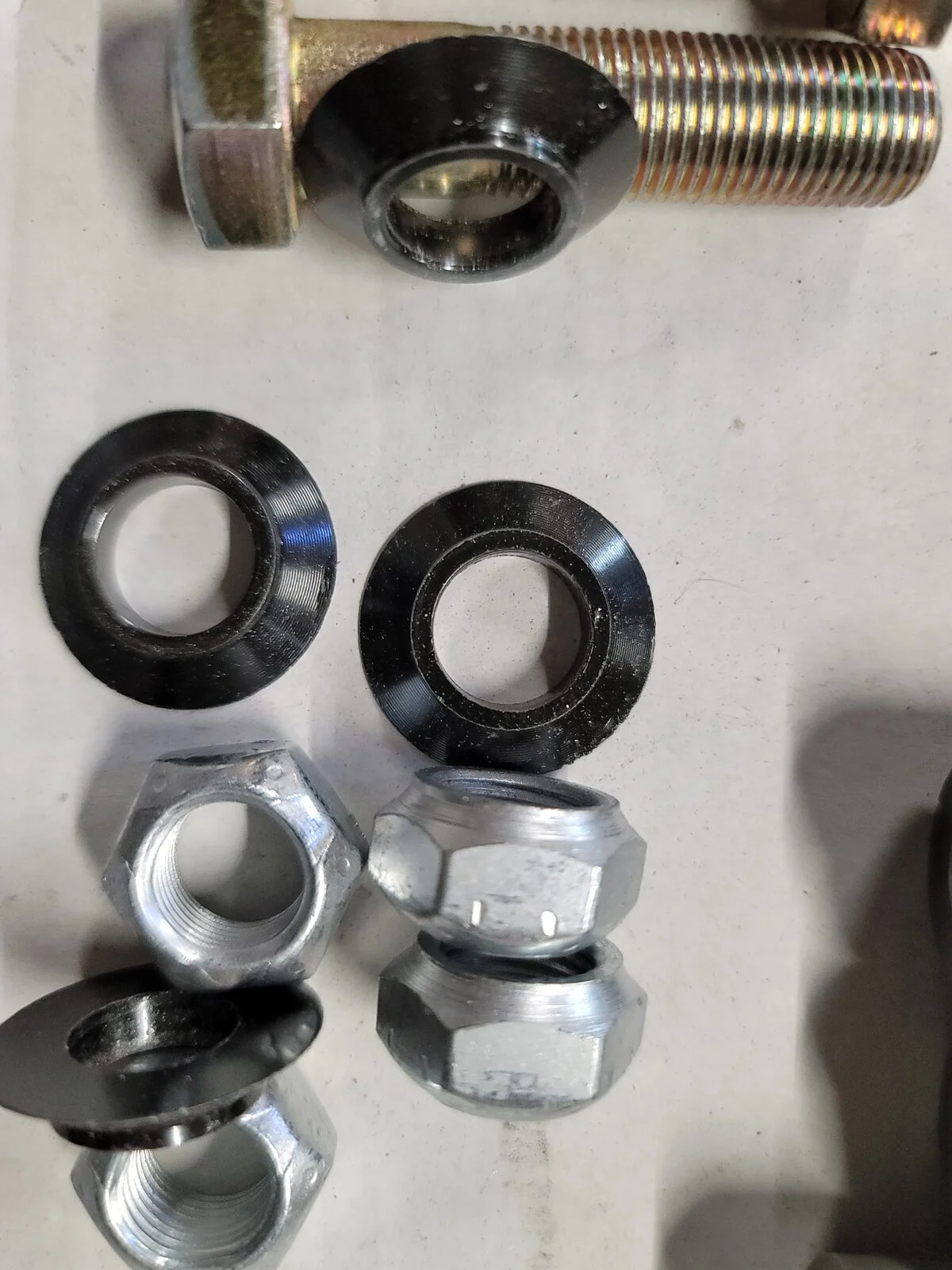

Here's the nuts and bolts and spacers for the SwayLoc. I'm guessing that you're talking about the black spacers? And the nuts have a shoulder on the backside.

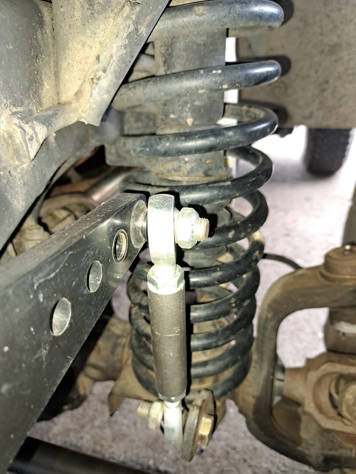

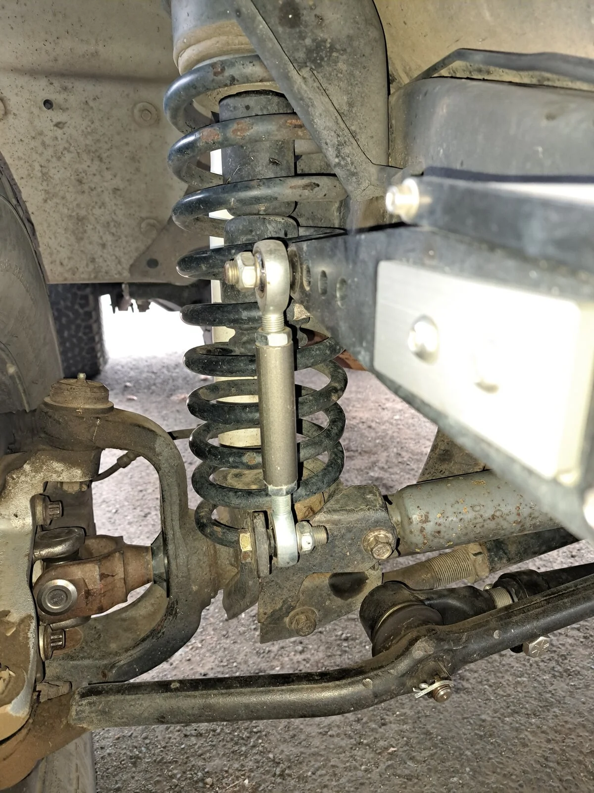

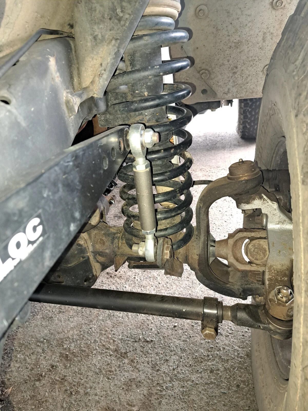

I know you already have this fixed but you'd said that you wished you'd taken a picture of them.
Edit: My kit is about 2 years old so this may not be the same as what others received.
