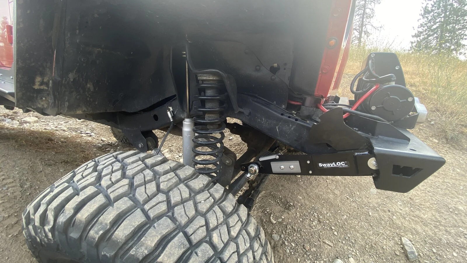

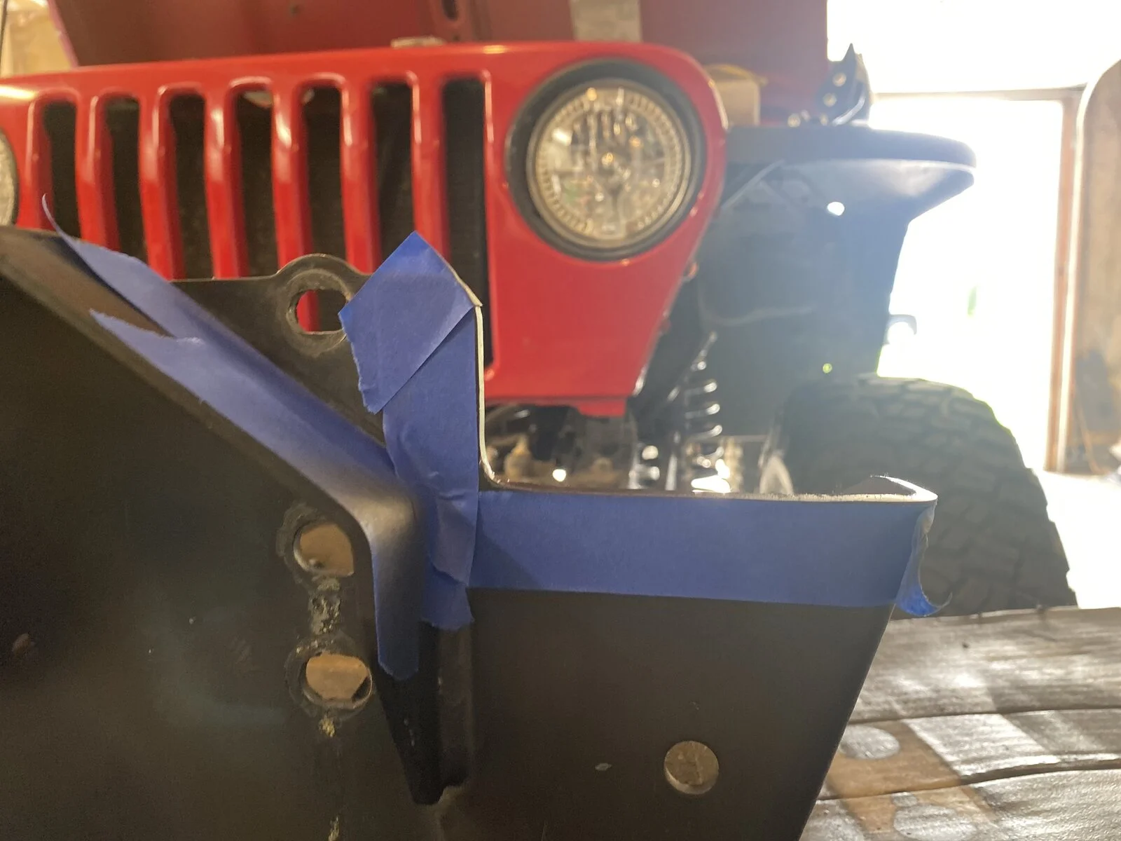

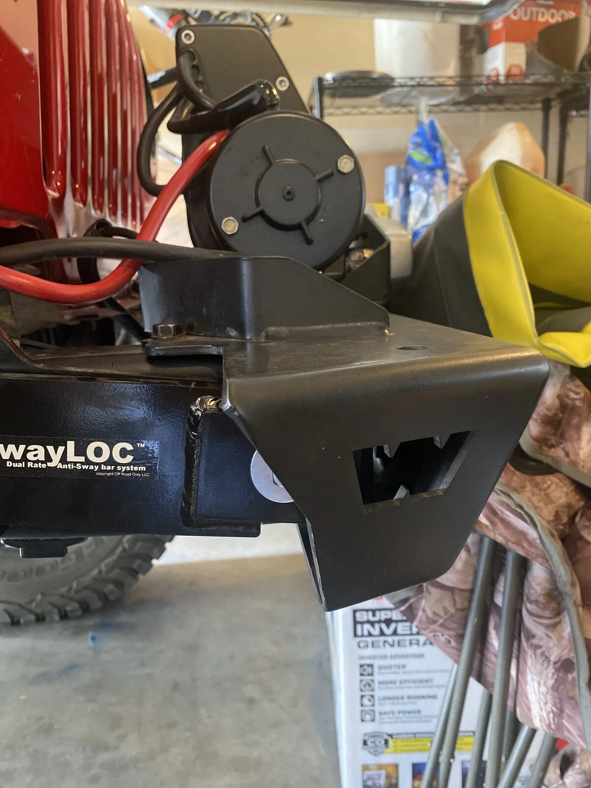

SwayLoc hits the bumper when the tire stuffs on each side. I suspected that would happen. Either would work, but would you cut a notch out of the bumper at that spot, or just trim a half inch off all the way to the corner so it looked natural?
Reactions: DrDmoney
Can you shorten the links till there’s no contact? If yes what will it do at full droop? If shortening links isn’t possible, I would probably trim the full length to look natural.
Reactions: NashvilleTJ
I was at the next to shortest link. I trimmed 1/2” inch off, painted it, and put the bumper back on. Can't even tell a difference, but now I don't have to worry about the SwayLoc interfering with the bumper and causing loss of uptravel. 😀

@DrDmoney. This is the SwayLoc at full droop (shock fully extended). I have it on the 2nd hole from the front.
