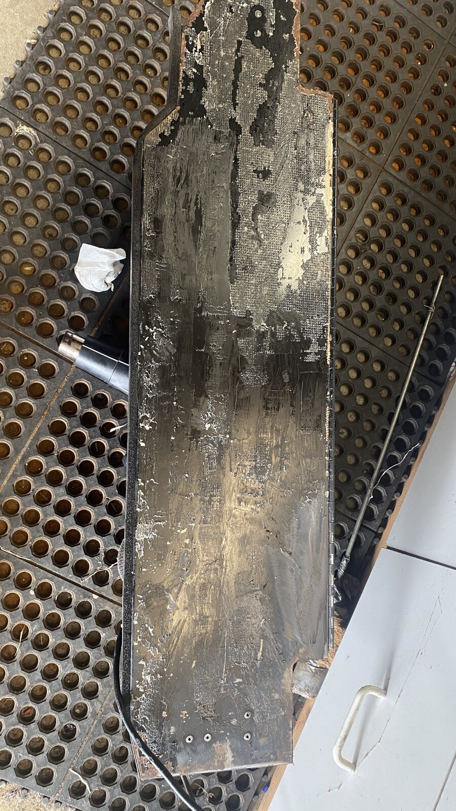

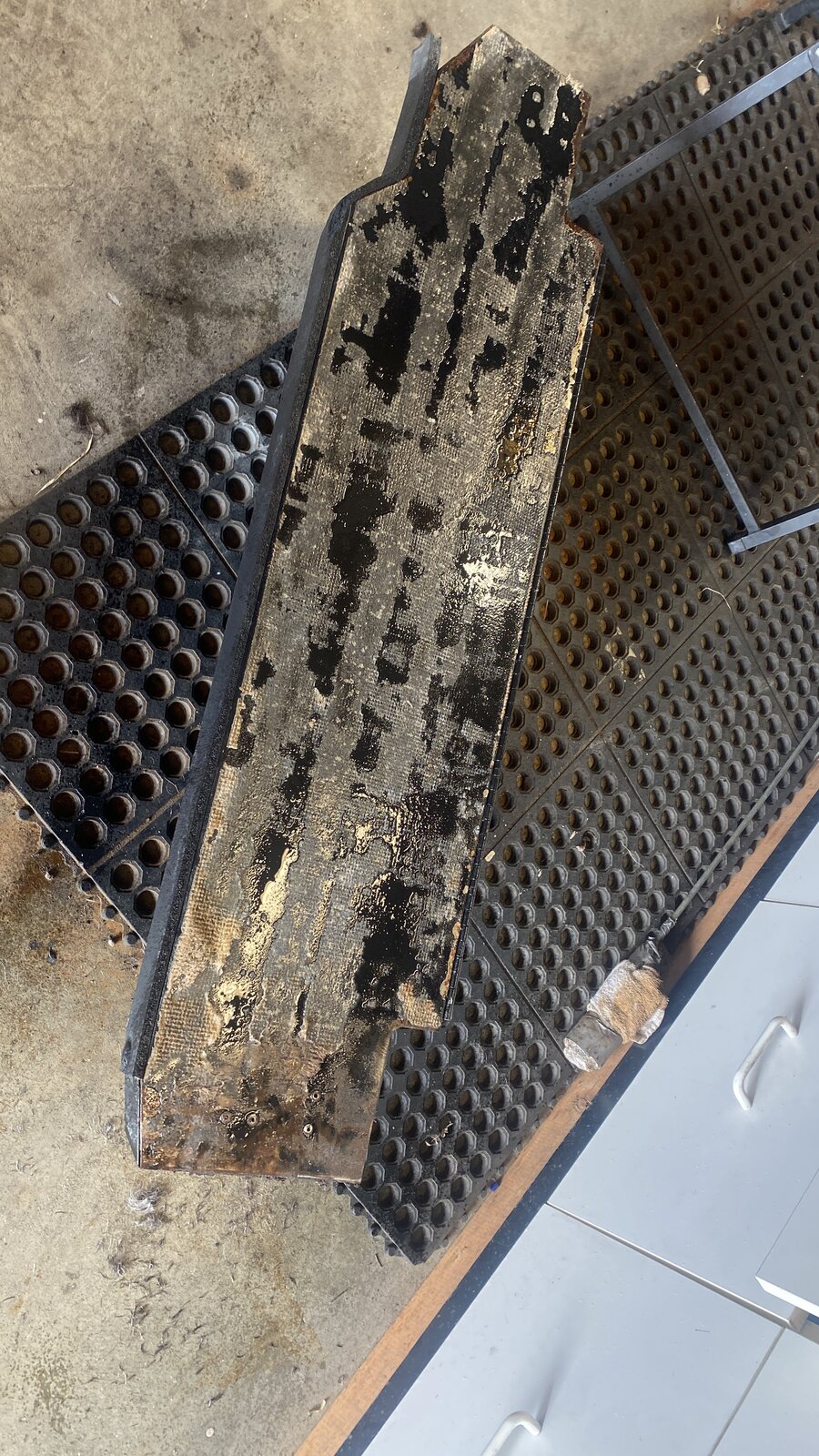

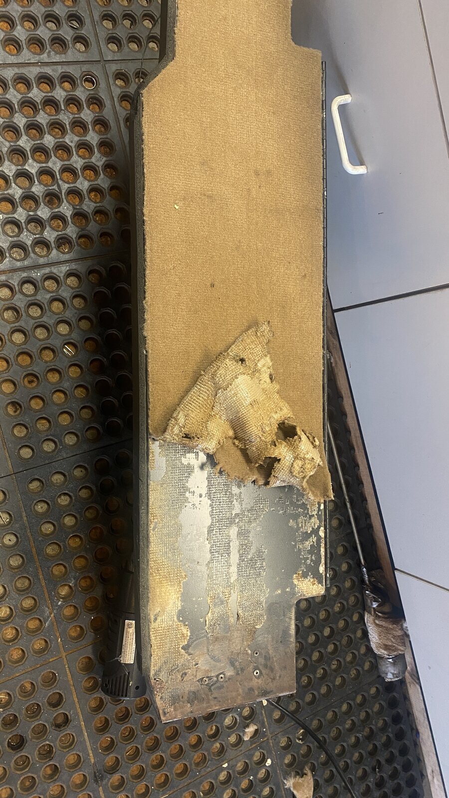

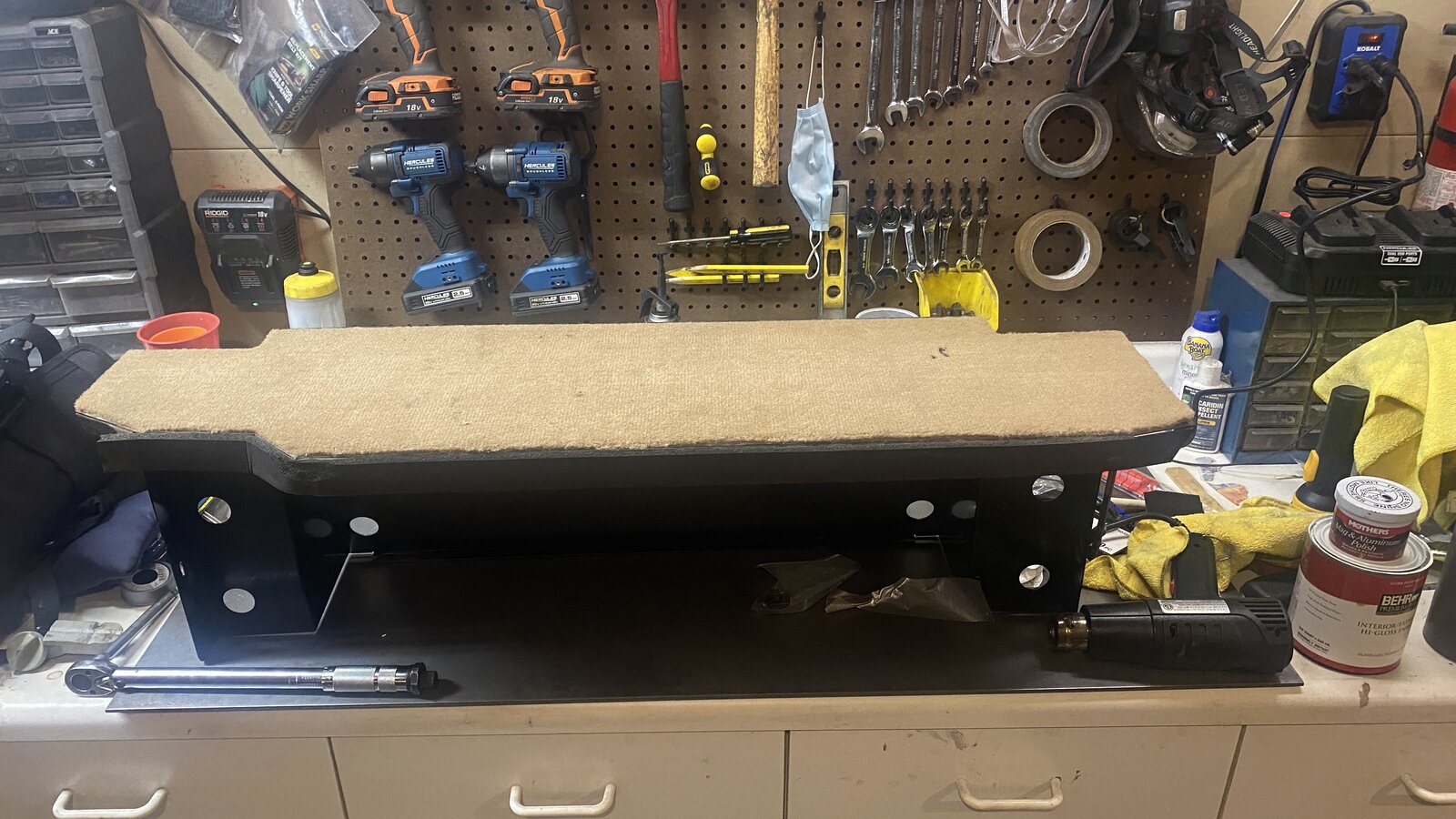

I picked up the InstaTrunk for $50 in Rathdrum. The guy had put khaki carpet on top. The adhesive is literally the worst thing to remove ever. I’ve tried heat, goo gone, Wd-40, razor blades, et al. Best so far is goo gone overnight followed by heat gun and razor. I’m getting there.
If that piece is metal (hard to tell if it is from pics), why not just hit it with a wire wheel?

I did try an angle grinder with a flap disc. It was a mistake. It looked like spun taffy. Nuts.
can't use a grinder on plastic...it gets very melty, very quickly. Don't use acetone either. WD-40, believe it or not, works pretty good to remove adhesive residue. Rubbing Alcohol works too. I've had Goof Off melt certain plastics. Also, rotate your rag often. The adhesive will fill the pores, and you'll just push it around. Use a good paper towel (like the blue scott shop rags) and get rid of them when they are full.
Did you try a torch, or just heat gun? This is the metal version, correct?
Yes. It’s the metal version. I tried a propane torch. The heat gun was better. I don’t know what’s up with this adhesive, but it’s serious stuff. 🤣

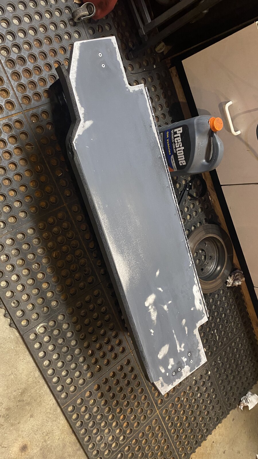

Yeah, I tried WD-40 too bc it’s a solvent. It works well on RTV. Didn’t touch this stuff. I didn’t try rubbing alcohol. It filled the pores of a scotch brite pad. Not much effect though. Goo gone is on it again tonight. I’ll see if I can wipe off what remains tomorrow, and if not I’ll go back to the heat gun and razor.

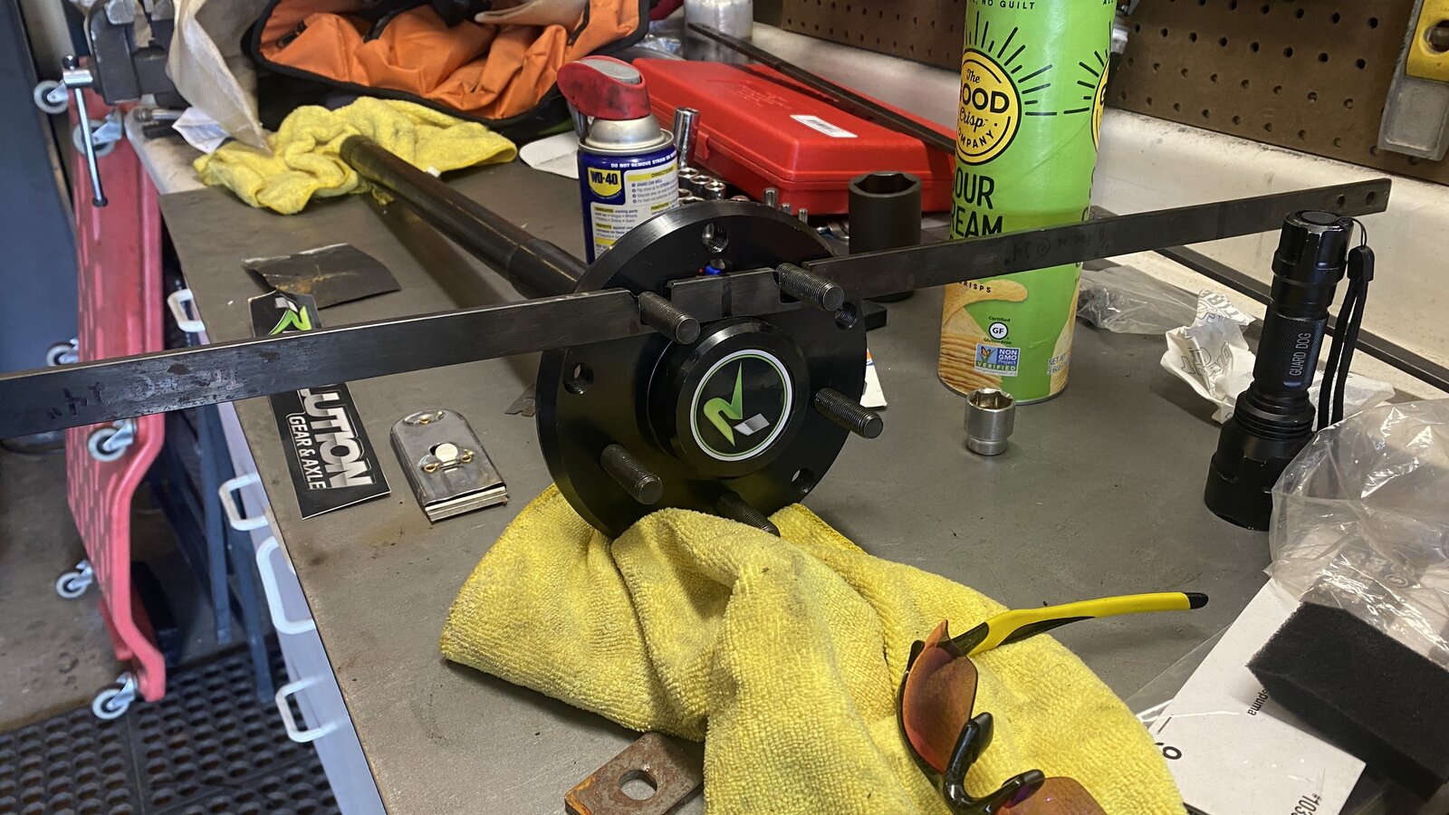

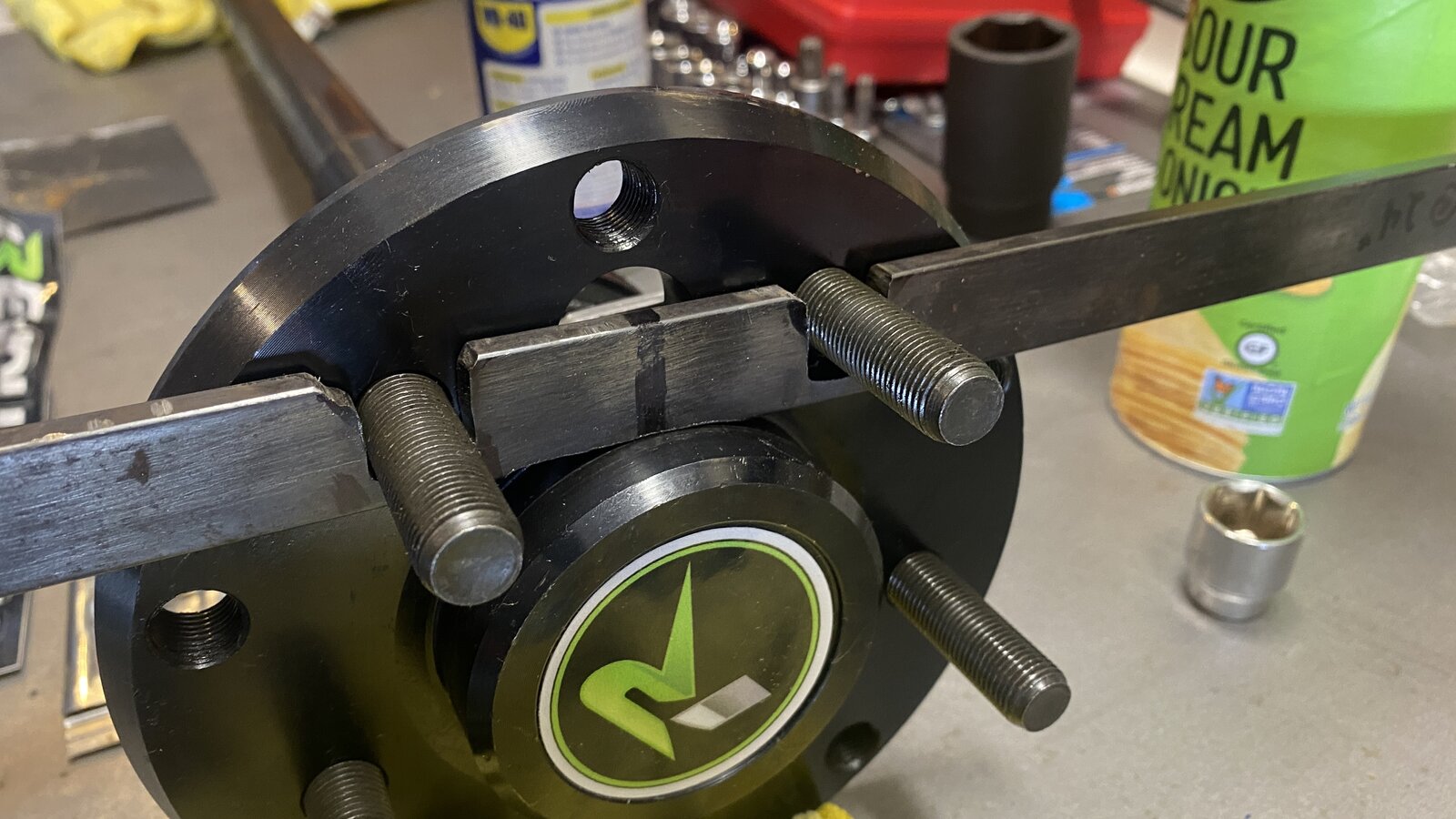

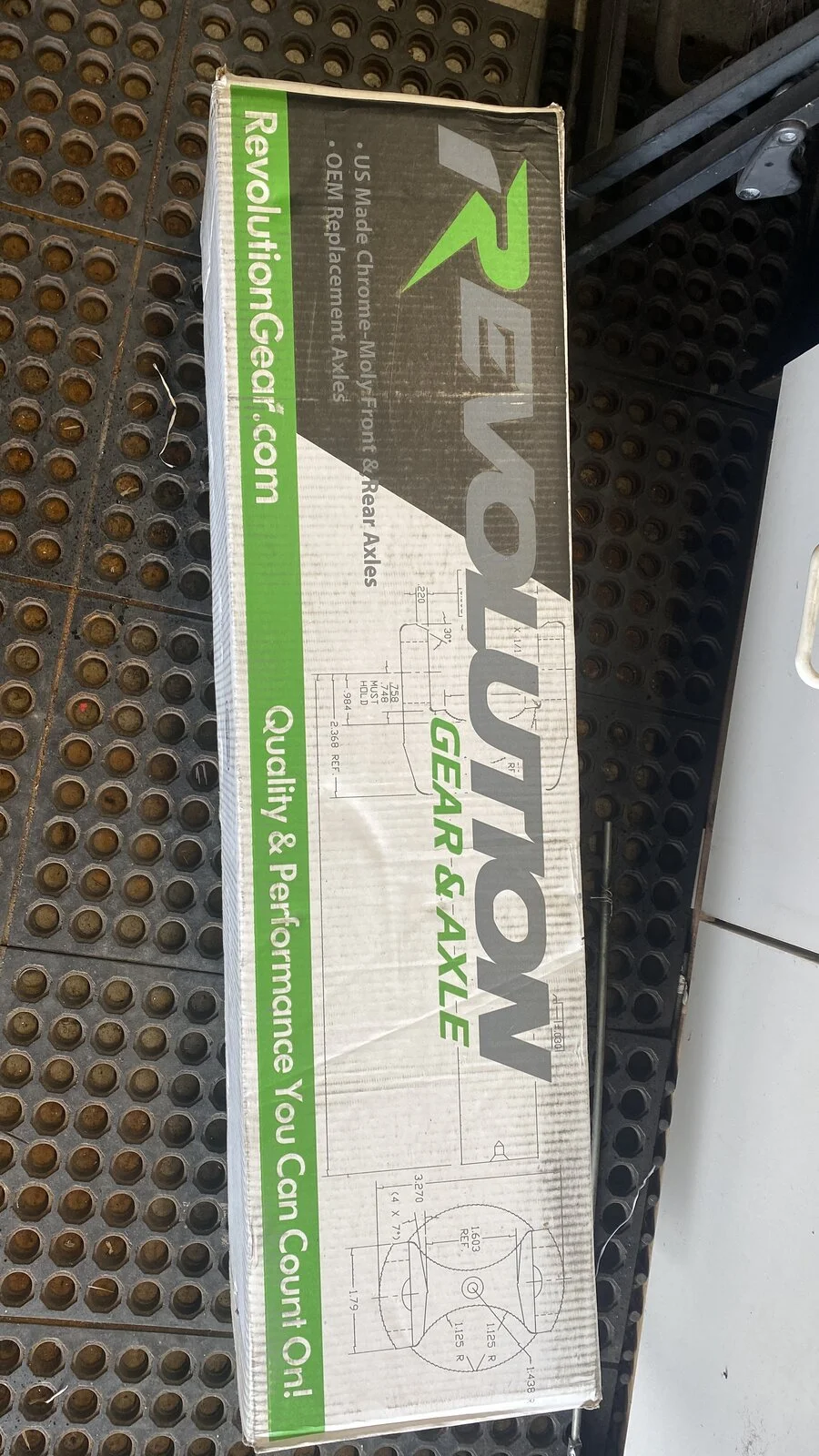

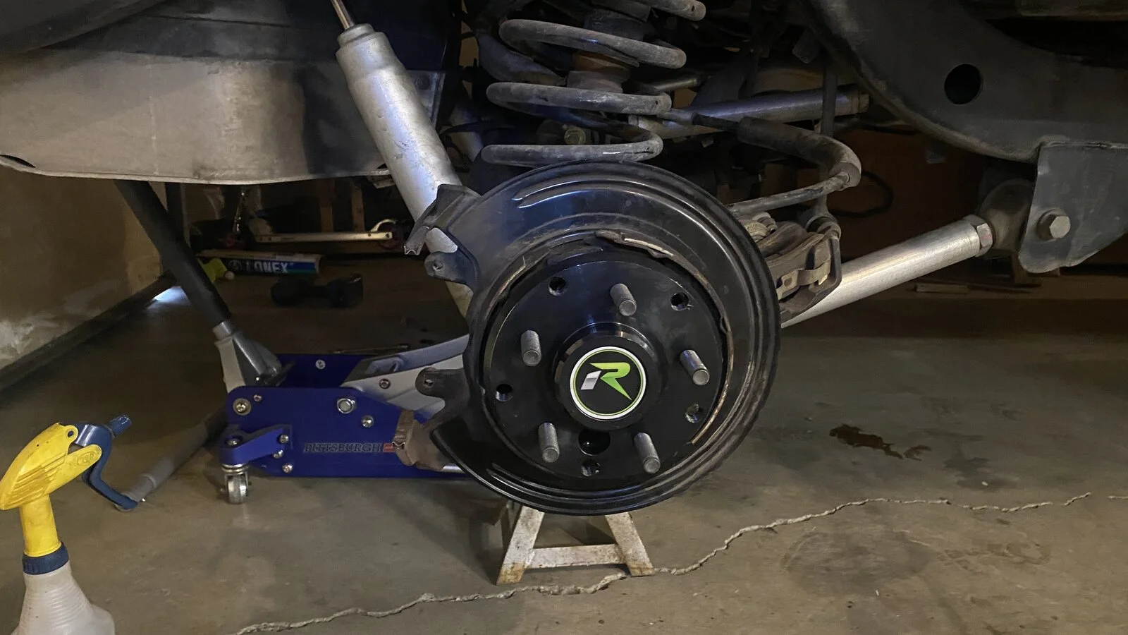

I guess everyone saw the new Revolution 4140 Chromoly Shafts (Dana 44 Rear Disc Brake Discovery Series, 30 Spline). Red loctite on the threaded studs and ready to install. I’ll have two sets of backup shafts. I’ll probably sell one and keep one.
Yeah, I tried WD-40 too bc it’s a solvent. It works well on RTV. Didn’t touch this stuff. I didn’t try rubbing alcohol. It filled the pores of a scotch brite pad. Not much effect though. Too gone is on it again tonight. I’ll see if I can wipe off what remains tomorrow, and if not I’ll go back to the heat gun and razor.
Ok. Just throwing this out there. Things that make it melty isn't working. Canned air upside down might freeze it and then a razor blade.🤷‍♂️

Right now it has a boatload of Goo Gone on it. This afternoon I suspect it’s going to scrape off fairly easily. Then I’ll be down to final cleanup. I’ll definitely be using rubbing alcohol for that. I really thought about just putting something over it, but there is some rust, and this is really the only way to remove it all. Plus, anything that sits on top of it is just asking for moisture to hide somewhere. Carpet holds dust. Sound deadener holds water. The list goes on why it’s bad idea to cover the lid. I’ve also tried a power washer. Did nothing even with the 0* tip. 🤣

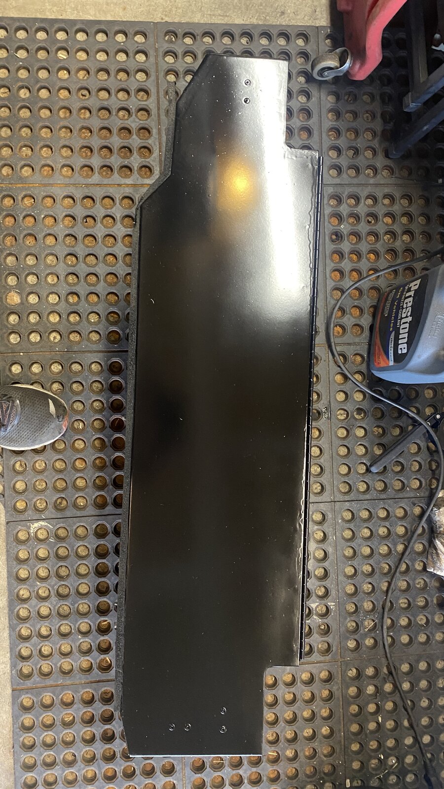

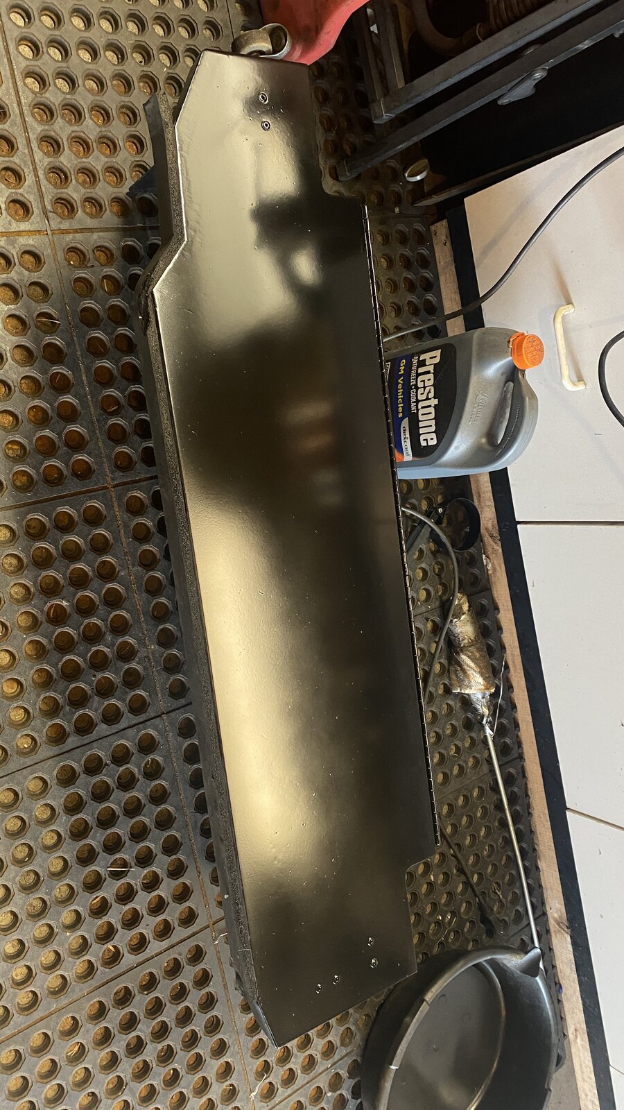

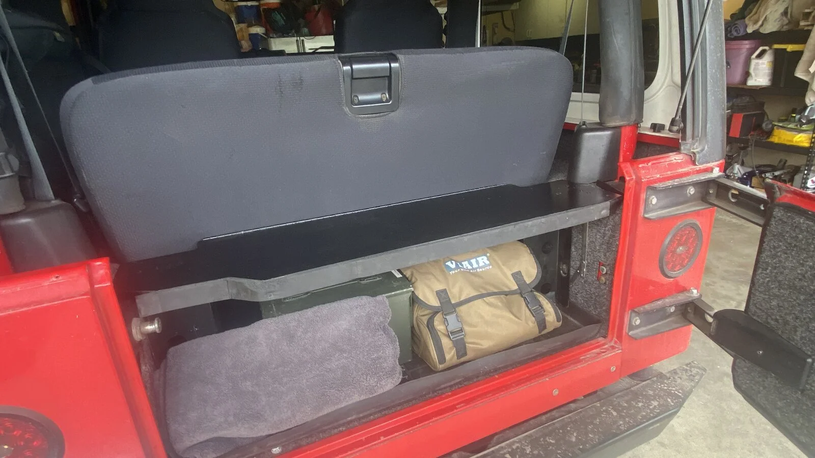

Finished the top of the InstaTrunk. My hope is that it will contain most of my trail gear. Any extra space I can fill with a couple blankets to keep everything stable. Viair 400P, Tool Roll, and an Ammo Can with fluids and odds and ends will be back there. I’ll mount it up later this week, then remove and touch up other spots, then final install.
Recovery gear like soft shackles, tree straps, and winch control are easily accessible in the console.
I sat the InstaTrunk in its home to see what, if anything, I need to modify. It’s really snug. The tailgate fits really snug against the outer edge insulation strip too, but you definitely need to have it positioned right to be able to open the lid, or it will catch on the top edge off the tub, though I’m not sure how useful that feature is. It’s amazing how accurate the fit is. Bestop got this right. I’m going to install 4 nutserts and then I’ll paint the rest of it just so it all matches. I’ve got a nice mid to dark gray enamel. I may go with that to more closely match the BedRug. There’s not a lot of space for trail gear, but I’m going to make it all work. I’ve got a tool roll that I’ll put back there in addition to what you see. I just don’t have all the tools in it yet.
