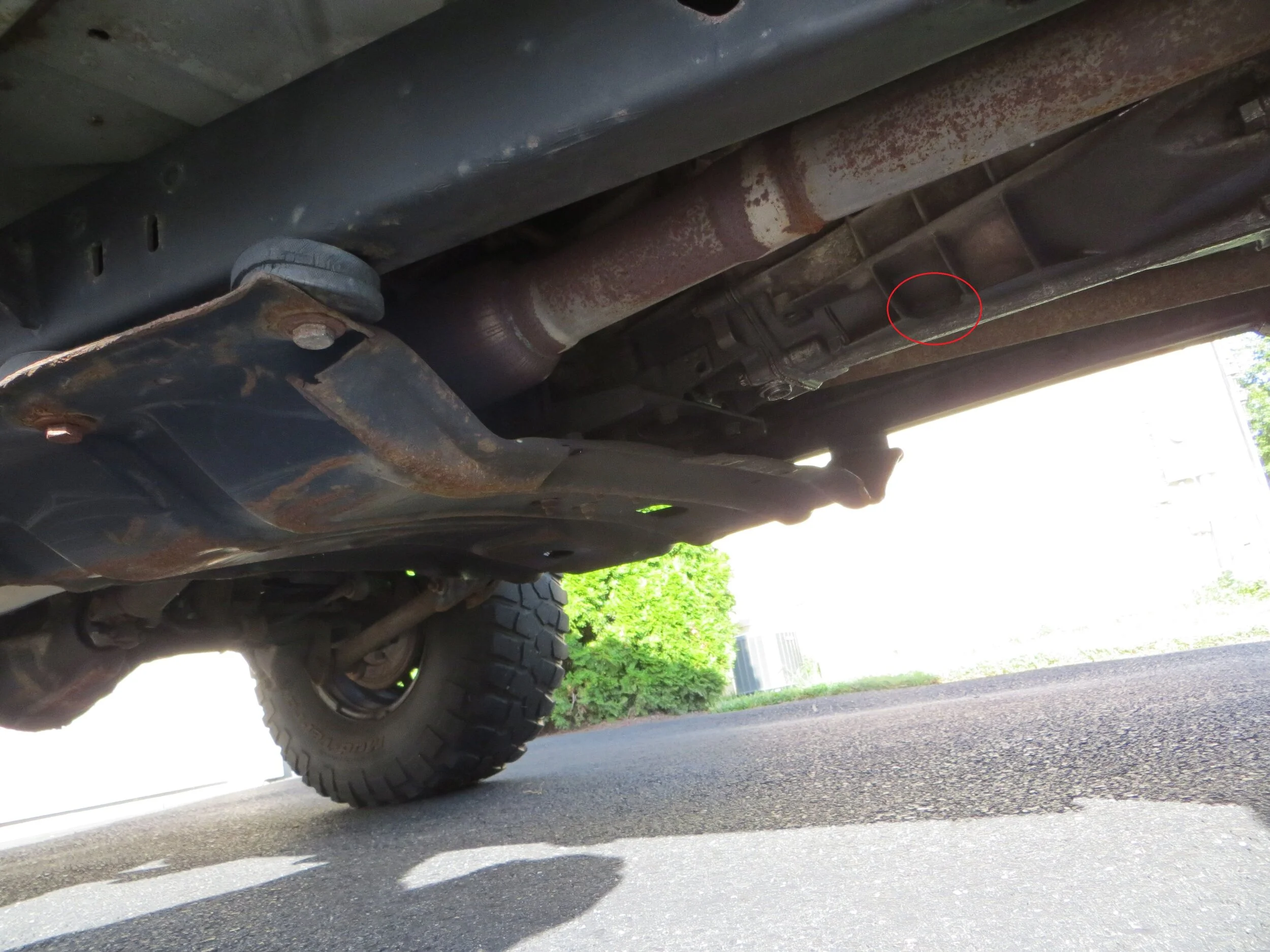

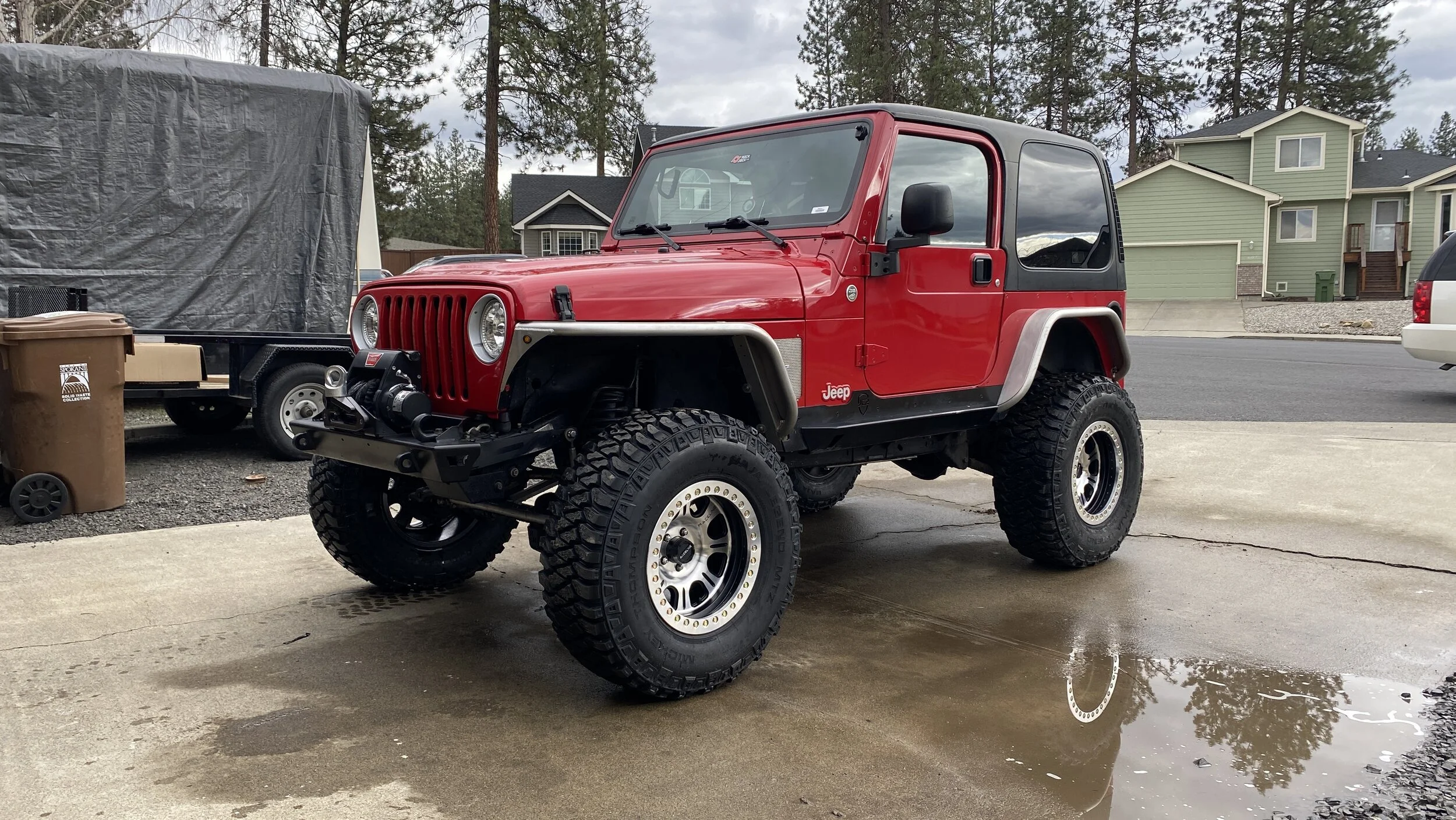

All good. Good eye. That happened in 2017 on my very first wheelin’ trip. I dubbed it “extra clearance”. It was so far up I figured nothing would ever hit it, and I was right. It never contacted anything for the 6 years it was there. With the swap I got a new pan because I didn’t know if my leak was RMS or oil pan, and now that that’s solved the transmission pan is closer to the TCase and more vulnerable, so I’m at that point and don’t want to hit it!
With my NSG-370, I chipped off one of the cooling fins on one of my first offroad trips while stock so engine skid was a quick 'must add'. The rock that did this being another inch or two towards the drive side could have been an expensive day for me...
Went Skid Row at the time and just order the Savvy - notified today that the shipping label was printed. Skid Row has been good to me but it's so freaking heavy that I'm looking forward to the Savvy Aluminum.

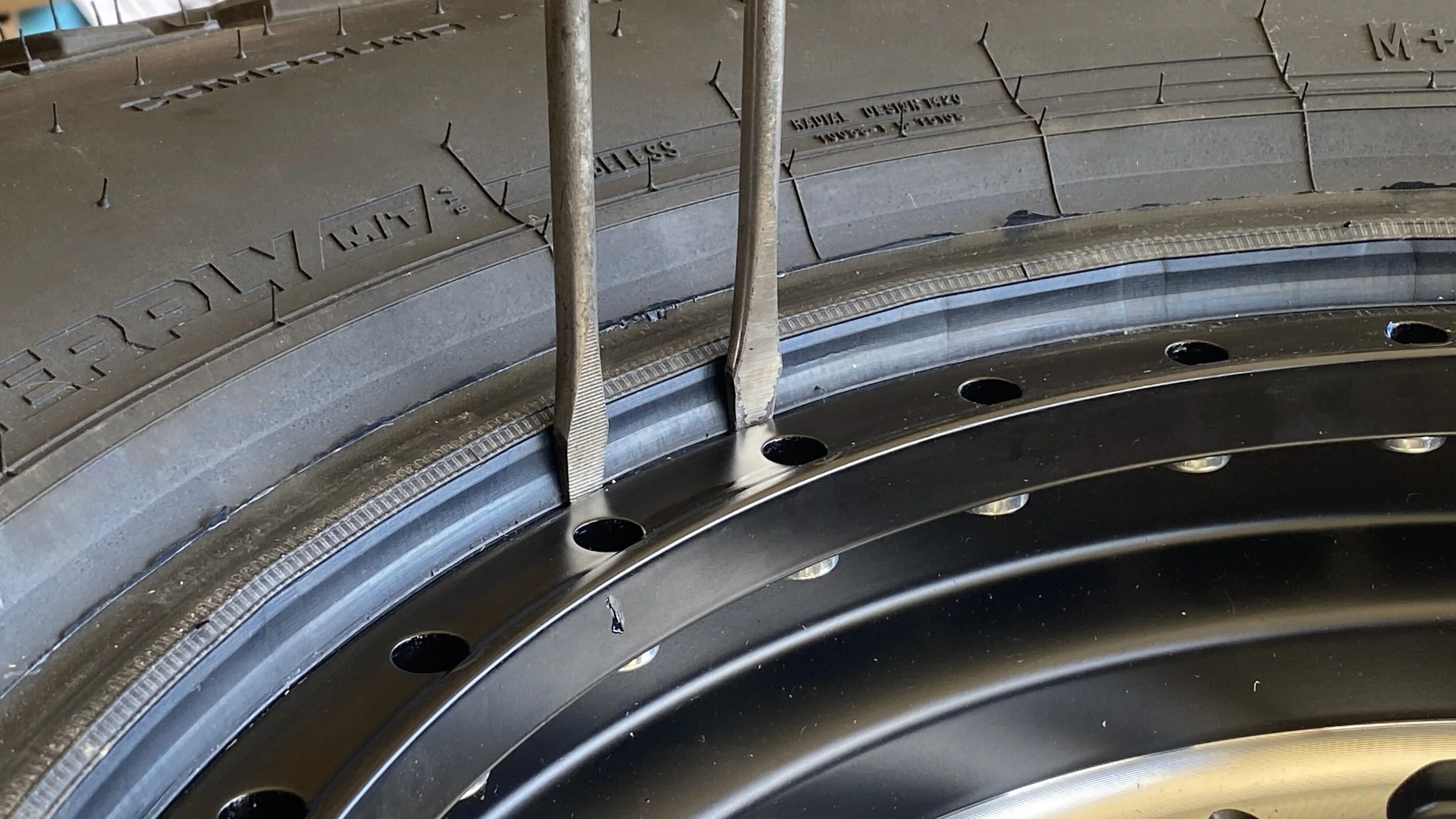

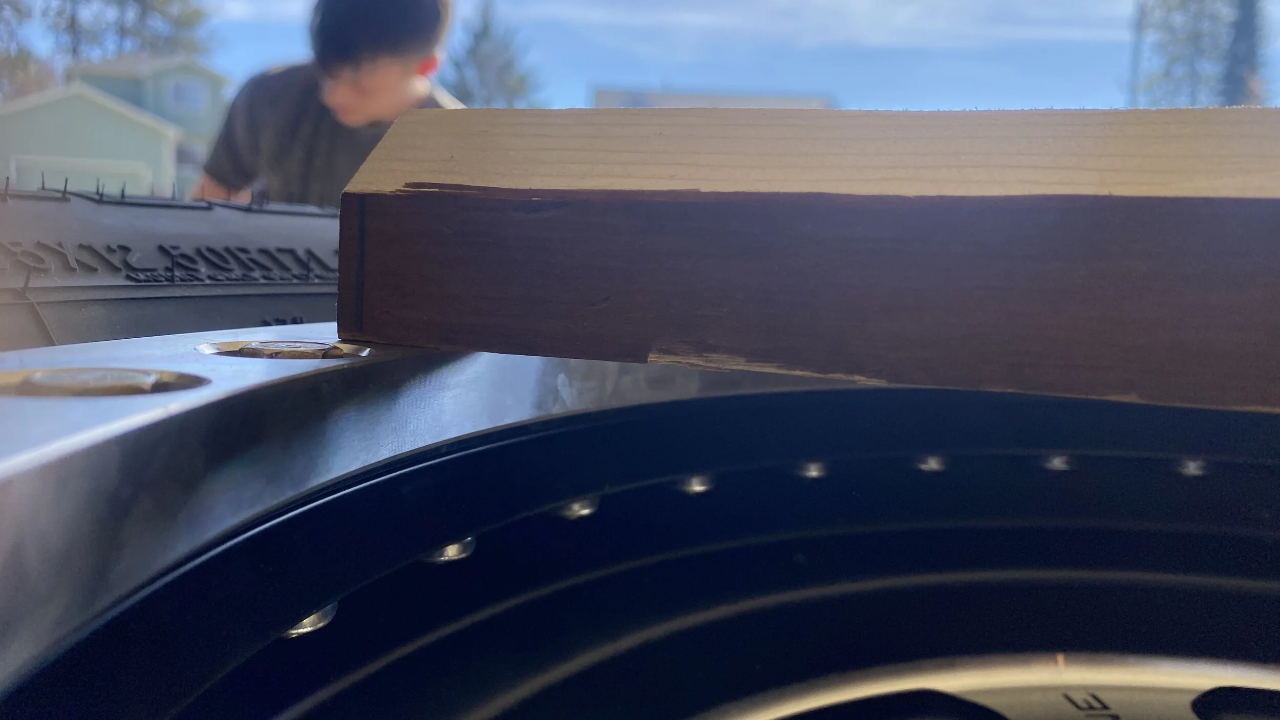

I mounted the beadlocks today using @mrblaine method.
To get the tire on the wheel set the wheel on the ground face up and put some lube on the edge of the bead on the side of the tire that you want on the backside. Set tire on top of the wheel and wrangle it on.
Next you’ll need a couple of flat blade screwdrivers to make sure the lip of the bead edge is outside the edge of the wheel face. Pry in one screwdriver and push out so the rubber pops over the edge, then move clockwise and do the same with the other screwdriver, and keep going till it’s all the same all around. Usually only needs about 1/3-1/2 of the circumference done to be centered.
Now it’s time for the ring. I mounted one wheel without a spacer, but the ring was coning more than I was comfortable with, so I got some 1/8” spacers.
Get four bolts and put some blue threadlocker on the threads to prevent corrosion where the bolts meet the threads on the wheel. Keep everything clean. No dirt or laziness here.
Put the four bolts in according to the points of the compass (+), hand start each one and make sure they will go in easily. Use your impact and usually a 1/2” 5/16-18 bolt and give it a go just enough to get it scrunched down a bit. You won’t reach the torque spec till the ring (with or without spacer) is touching the wheel.
Once I got those four on I moved one bolt to the right and did those four, then one more to the right and those four (hand start each one). Then I scrunched those down about the same as the first four. Then I just put all the others in and did the same.
Then I looked and you could see which ones were loose now (the first bolts you put in most likely). Snugged then down and any others that needed it. Check spacing between Ring and wheel. Do what you need to get them really close.
Then pull out your torque wrench (I set mine to 200 in-lb, but follow whatever your Beadlock manufacturer states), and start working around. You’ll go around till they are all equally torqued to spec.
I like to lay a flat board or piece of aluminum across the diameter of the ring to check for coning. You want them as flat as possible.
I timed the second wheel from start to finish and it was 40min.
Set on the ground and air up with your compressor. They usually catch the bead at 7-8lb. Keep going up to 23-24lb for 35’s. The limit on my Raceline’s is 24lb.
At this point you’ll be done and probably need to go get them balanced.

You can see in that picture how bad I bend up the TC shovel that it doubled-back on itself on the front passenger corner... lol
I was a new Jeeper and didn't know how to judge a line. Now I can judge a line but I still live by the mantra of " 'bang and clang' that's why I have skids". My Jeep hasn't been as capable as it is today (yet untested offroad... yet ;) ) but I was always wiling to go for it, even if I needed to drive it home from the offroad park...

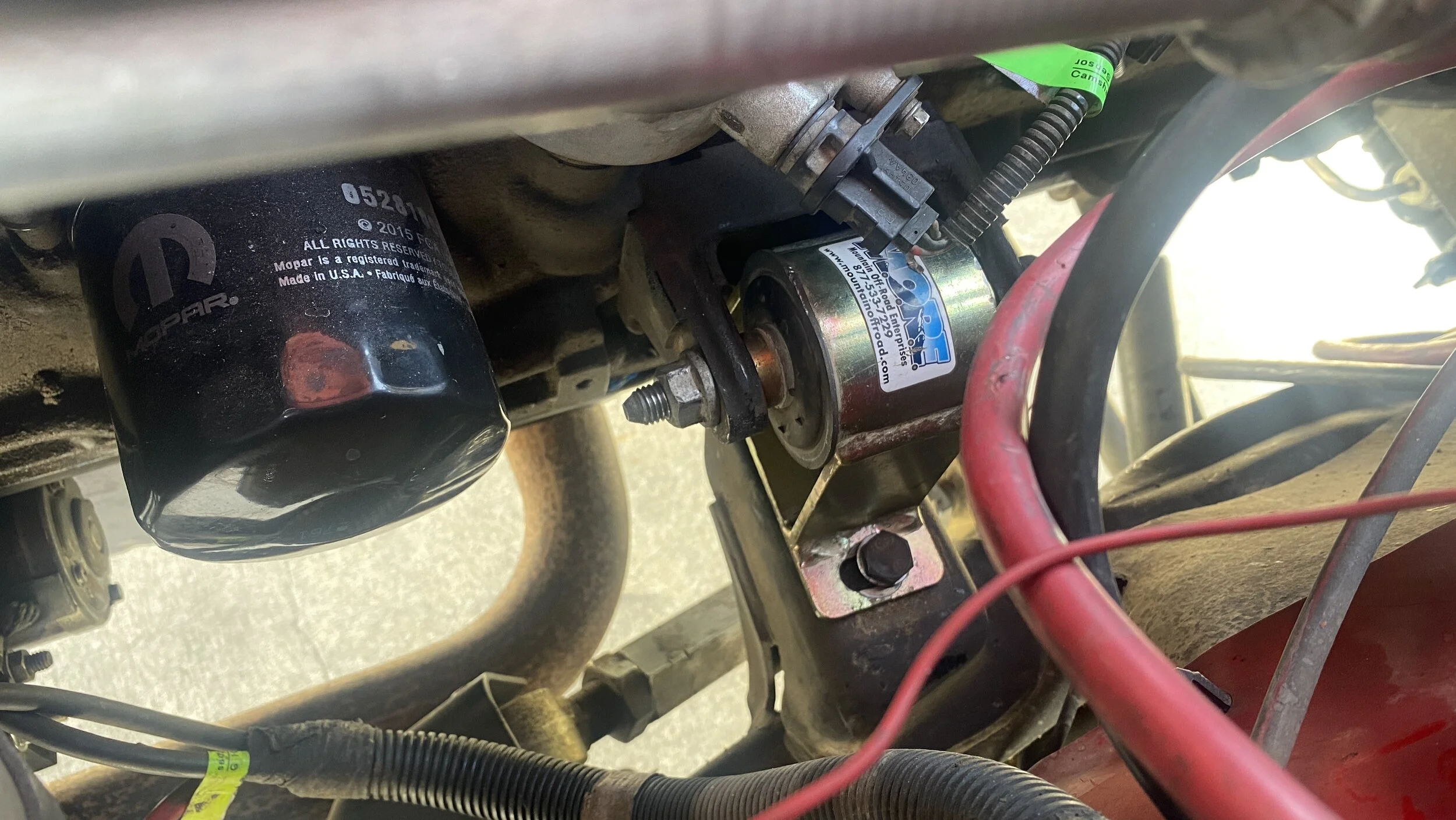

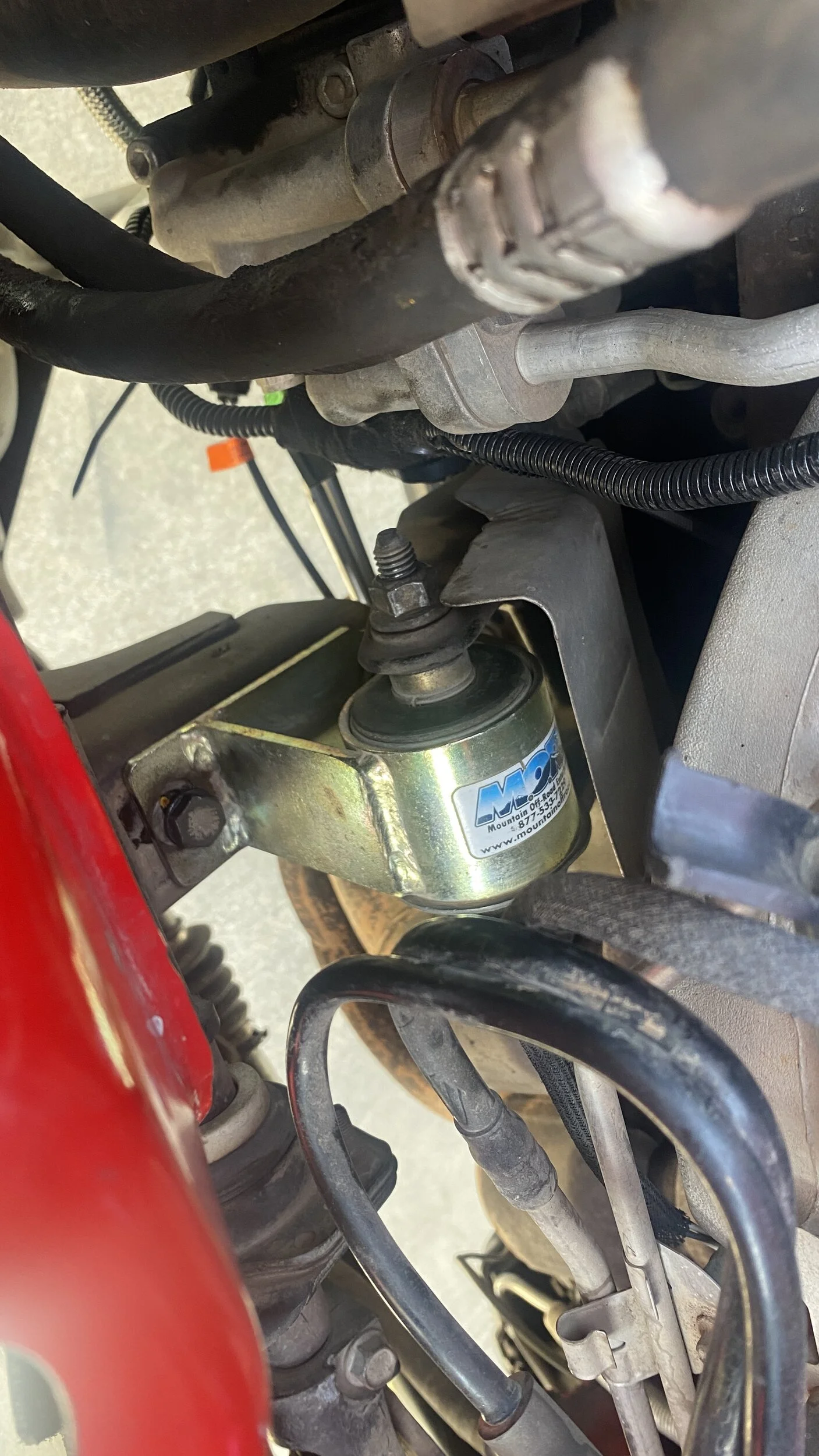

Mine has an annoying level of vibes, not sure if due to the Omix motor mounts or Savvy TT, since I installed them simulataneously. Probably a bit of both.
There may be a bit of vibes from the Savvy TT with its transmission mount. I’ll find out. I can drive my sons 42rle with stock transmission mount and skid next to mine.
Keep us posted, I’m curious.
My vibes are only present when stopped and idling. Blipping the gas or shifting to neutral makes them go away.
