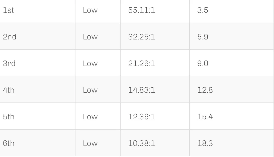

I’m excited to see what happens when I go into 4L! The crawl ratio should be awesome
@2000 RPM with stock T-Case

What is the far right column? Is that mph?
And my crawl ratio in 4L @2000rpm you’re calculating at 55.11:1? I just want to make sure I’m reading the chart correctly. Also, how can I learn to calculate these values?

Yes that’s mph on the right. Go to advance adapters website they have a crawl ratio calculator.
