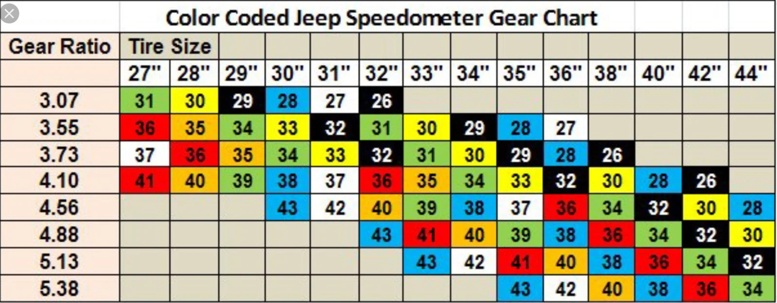

According to this speedo gear chart you should be running the 39 tooth gear.

I already have a 41 tooth for a move to 37’s but the 12 step program is working for now.

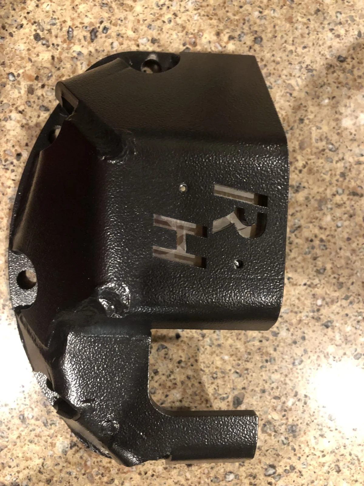

Got home from a trip and this was waiting. 1/4” RockHard 4x4 Dana 30 diff guard. Nice to have a little insurance for the internal investment.
78945
78946
It’s about time to change my diff fluid after the first 500 miles on the new gears. It will be nice to see inside.

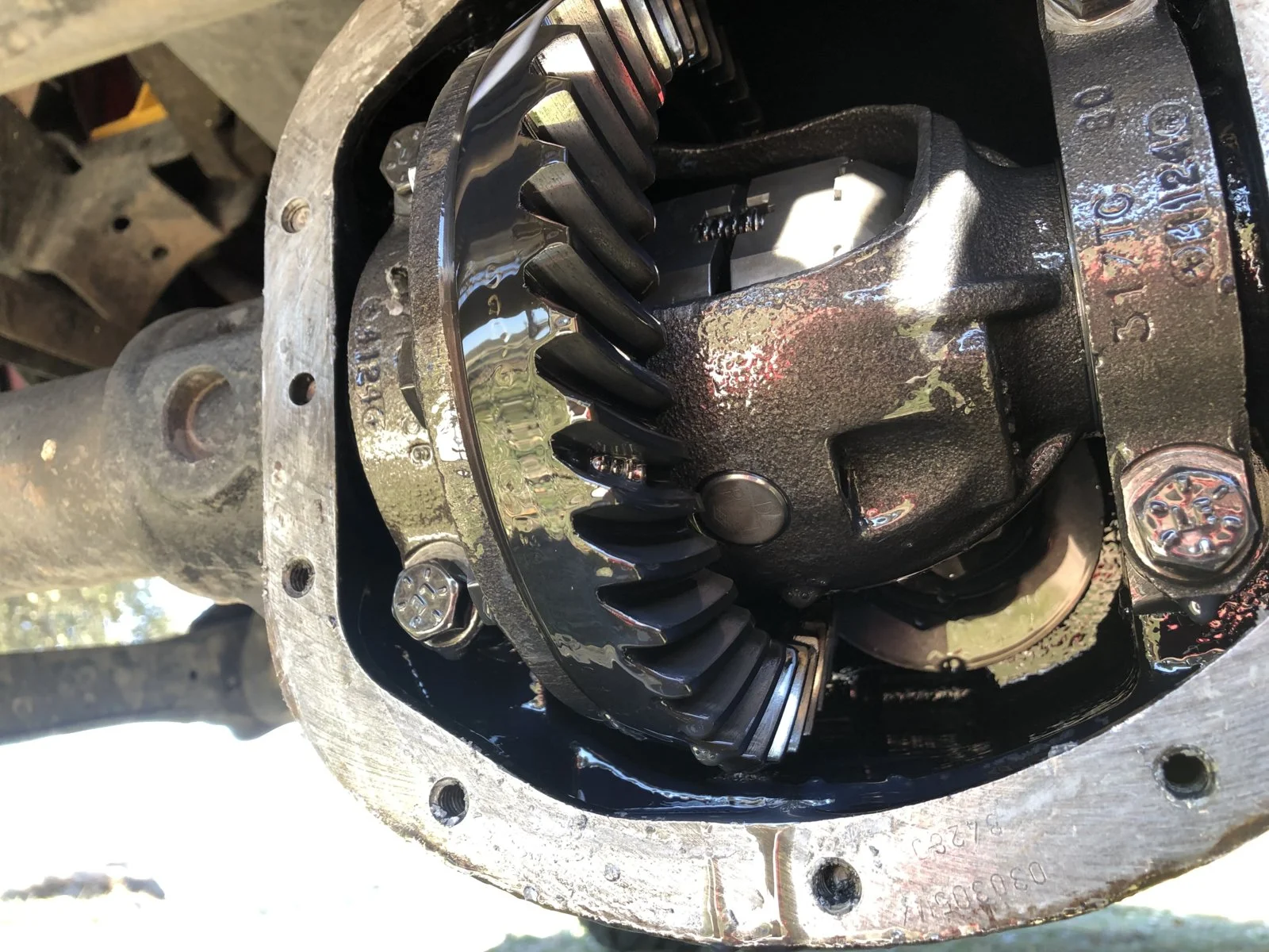

Changed the gear oil front and rear. This is my first look at my new gears. I don’t see anything abnormal, but I don’t have trained eyes.
456 gears in Dana 30

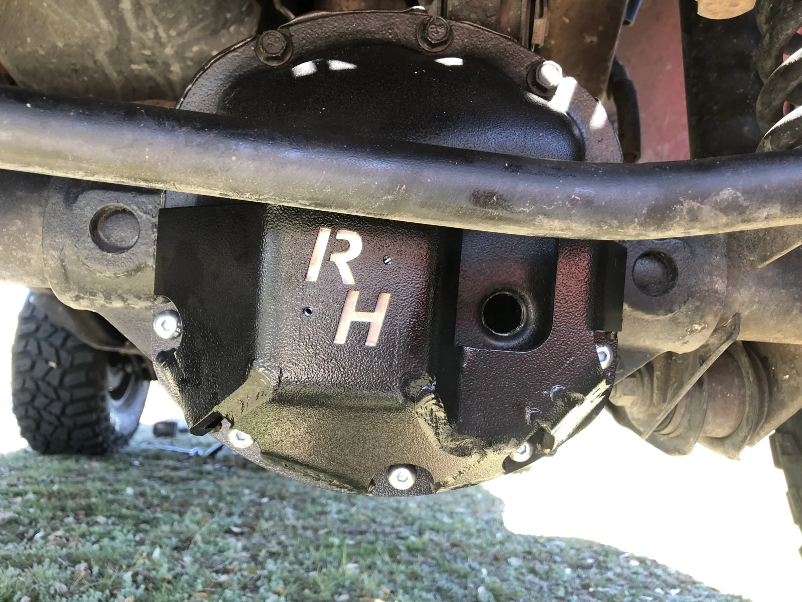

New RockHard 1/4” Steel Diff Guard
79052

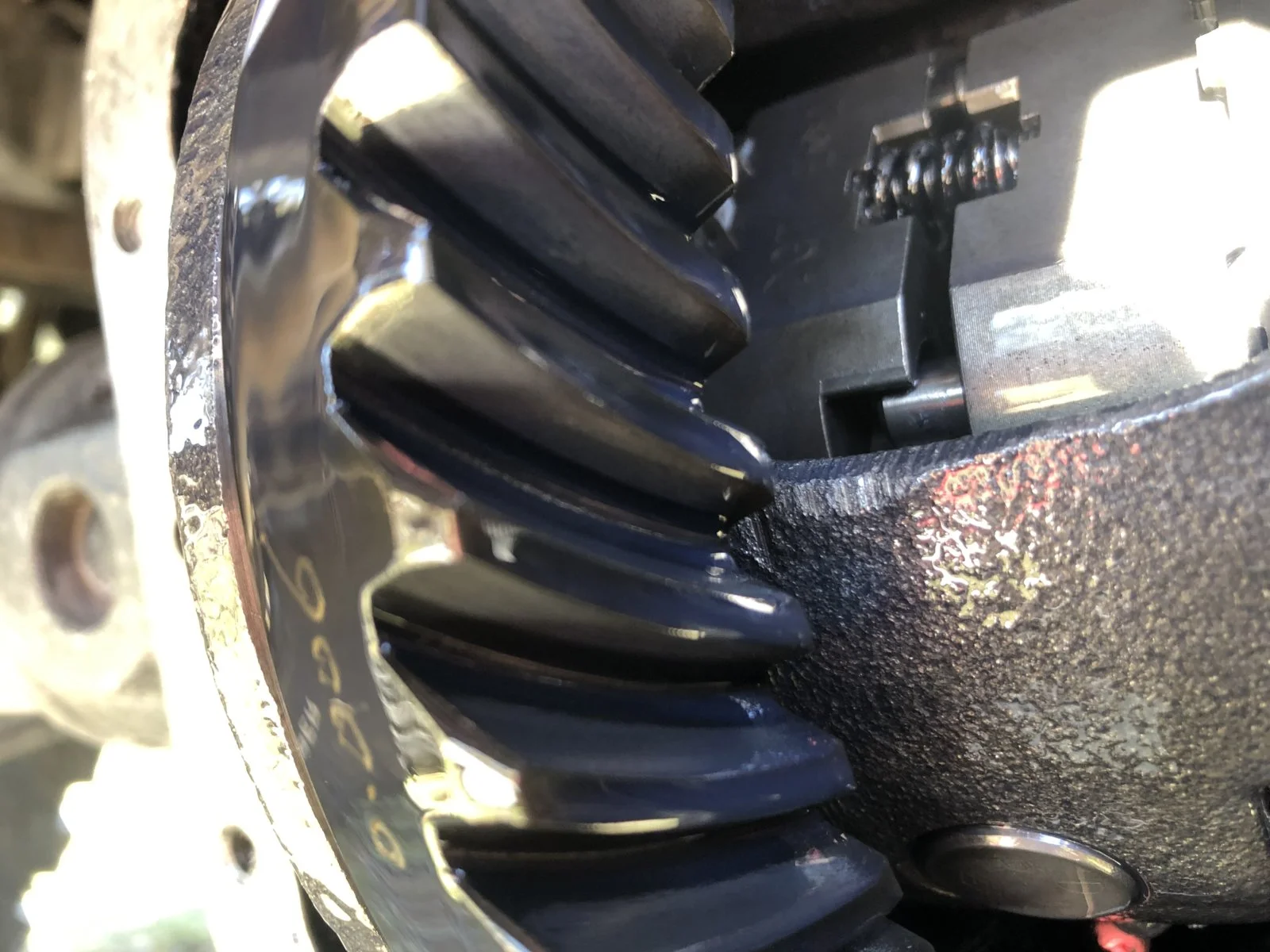

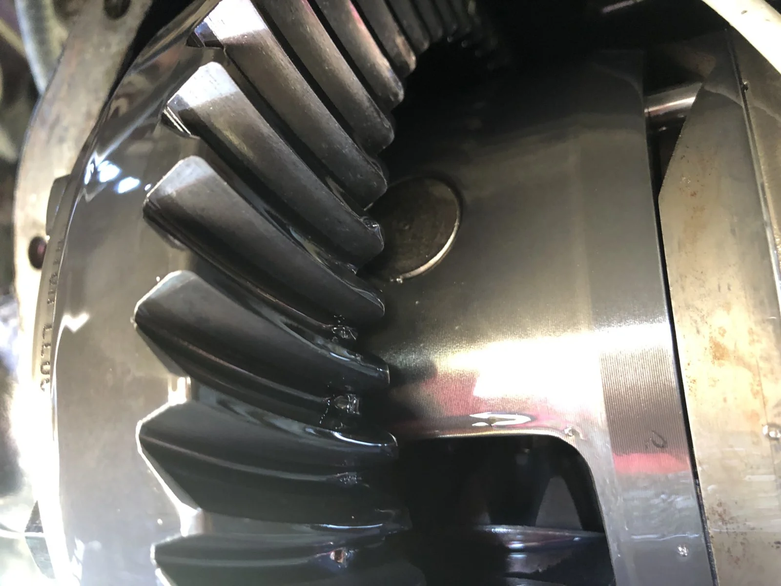

456 gears in Dana 44
79050

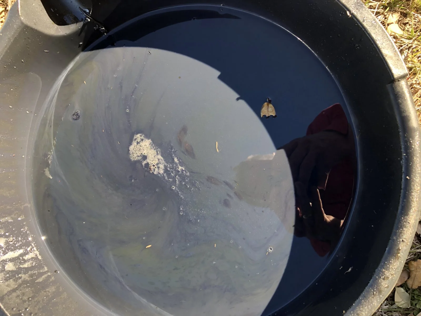

Old gear oil
79051
