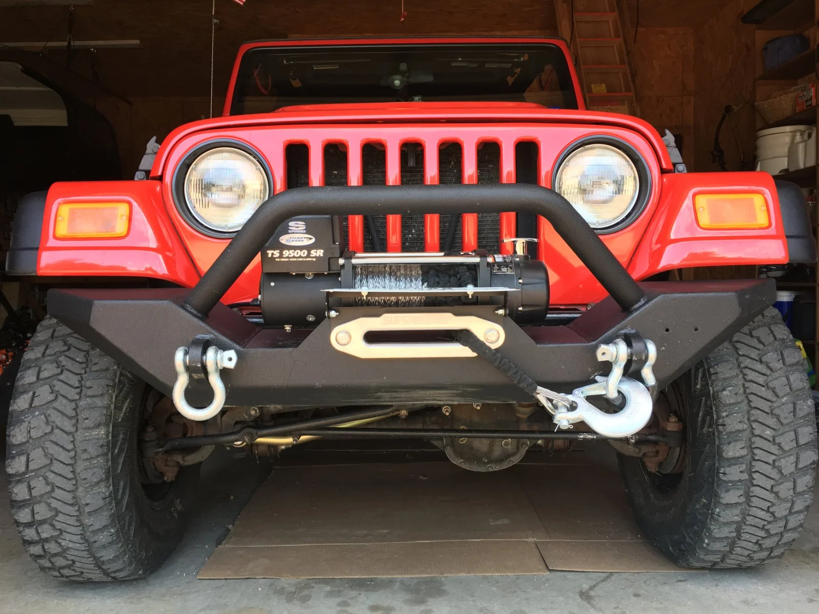

EAG Front Bumper and Superwinch 9500SR
The bumper has been questioned by others. In my experience, I've hit two granite rocks with this bumper. All I had to do was wipe off the marks and the bumper was fine, no dents, no scratches even, so it holds up pretty well under rock crawling situations.

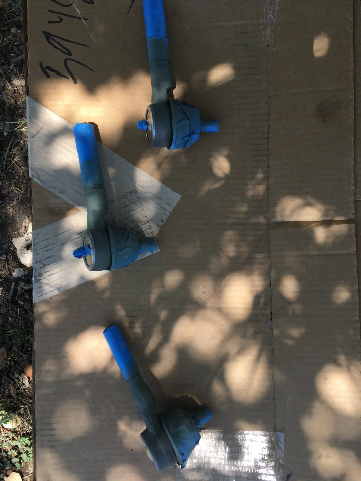

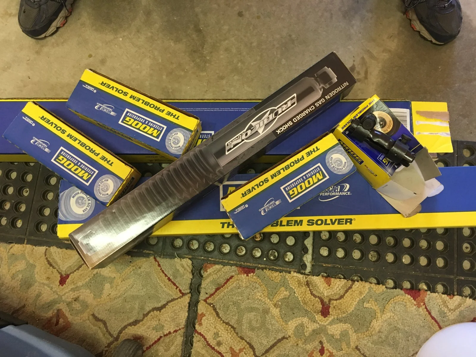

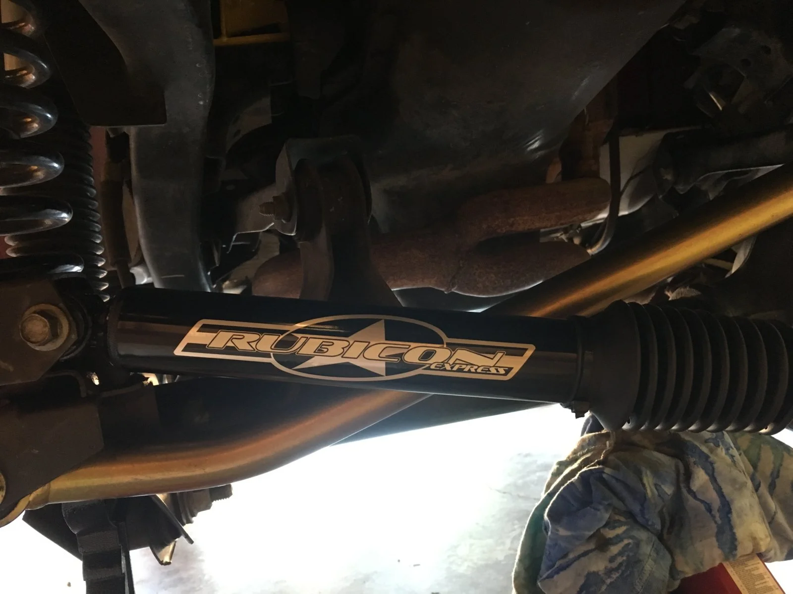

OK, to try and solve my death wobble problem, today putting on my new drag link and ZJ tire rod conversion with Moog parts, plus a fresh steering dampener By Rubicon Express. All the parts except the steering dampener needed to be degreased, sanded and painted. I used some etching primer and then four coats of black satin Duplicolor made for wheels.
When I remove my OEM steering dampener, it still has some life in it, but I was there already so just switched it out. I rechecked my ball joints and rotors and everything seems good there. I think the Pitman arm is fine too. So I'm very hopeful that this solves the death wobble, Which I was even getting this morning just driving a few miles down the road.
I'm using the torque specs for the 93 to 98 Jeep Grand Cherokee ZJ for the part that is the conversion. They drag link is TJ. Wish me the best guys! Another Just Empty Every Pocket day.
