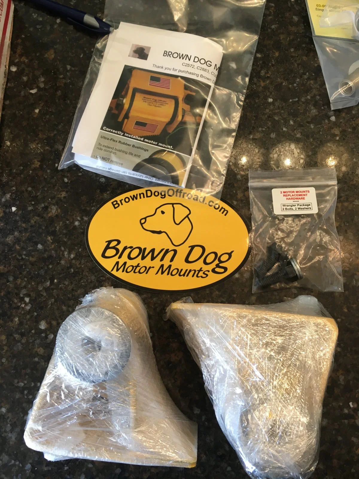

1" Brown Dog MM delivered. Packaging was superb. Instructions in Color. Even stickers on packaging in Color. Top notch.

Good choice on the Brown Dog mounts. Those things are very high quality!
