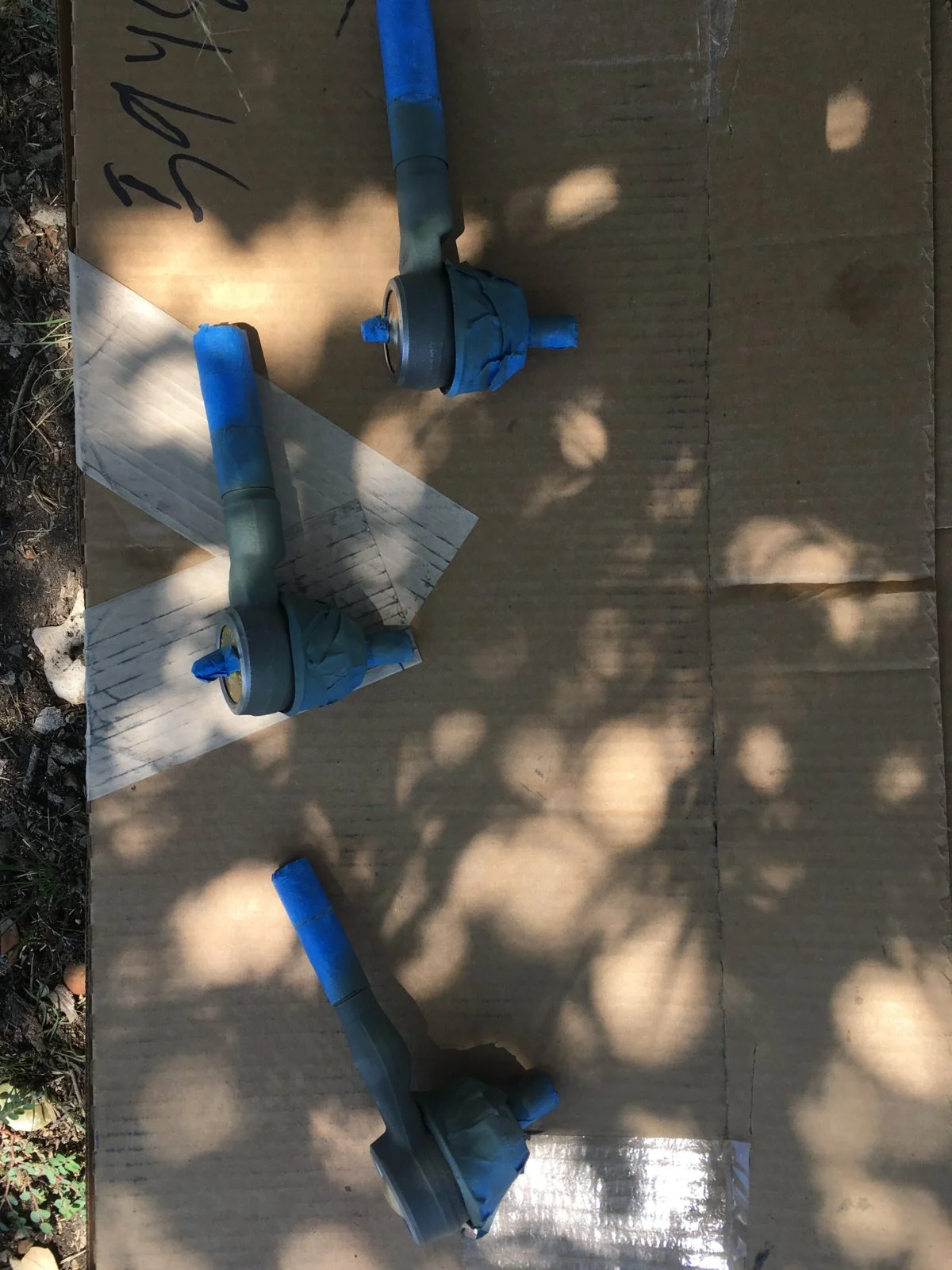

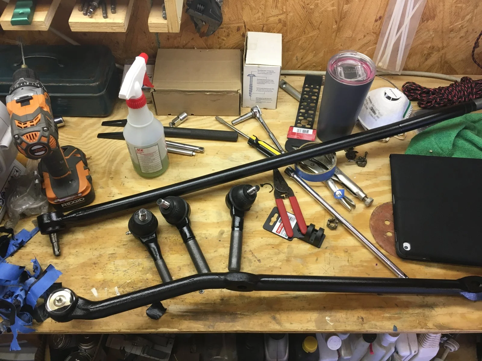

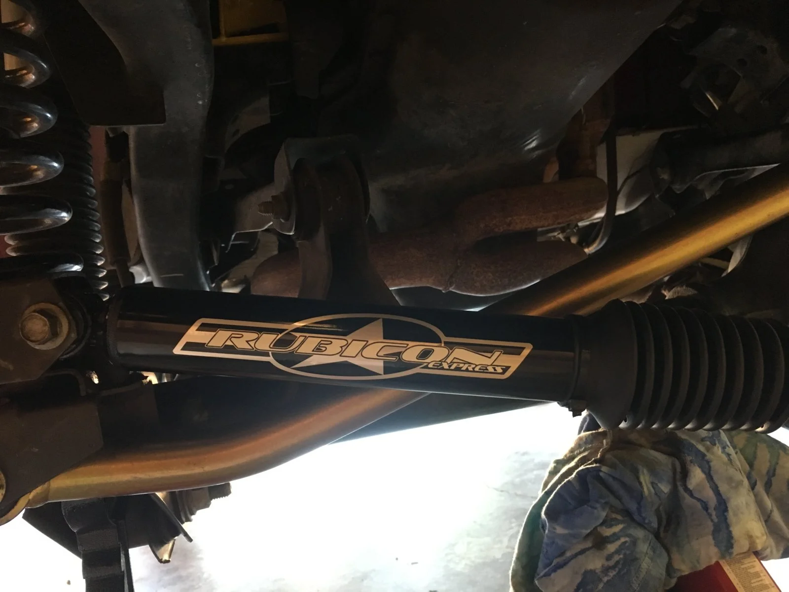

OK, to try and solve my death wobble problem, today putting on my new drag link and ZJ tire rod conversion with Moog parts, plus a fresh steering dampener By Rubicon Express. All the parts except the steering dampener needed to be degreased, sanded and painted. I used some etching primer and then four coats of black satin Duplicolor made for wheels.
When I remove my OEM steering dampener, it still has some life in it, but I was there already so just switched it out. I rechecked my ball joints and rotors and everything seems good there. I think the Pitman arm is fine too. So I'm very hopeful that this solves the death wobble, Which I was even getting this morning just driving a few miles down the road.
I'm using the torque specs for the 93 to 98 Jeep Grand Cherokee ZJ for the part that is the conversion. They drag link is TJ. Wish me the best guys! Another Just Empty Every Pocket day.

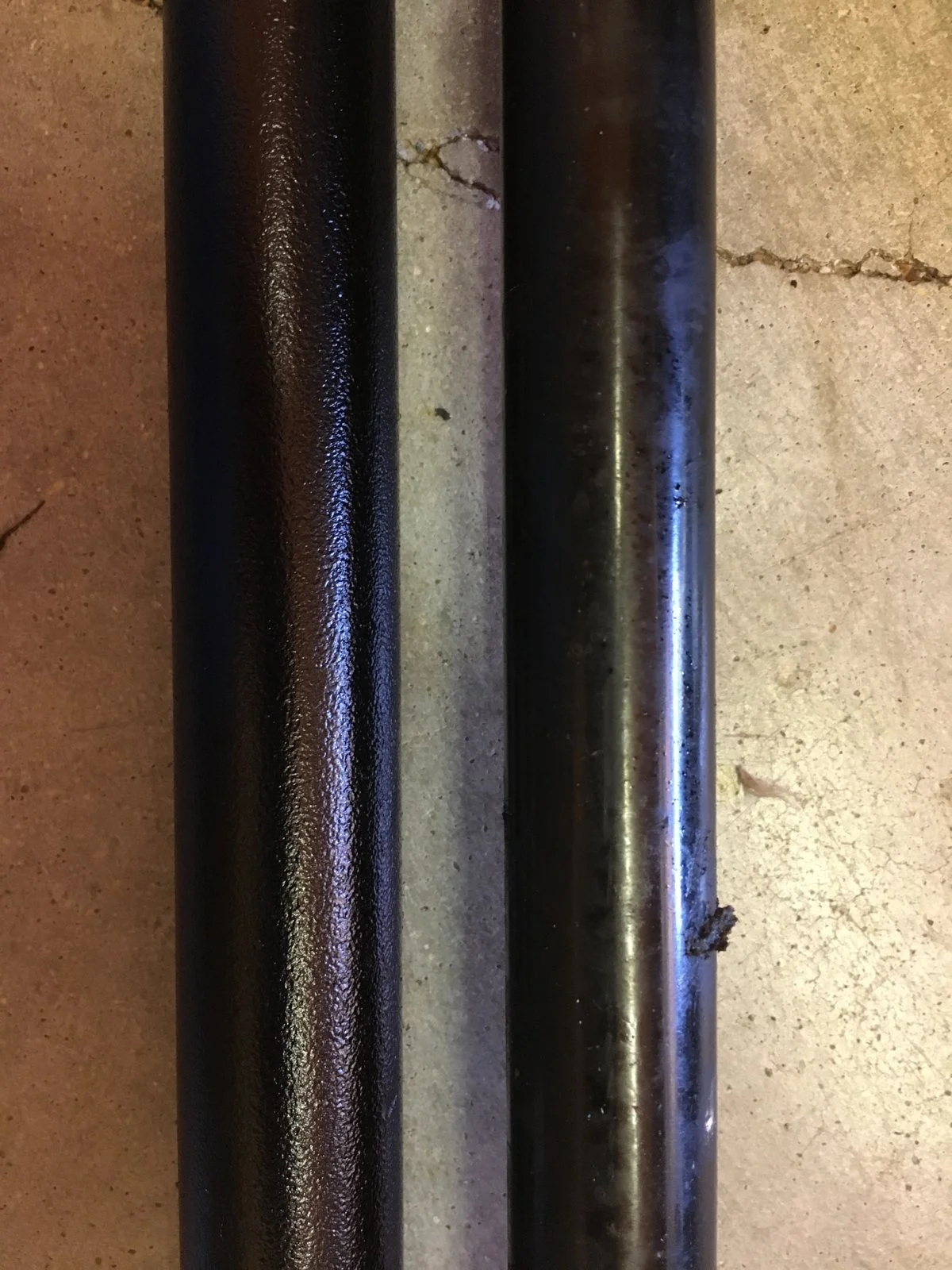

Finished up! Definitely needed a pickle fork to remove drag link at Pitman. Everything else went smooth. Went for a spin. Stayed on the backroads that give me so much trouble. Stayed in the 40-45mph zone that is so problematic. No DW. Feels pretty solid. No shimmy. I think I'll have the tires balanced for good measure. The ZJ Tie Rod is way beefier than the TJ. 1" solid steel bar rather than a hollow bar ~ .75". Moog parts for ZJ are also far better. Have to paint though! Beware. Took me all of about 5 hours with priming and painting.
ZJ solid steel left; TJ hollow steel right

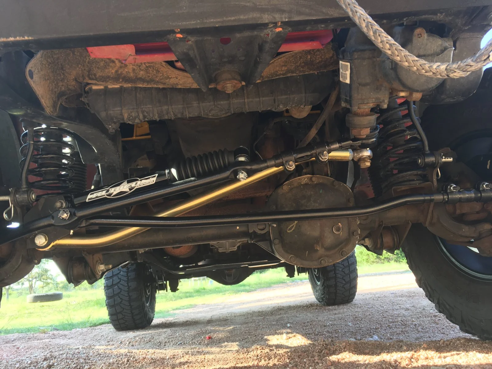

Greased the zerks. By the way, I put in five squirts, didn't want to overdo but. How much should I put in? Aligned it perfectly. The finished product!
She looks better than ever!

I thought I read this whole thread, but I think I missed something. I saw where you talked about possibly changing your sway bar links, but missed what you ended up getting. Looking at the pic it looks lik some sort of disco. What did you decide on?
For now just homemade quick disconnects. They work fine for $5. I really can't decide if I want to drop $400 on the antirock. If I decide against it I'll either upgrade to RE quick disconnects or upgrade my existing hardware to grade 8
