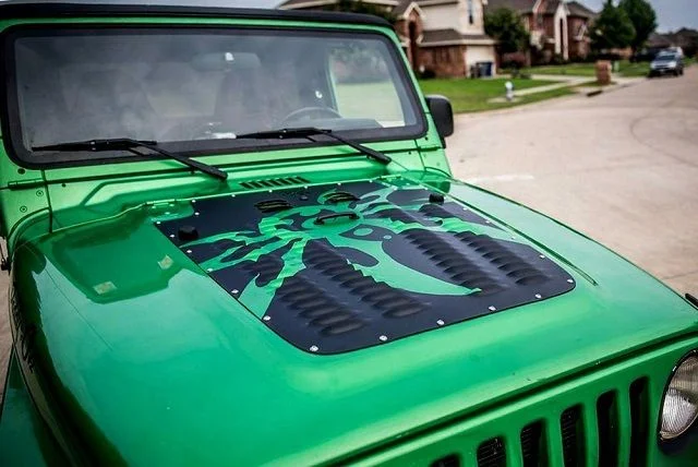

I do have a hood louvre panel, though. Mostly just to help with under hood temps on the plastics and wiring. And I think it looks cool.
I do have a hood louvre panel, though. I think it looks cool.
That's an important factor when buying one. Some are uglier and more useless than angry grills. :unsure:

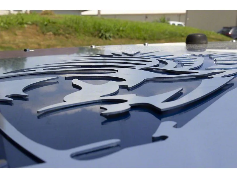

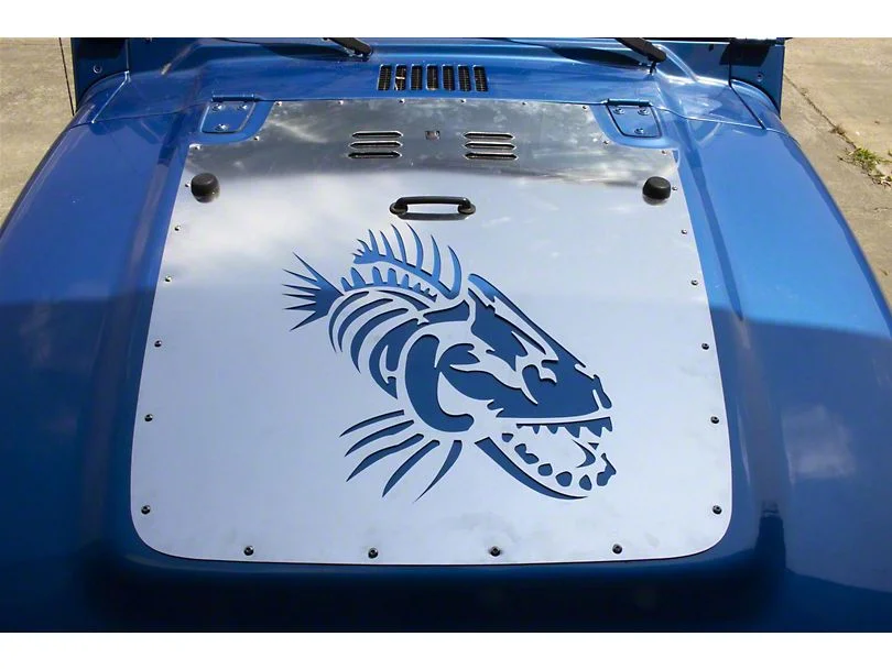

Stupidest looking product I've seen in a while.
Got to love that Fishbone Offroad selling their GIANT logo. And people here bitched about the little Bestop (removeable) tramp stamp on their new tops. ;)
p.s. This guy loved the Poison Spyder logo so much, he "color-match" painted their decal on his louver. That's dedication. :cool:
