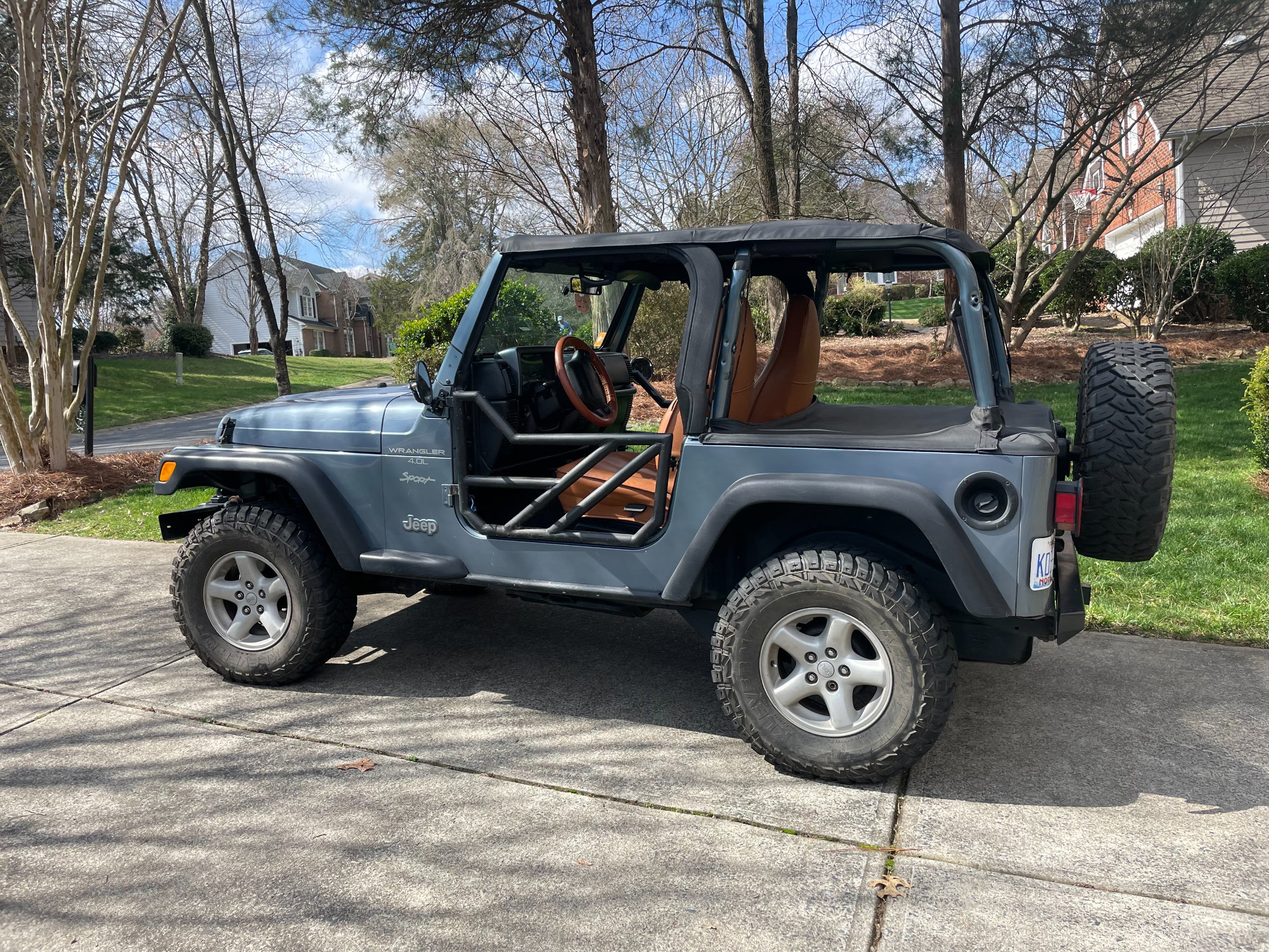

Here's my current list:
- BMB 1.25'' body lift
- Rough country 1'' motor mount lift (I know, I know, we don't like that brand... but does it really matter for a motor mount lift? Let me know. Its the cheapest option I could find)
- Freedom offroad 2.5'' lift springs (feedback on this choice please, don't know much about the brand, general consensus seems to be that spring brand doesn't matter like shocks do)
- JKS rear trackbar relocation bracket
- Zj tie rod
- I currently have Rancho RS5000X shocks, for 0-1 inch lifts. I think these are fine to keep, people say they long run?
- Still doing research on what tires I want specifically... currently have Kenda Klever MTs which I am happy with, I like the look, I might just get them in the bigger size
- Are my wheels fine for 33s? 15x8 jeep brand wheels, I don't know what the specific name is, I can figure that out if needed though.
- 4.56 gears - This is where I need the most suggestions/opinions. Do I buy new, do I look for axles with them already installed? (I have a 4.0, 5 speed manual). How feasible is it that I do the work myself? I really want to, I know I can, but is it really a good idea?
You imply you're on a tight budget here, and that you don't do any kind of hard wheeling, so I'll strip the requirements down for you. 1-you need a 2-3 inch spring lift, 2- get a 1-1.25 body lift, 3- use a 1" transfer case drop go with a 1" MML with the BL (no need for SYE, new driveshaft or control arms, yet), those are mandatory. Adjustable track bars front & rear are a little more optional, but highly recommended. The ZJ tie rod will add a little assurance, and quick disconnects will help out, but these are not mandatory.
For the gears, I recommend 4.10 or lower. I'm on 33's with 4.10s which have been fine, but I want lower. If you want to look for take out axles, 4.10s are decently common around us and 4.56s can be found. When I regear, I'll be going 4.88 or 5.13, so make of that what you will.
For the tires, 33x10.50 would be my choice on factory wheels. 10.50s will save width for turning and weight. As for the spare, you can get away with the stock carrier and hinges for a while, but I recommend getting reinforcements back there ASAP with 33"+. You will also probably need wider flares to keep the tires out of them at full stuff.
In case you're wondering, my ride currently sits similar to what I've laid out above, and I've never had issue off road, even at places like Uwharrie, but I don't push through rock gardens.

You imply you're on a tight budget here, and that you don't do any kind of hard wheeling, so I'll strip the requirements down for you. 1-you need a 2-3 inch spring lift, 2- get a 1-1.25 body lift, 3- use a 1" transfer case drop (no need for MML, SYE, new driveshaft or control arms) those are mandatory. Adjustable track bars front & rear are a little more optional, but highly recommended. The ZJ tie rod will add a little assurance, and quick disconnects will help out, but these are not mandatory.
For the gears, I recommend 4.10 or lower. I'm on 33's with 4.10s which have been fine, but I want lower. If you want to look for take out axles, 4.10s are decently common around us and 4.56s can be found. When I regear, I'll be going 4.88 or 5.13, so make off that what you will.
In case you're wondering, my ride currently sits similar to what I've laid out above, and I've never had issue off road, even at places like Uwharrie.

Thank you, super helpful, definitely the route I’m thinking
