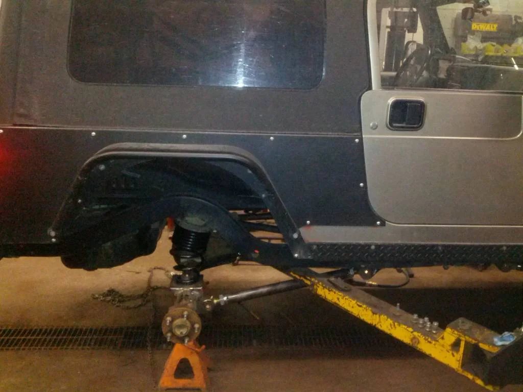

Yeah I was wondering how much up travel you might have. Has long as it is one tire at a time it shouldn't really be a factor.
That's tucked up a bit higher than ride height but it's close. I have about 3" of up travel, give or take. Worked out well when I went up to 37s though. No extra trimming needed. I could probably go even a big bigger but I don't see a need at the moment.

If you are looking to fab up a long arm have a look at the TMR Customs kits, makes for an easy starting point but still let's you do just about whatever you want. The rear arms on my LJ run basically to the tcase skid for the flattest possible angle.
Also found some ride height shots.

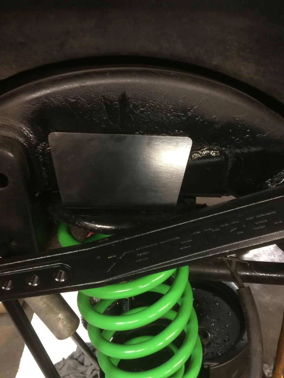

I like that setup. Very clean looking. Are you going to relocate your upper spring mounts? I used Gen Right Rear Coil Spring Correction Kit RSM-2150. Easy setup.
I ran the Maxxis Big Horn 35x12.50 for a while. Then I went to the Mastercraft Corsairs MXT 37x12.50 17. I really like them on the road and they ae great on the trails. They clean out really well.
Nice looking mount, I plan on it yah. I'll probably go with the aev one as it gives a bit of lift. That will make up for the sag of the rear springs. I'm currently running 2.25" of spacers so I can just drop those off as it's made of 3x 3/4" spacers.

I almost got the AEV ones. But went with the Gen Rights. They are really close and work the same way. Yes it will make up for the sag. I had them on in one afternoon. The only thing I would suggest is when you get the springs out and everything is cut and cleaned off. Before you weld the brackets in. Put a tack weld on the track bar nut in a few places. Then get a shorter bolt for the track bar. The reason being if you move the bracket back to far your spring on the passenger side will squeak constantly with the spring rubbing against the track bar bolt. It will drive you crazy. lol
I installed a set of the same ones not to long ago on a friends jeep. I tack welded the TB nut and got a shorter bolt. No squeak.

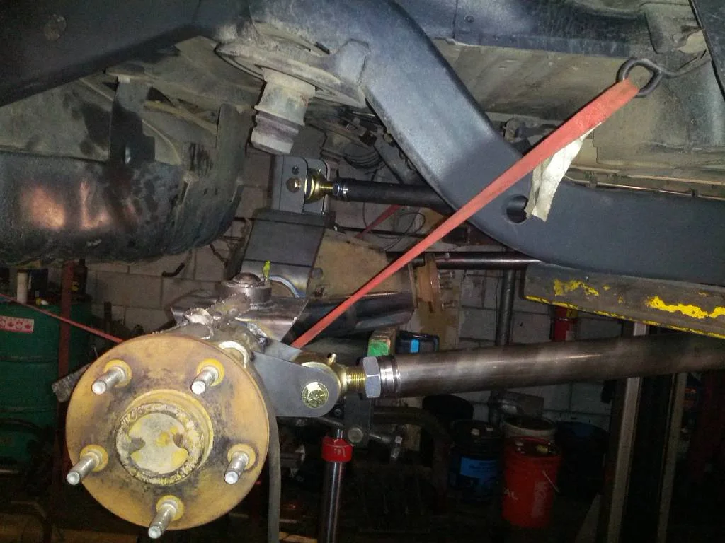

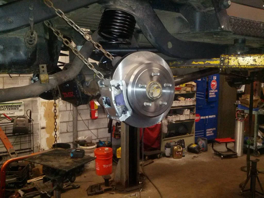

Well our weekend plans got postpone. Which is good for me. I'm going to pull the jeep in the shop tomorrow and remove the axle. Get the 8.8 in for the test fit. If everything goes as I hope they will. I should be done by Wednesday, Thursday at the latest. I'm pretty sure I have all of the parts I need.
