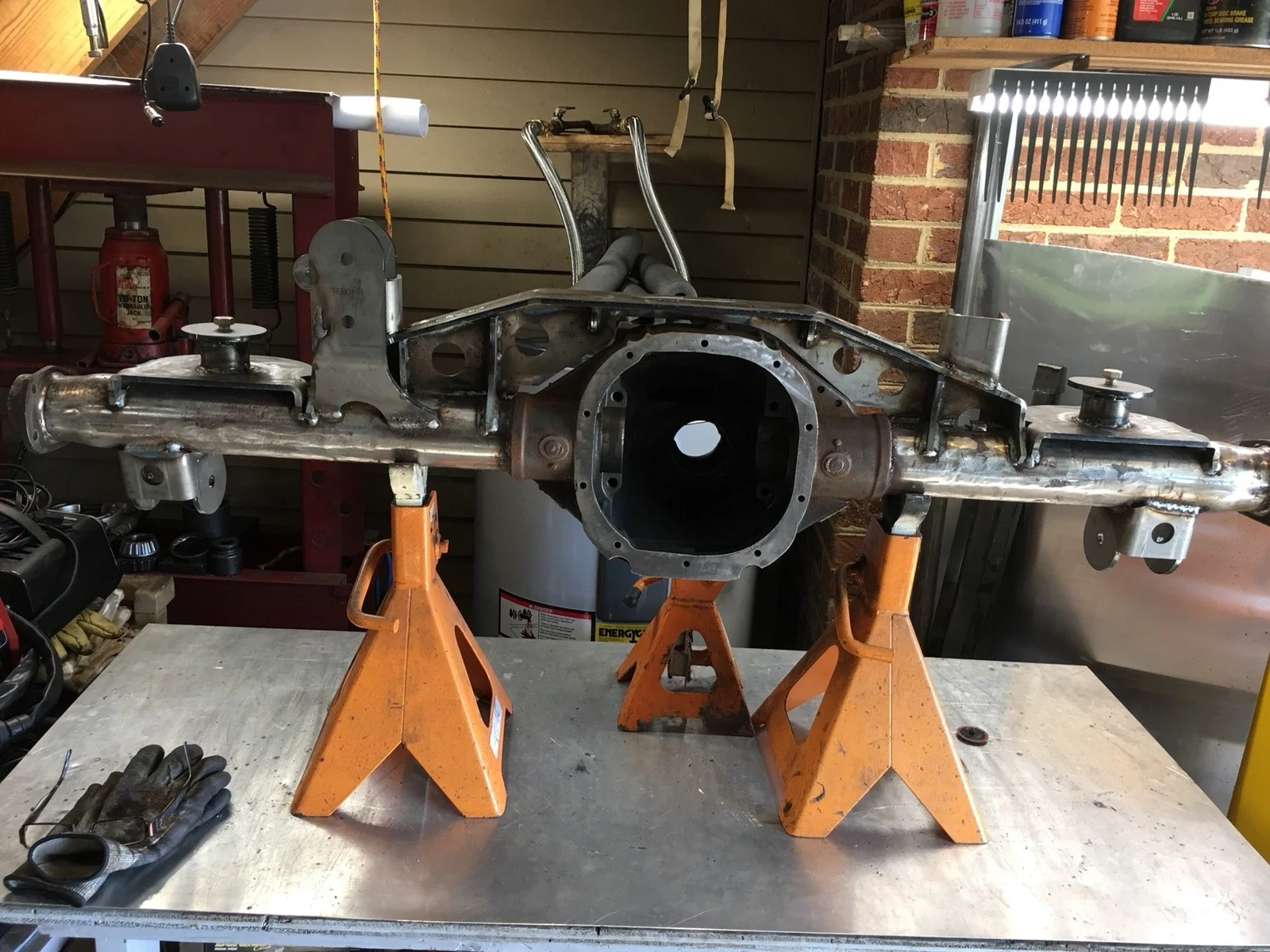

Let the slow axle swap begin.
Axle test fit went real good.
The axle is all welded up except for the two shock mounts. I decided to wait and weld them once axle is in. I want to cycle the axle one more time before I weld them on.
Still have a lot to do.
Drill and tap the vent
Add the brake lines
Install the brake brackets
Install ring and pinion
Close it up and paint.

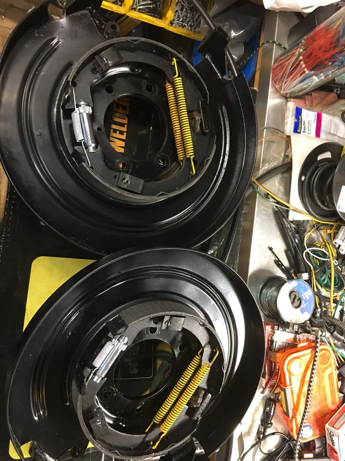

I’m surprised you didn’t just swap the drums out for rear discs! Working on drums is always a pain in the butt with those springs!
It has rear disc. These are the e-brake drum brakes.
Oh, I gotcha. That makes more sense now. I was wondering why someone would go through that trouble of swapping in an axle and keeping drums.
Even if there isn’t any performance to be gained from rear discs, the ease of doing a brake job in general makes it worth it!

I'm glad it came with disc brakes. But the e-brakes are a pain, I would rather do regular drum brakes... lol
