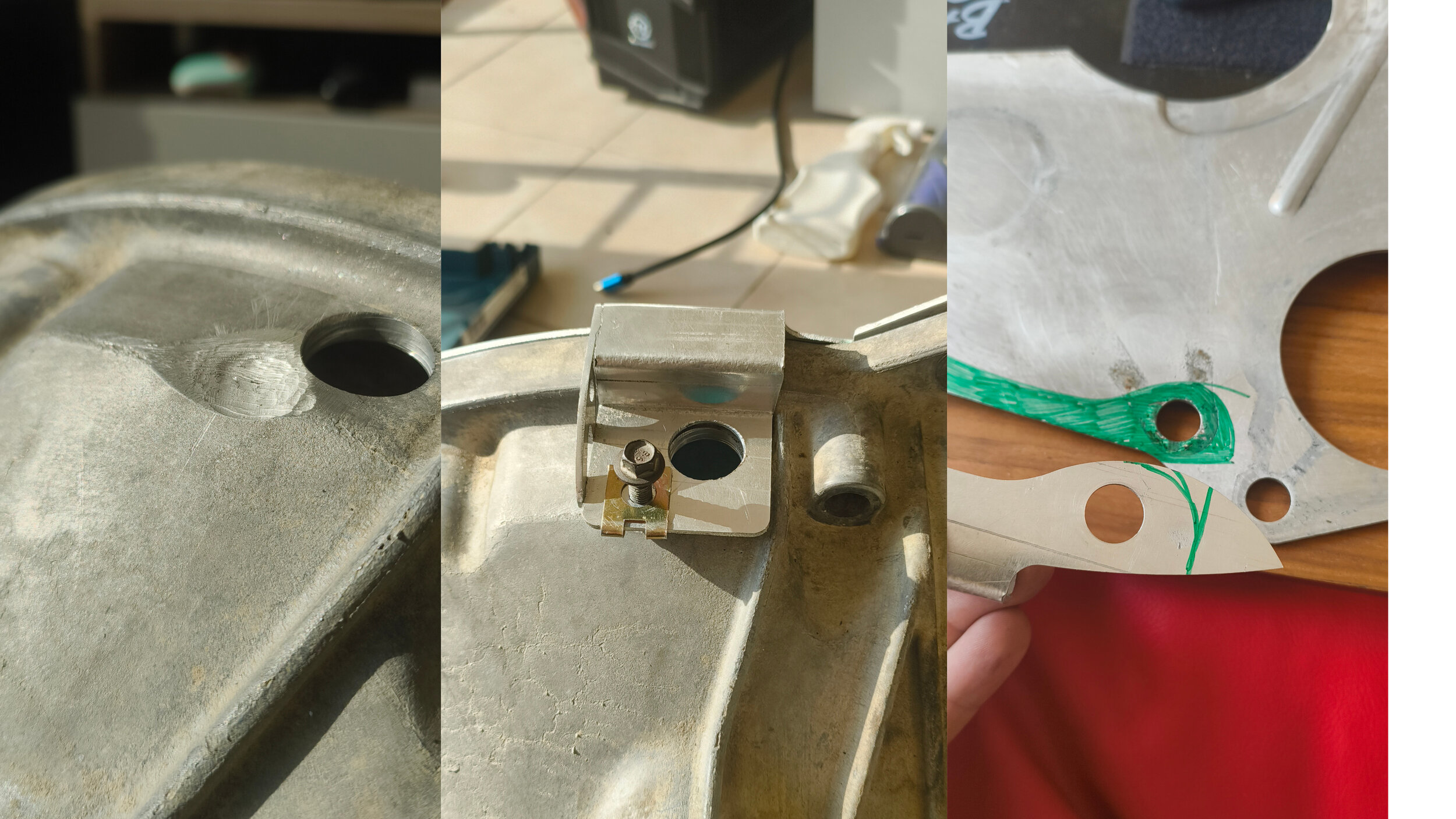

The thinking: the Novak adapter is basically just a flat face for the late model sensor to sit on with a threaded hole with extra steps because making cool products is cool....so what if i make a hole in an AX15 bell housing and then make a mount of some sort to adapt it.
So i'm lucky here, i have amazing friends, a friend who fixes TJs for a living happened to have a broken NSG laying around that i pulled the bellhousing off of and another friend with a spare AX15 that i pulled the bellhousing off of as well...we went back to friend no.2's place and we took some measurements to compare, a few 3D prints, some adjustments and about 4 hours later we know where the hole is meant to go relative to the input shaft.

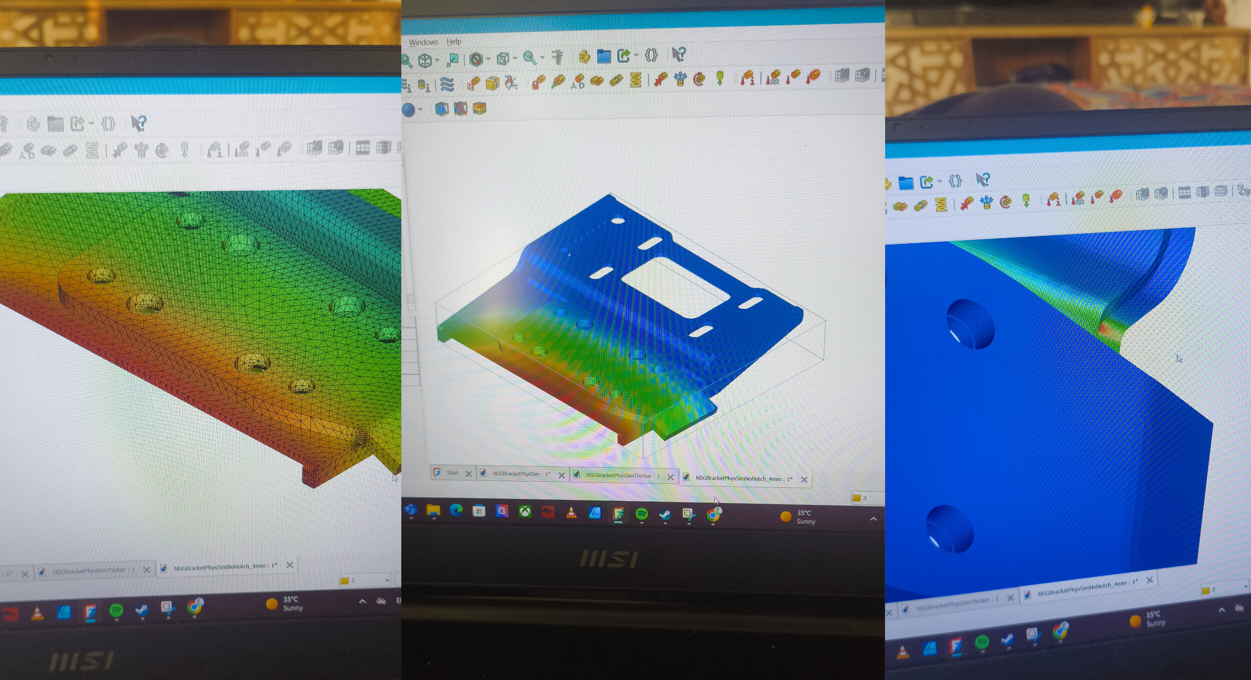

Designing with my friend Mermaid
We confirmed our design against the AX15 bellhousing.

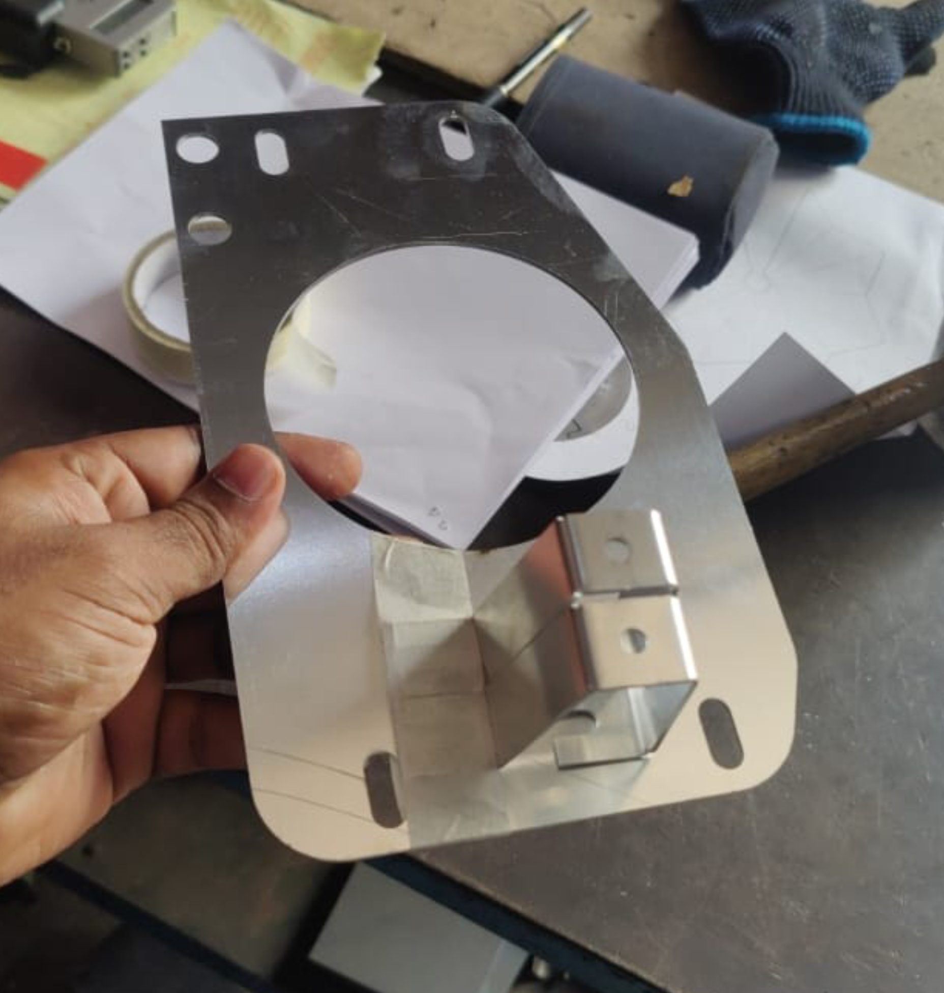

The work: armed with hard numbers, a laptop and drill bits i set off to teaching myself some sheet metal design to make a lil platform to hook around the bellhousing and wedge between the engine block and trans, a local fab shop did the laser cutting and bending work for me and so it was time to test fit, cut and drill stuff.
The sheet metal bracket

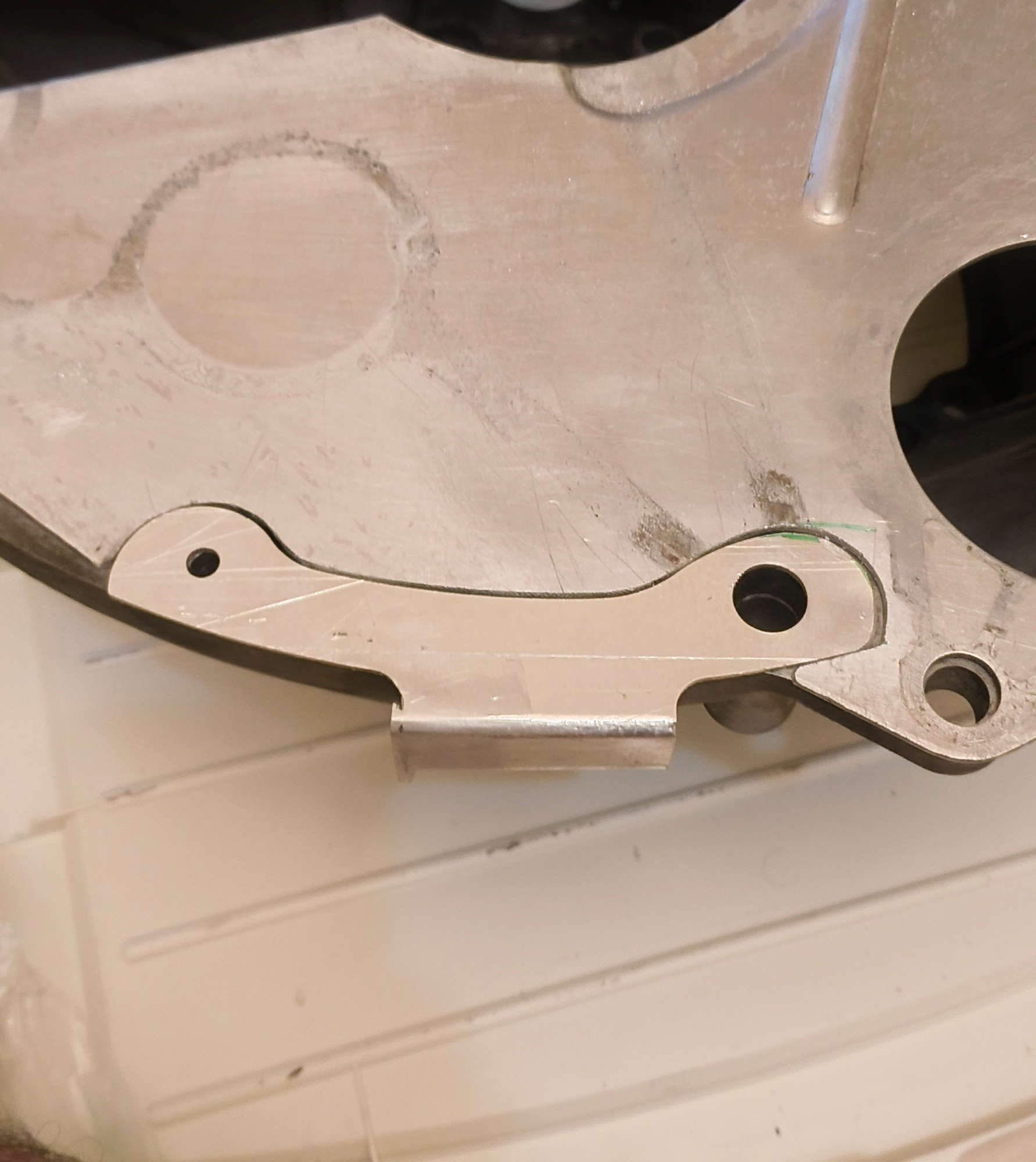

Drilling holes in my new...used AX15 and chopping up the clutch dust plate to fit the adapter in
Test fitting the crank sensor

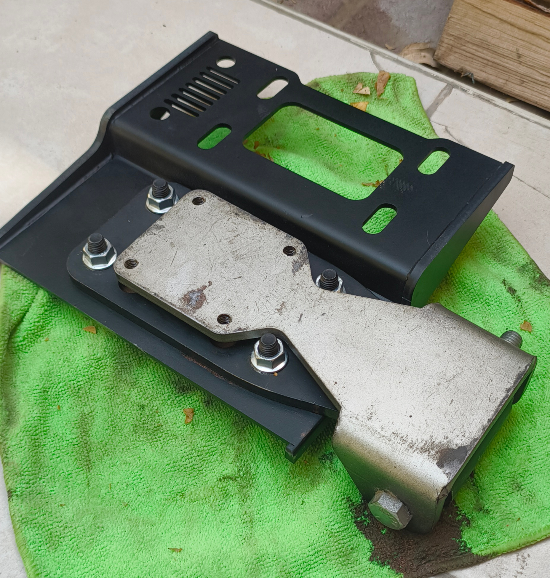

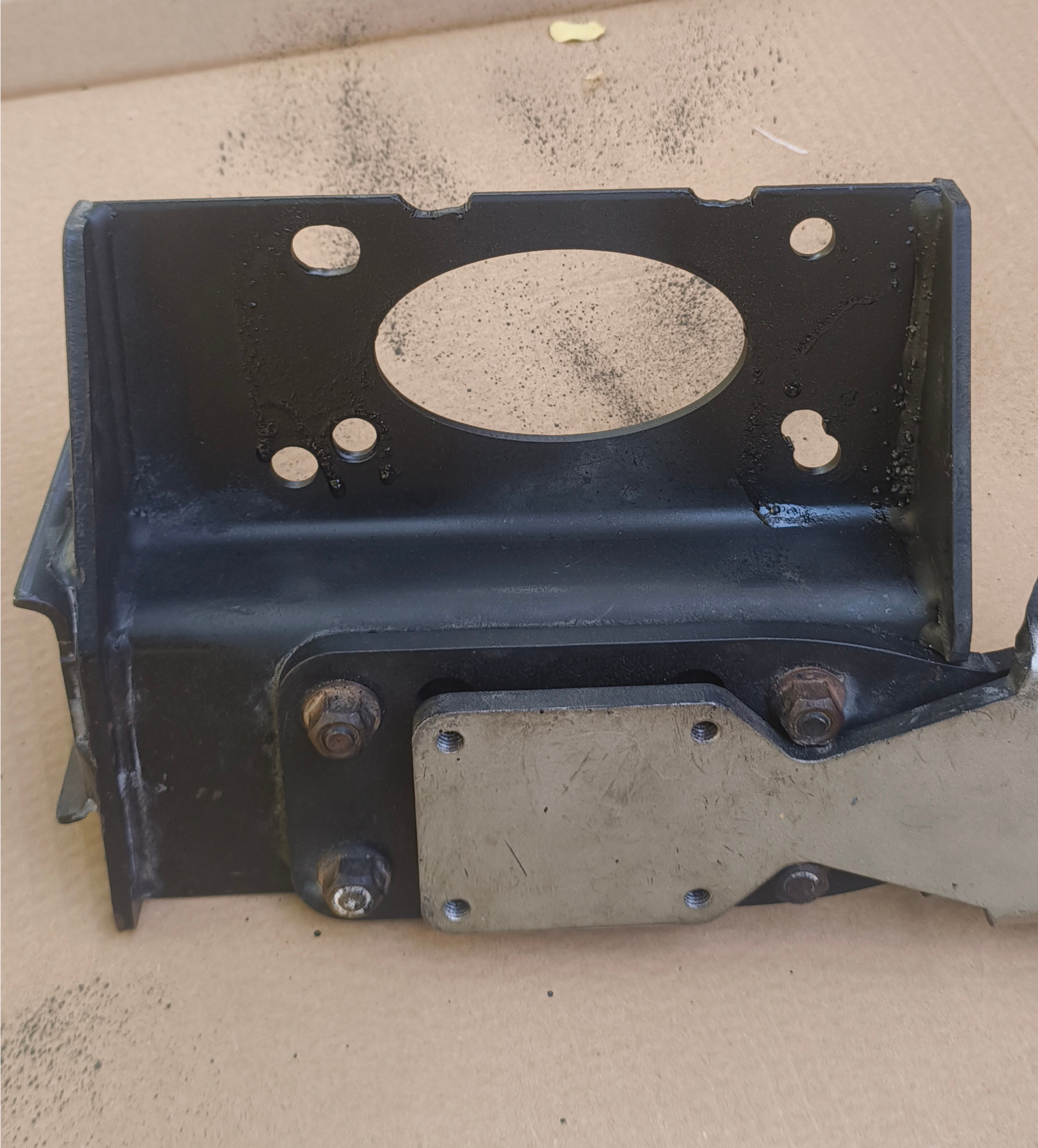

Apparently the 42RLE trans mount bracket is VERY different from the manuals....and i found this out the hard way when i tried installing it all and almost crushed my precious crank sensor, tried for days to find one off of an NSG knowing that with my tummy tuck in i was locked into the late model transmission mount geometry....but alas i couldn't find one and the ones i found on ebay just were not worth shipping over (enjoy some "not the NSG mount photos") so i made my own from measurements off of an AX15 mount and photos of the NSG backet compared to the mount bushing that sits between the trans and skid plate. If you're wondering, why you cant use the 42rle bracket in this case, the bolt pattern on the transmission is different, the distance from said bolt pattern to the mount is different both longitudinally and vertically whereas the manuals were all relatively similar and the bolt pattern on the transmissions all matched.
Butchered my 42RLE mount before realizing it wasnt gonna fit anyway

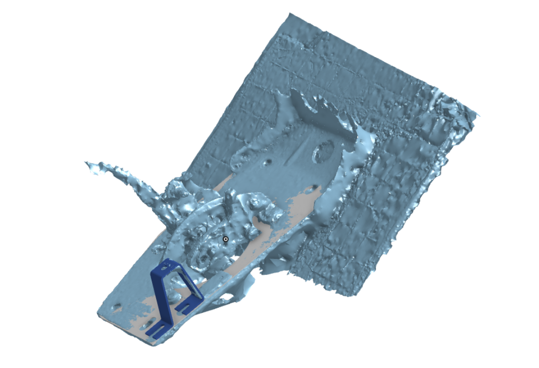

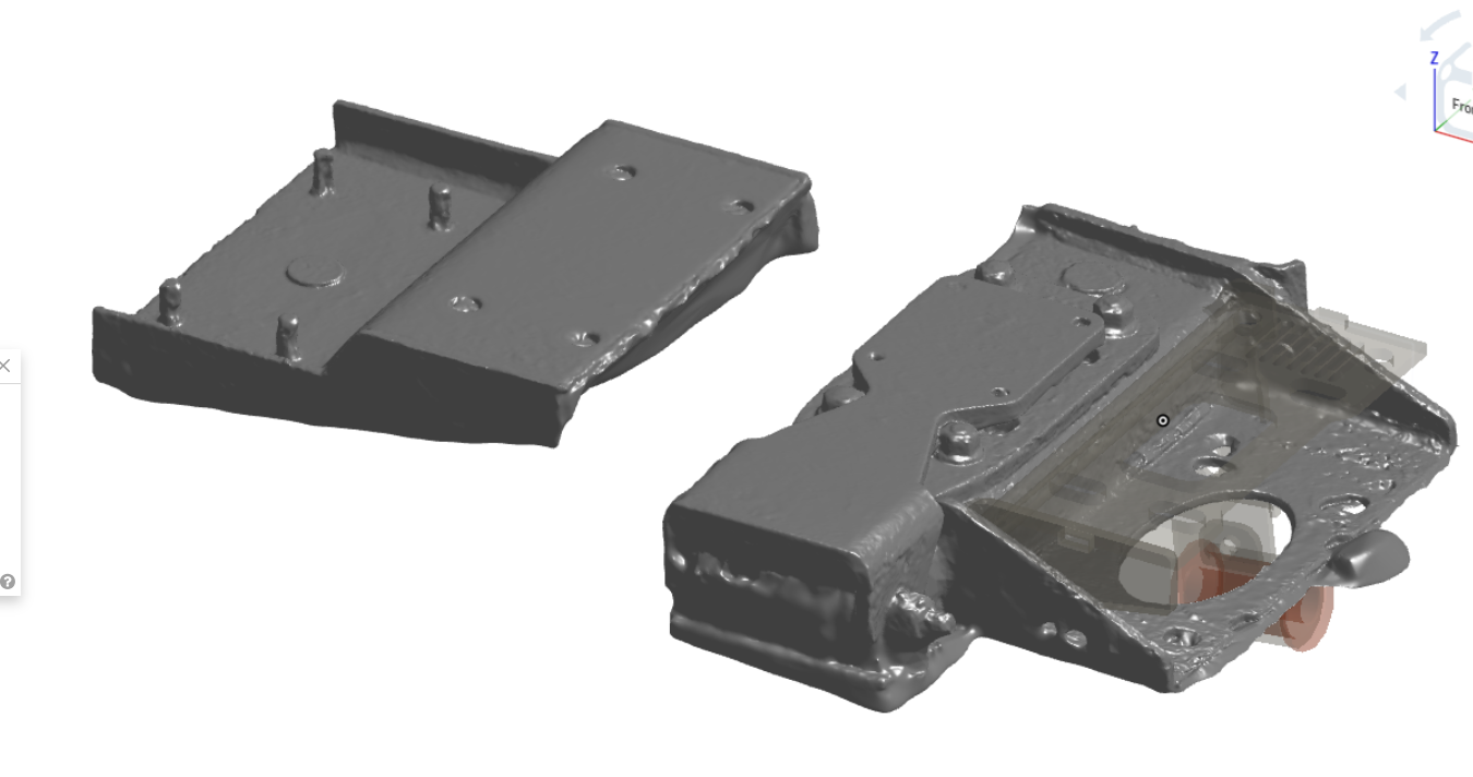

Darn transmission mount bracket....3D scanned my 42RLE bracket and the AX15 bracket using an android app, used a local coin to help me match the scale in CAD
AND THE FINAL PRODUCT

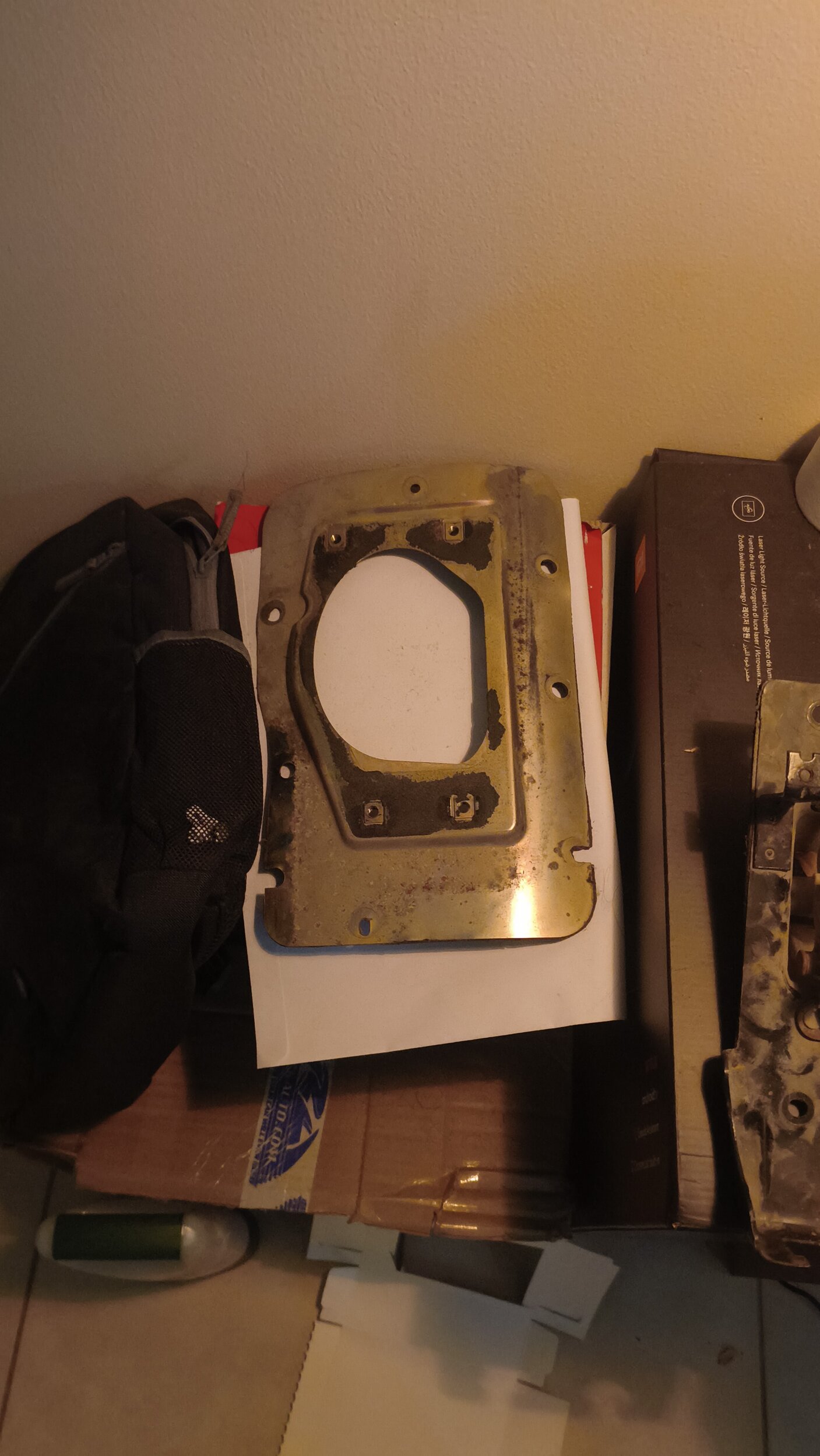

I dont wanna buy trans tunnel parts: i made my own adapter plate to bolt an AX inner boot to the 42RLE tunnel bracket, boot pending but fitment is good.
Now im on a 3d scanning binge you see, so i 3D scanned my automatic shifter tunnel bezel thing to make an adapter for the Ax15 inner boot
