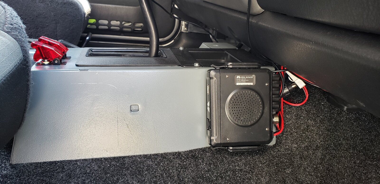

I took the easy way out on mounting the GMRS radio. Drilled holes in the Tuffy console, installed nutserts, attached radio bracket and radio. Wiring still needs tidying up, but the radio is in.
I took an even easier route, HD Velcro to the side of my console. Removable for when not on the trails.

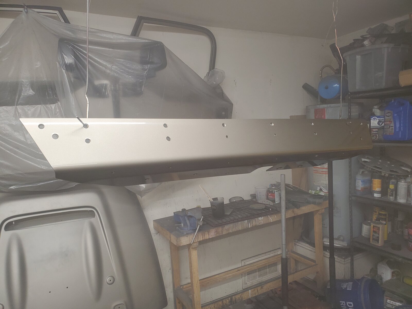

Just painted my sliders to body match after running them raw for a couple months. Decided to paint after repairing some body damage and painting the tub. Totally agree, wait until after you get your other parts.
This just reminds me I need to order paint. I've painted aluminum before, but am curious what you did for paint prep?
Reactions: Wildman
Media blasted base aluminum, 80 grit with the dual action sander followed by SPI waterborne grease and wax remover and 3 coats of SPI Epoxy. Could add some high build primer after the epoxy for any deep scratches you would want to fill in as well.
