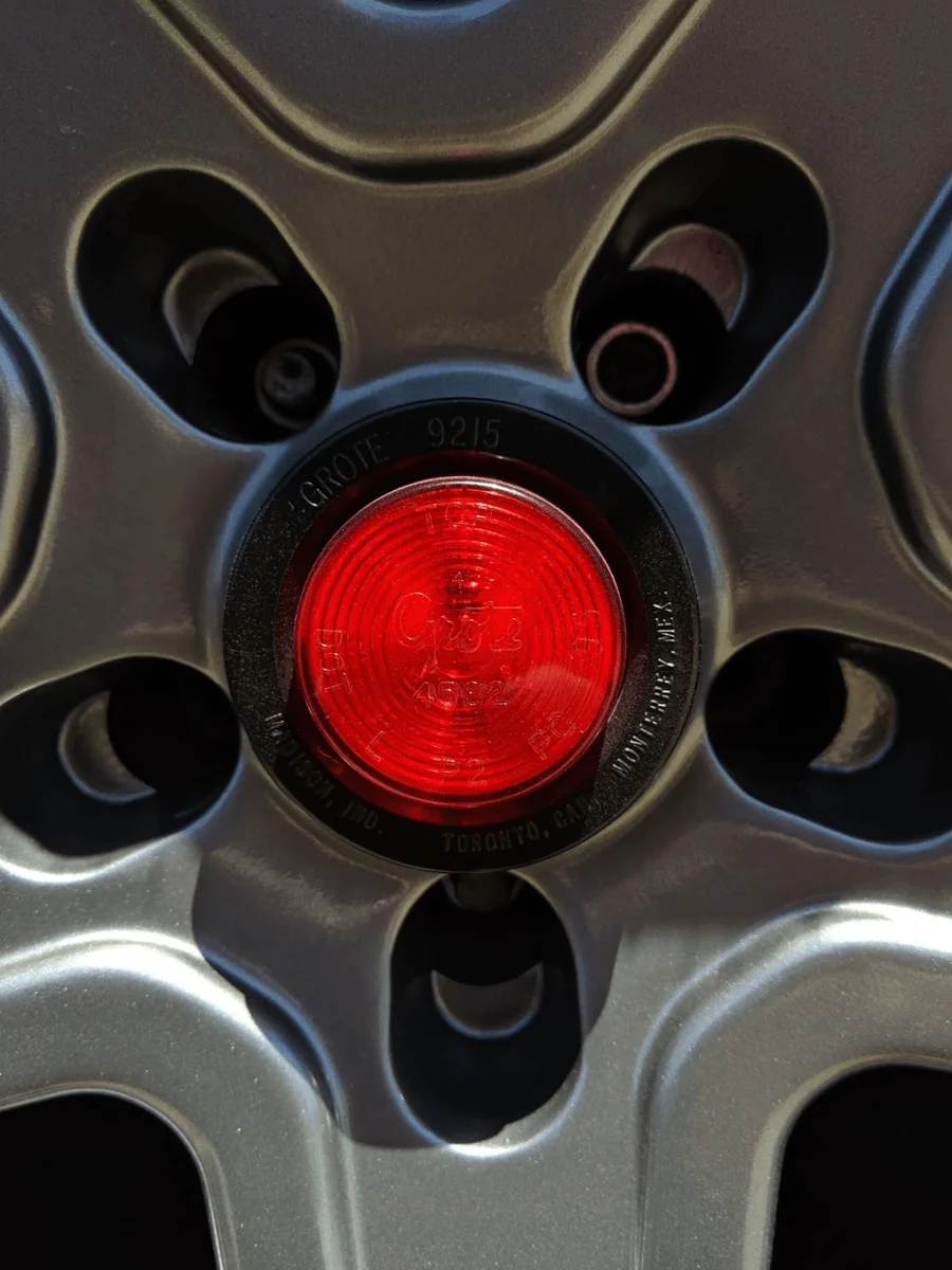

I bought these:
https://www.quadratec.com/products/16181_101.htm
The brightness is about equivalent to the stock halogen brake light, maybe a little brighter.

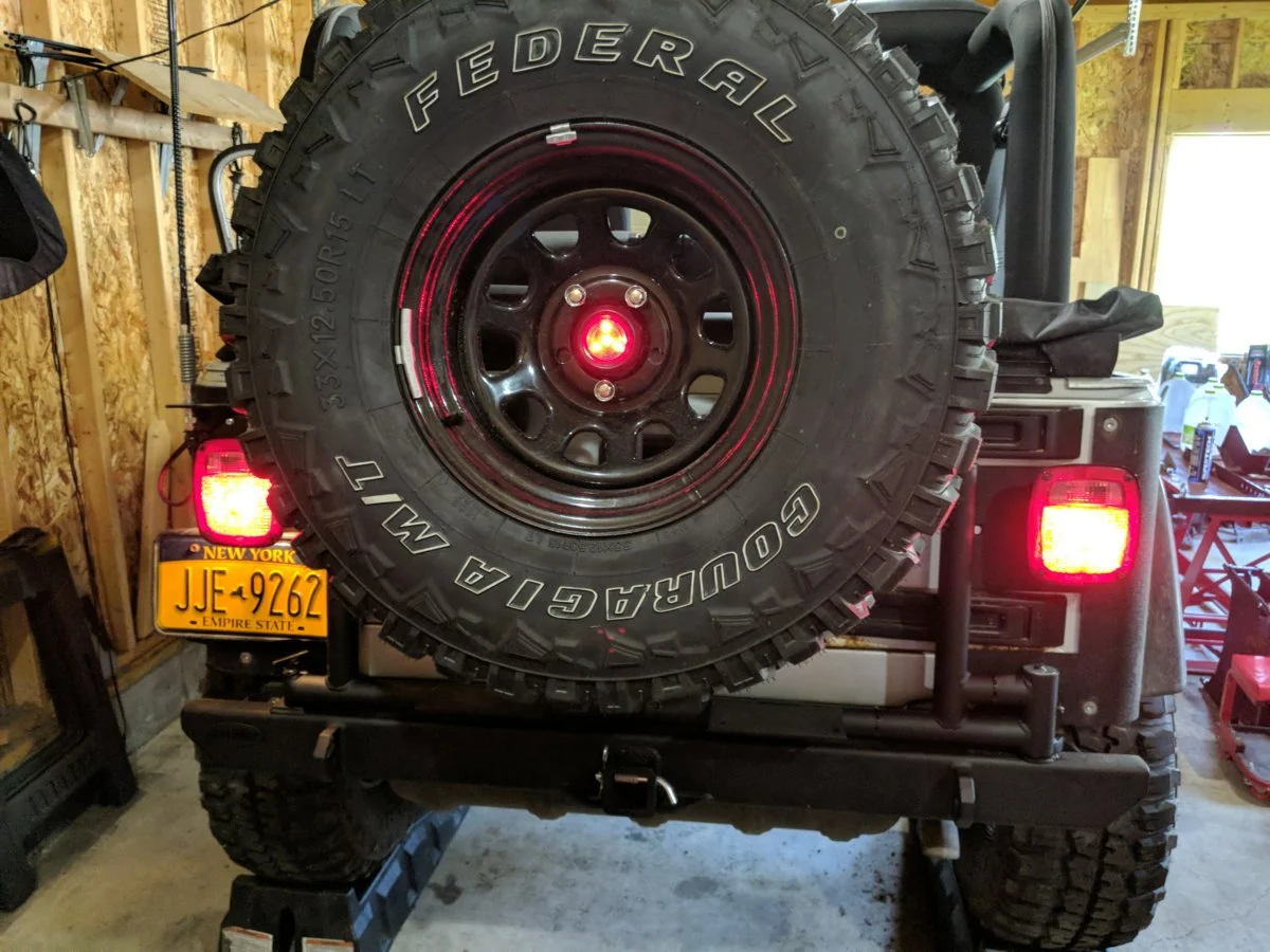

I also put on a hitch receiver brake/running light:
MaxxHaul 50021 Trailer Hitch... https://www.amazon.com/dp/B07F7RZVWB/?tag=wranglerorg-20
I made a version of those and added a flasher to them too.

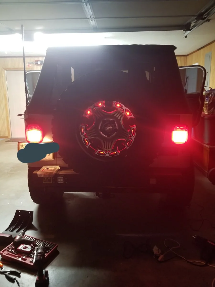

3rd brake lights in open lug holes on you spare
Adding a flasher to the 3rd brake light

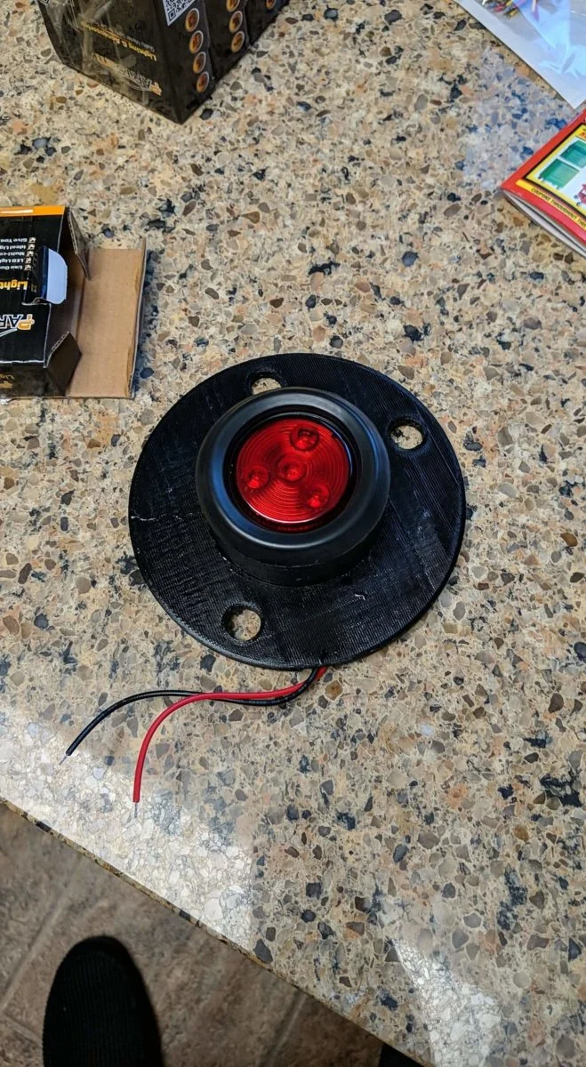

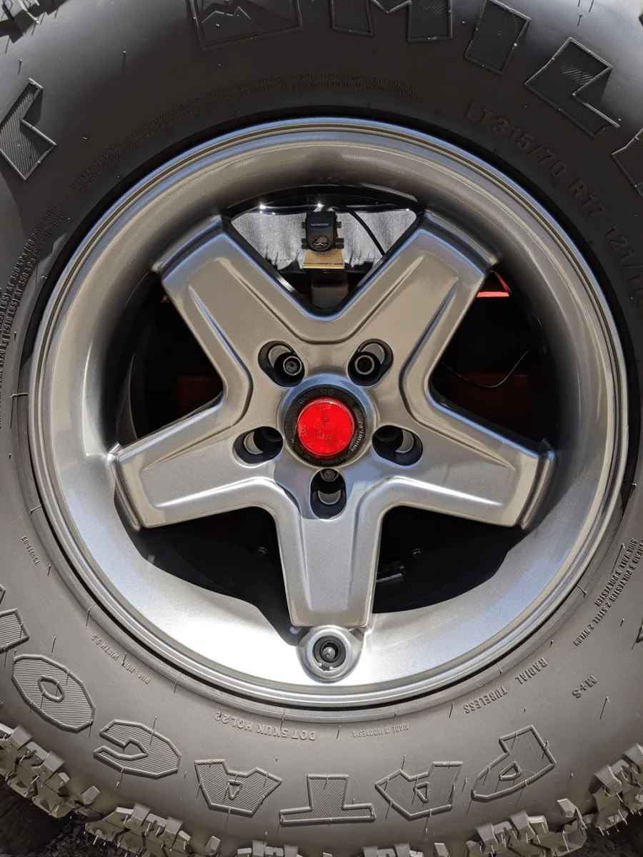

I 3d printed a bucket for a 2" led, when not on the brakes it just looks like a center cap on the spare. There's no bracket, it slips over the wheel studs.
I have more leds and can make another one if interested.
Dude that is AUsome. I have seen ones similar for sale but yours has to be the coolest. If I understand correctly, you scanned the center cap and then printed it, then cut out the middle for the LED's?
I designed a bucket to press the 2" led into that would stick out similar to a center cap and printed it in PETG which is basically soda bottle material.
I wonder if that would fit my stock rims. I have the "Ravine" on my '98 Sport. Super Cool AUsome job. I would love to have one.
