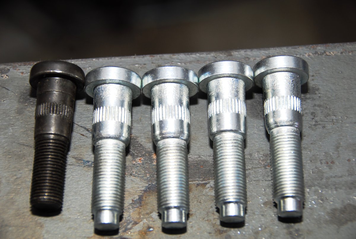

I've done both the large and small conversions on the 16" brake kit. Rotors have to be bored out, sometimes a new pattern drilled to reduce the hole size if Yukon fucks up the wheel studs. The ghost shoulder is supposed to look like the black one.
