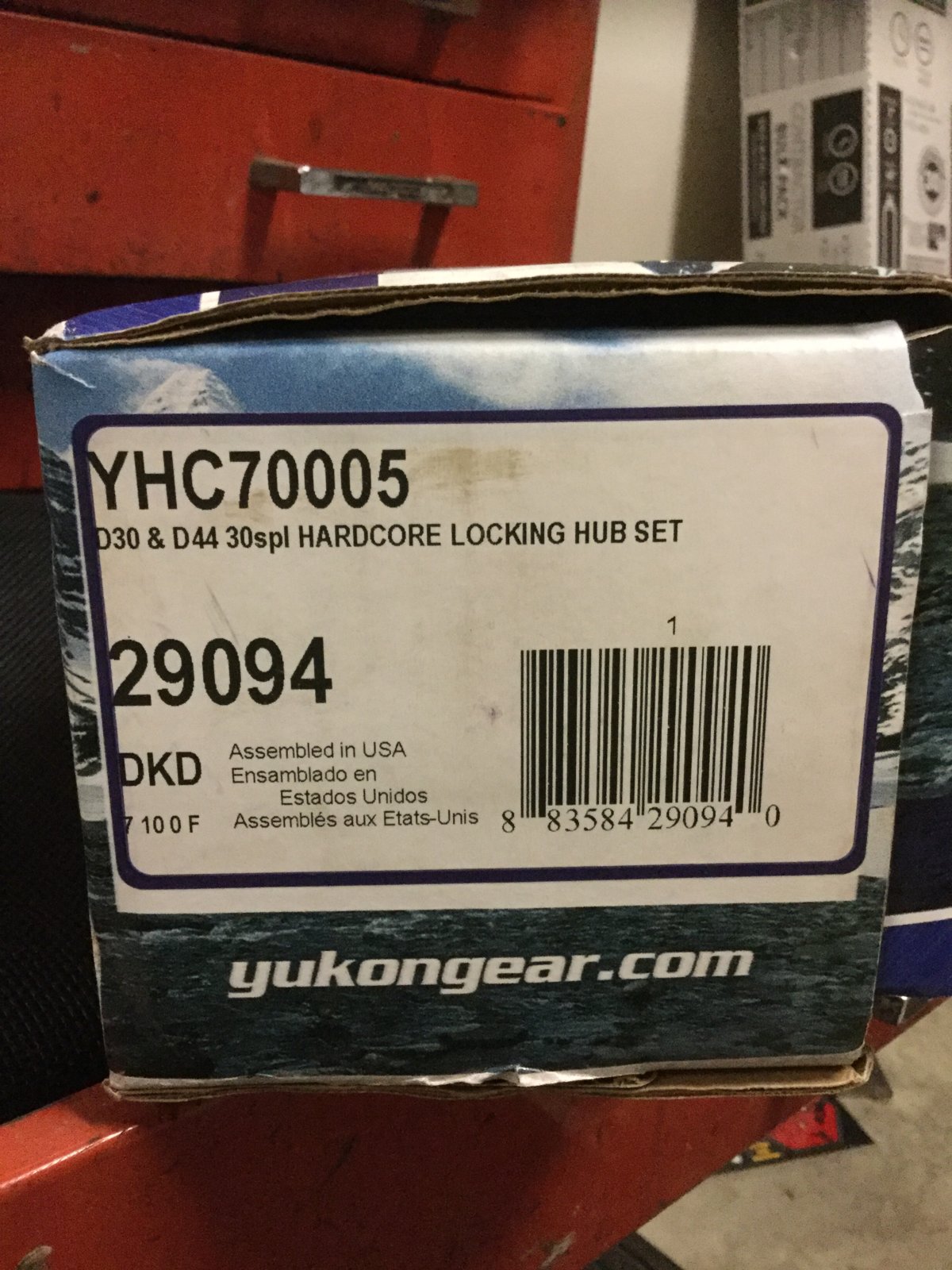

To @jeepndogs:
Thanks for the part numbers!!
Would you also happen to know the part # for the Warn locking hub itself? I always carried a spare hub back in my CJ days and need to put a pair of those on my shopping list.
I tried looking up the part # for the hub shown in the Yukon parts list on the Yukon web site but came up with nothing. I should just call them on the phone, but thought you might know.

Yes I do. I actually bought a extra set of the lockouts, I will get you the number when I get back home. And I am using a wheel from Dx4. I think they are only sold through tire rack.
Here is the part numbers for the hubs. Honestly I don’t remember what the cost was, I ordered them with the full kit. I had a Jeep jamboree we were attending shortly after I was going to be installing everything and it was a 600 mile round trip and I was driving the Jeep. I wasn’t sure if I would have any issues so I was over prepared for the most part.
