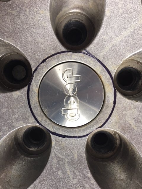

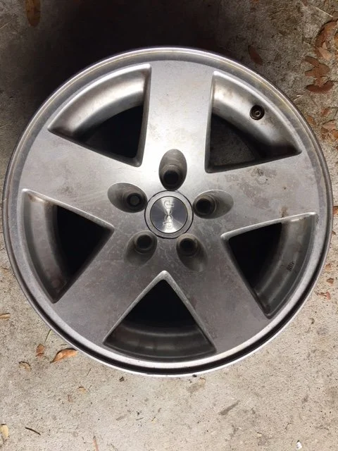

Ram Man's Wheel mod for TJ's I not so sure there is enough meat left on the Rubicon rims. Wonder if that's why he did not drill all the way through. Appears to be fine on the backside though. Black circle is the 2 3/4" hole mod he recommends My vibrations start at around 63 mph with 488's and just under 34's.
Interesting observation on using the Ram Man unit bearing hub conversion kit with factory jeep wheels. I had seen the video but didn't give it any thought because I use aftermarket wheels.

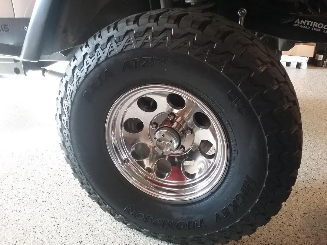

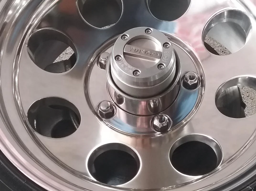

I ended up keeping my Mickey Thompson Baja ATZ P3 315/75R16 tires. They were nearly new and worth more to me than the price a typical used tire buyer is willing to pay. I am now running Pro Comp P/N 1069-6885 16x8, 5x5.5, 4.0" B.S., 108mm center bore polished aluminum wheels. The look is nearly identical to my old wheels sans the rock rings.
I really wanted a set of 17x9 wheels and some new MT tires, but those will have to wait. If I get impatient I'm sure I can rationalize my way into a second set of "winter" wheels and tires. After all, 17's are the new 15's. ;)
