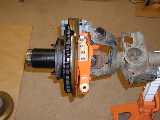

I can't believe no one mentioned Reid Racing knuckle kit that allows you to use 1/2 ton outers. This is the kit I bought, just haven't installed it yet because it changes my lug nut pattern to 5 on 5-1/2 and I haven't bought new wheels. Also I have to do something about the rear axle.
I didn't mention it because it is discontinued and we're still looking for a knuckle to complete a pair. I am personally on a fan of the kit because it uses shit calipers and they need some serious help, the high steer arms don't take Ackermann into account, and for the money, all you are really getting is a locking hub. About the same as you get with the rest of them.

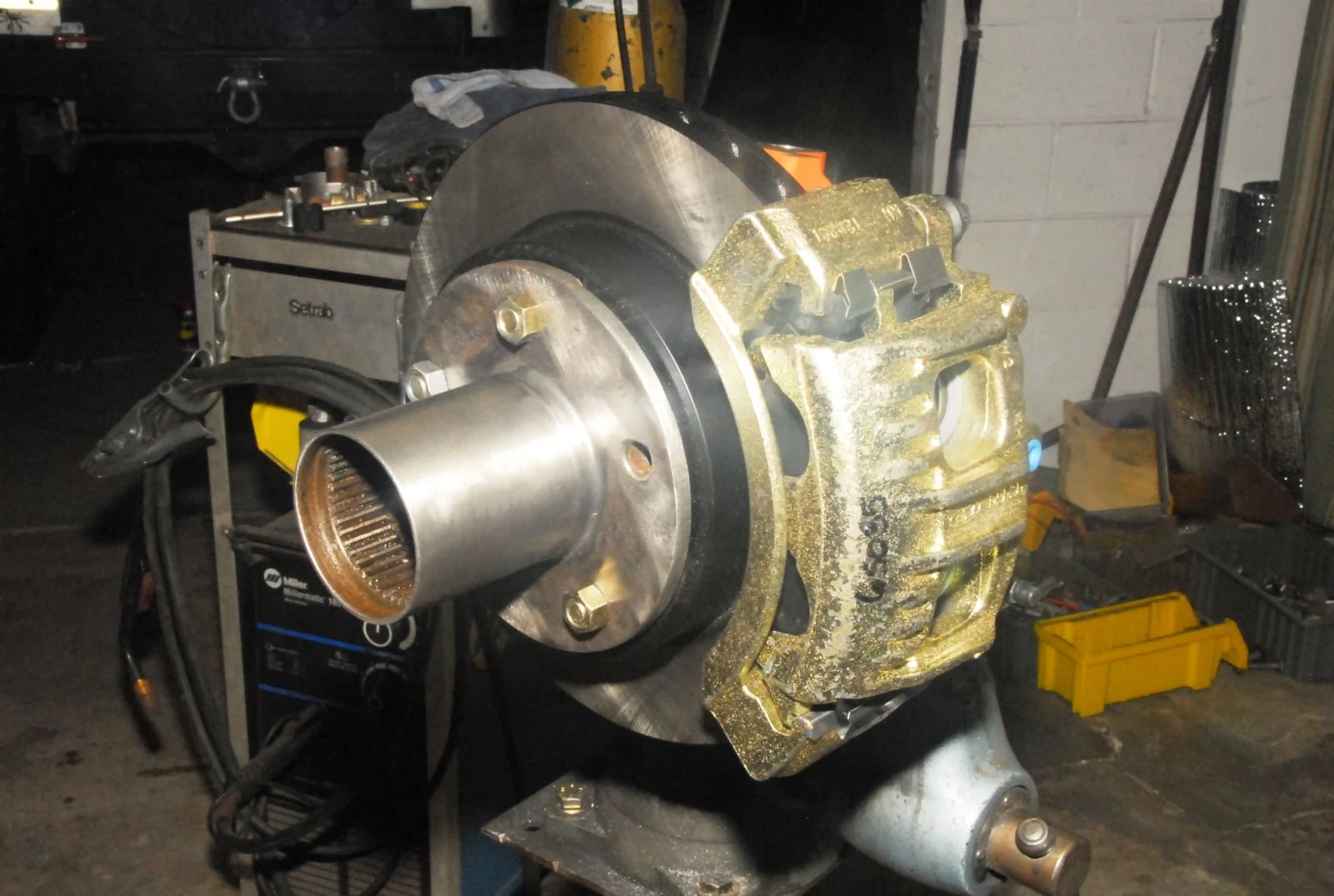

Hmm, i didn't realize they were discontinued. In my case I believe I had to go this route. I bought a Dyna Trac ProRock 44 that allows you to reuse your stock Dana 30/44 outers. What they don't tell you is when you turn the steering, the brake calipers hit the "C" cause the calipers to compress resulting in the loss of brake until you pump the brakes back up. So the larger rotor used with the Reid kit allows the caliper to be farther away and I hope will remedy my brake loss problem.
I assume someone offers a better brake caliber to remedy the shit calipers.
There are several other options that move the caliper out.
True, but I also have a front drive shaft vibration since installing the Dyna Trac ProRock 44 (the reason for wanting the locking hubs) so I'm fixing a couple issues at once.
So what caliper is "sort of" better than the default you would use with the Reid conversion? I was also considering the Reid setup and just found out they are discontinued :-(
Dual 51mm piston version I showed above on the brake kit I made for the Reid knuckle.
