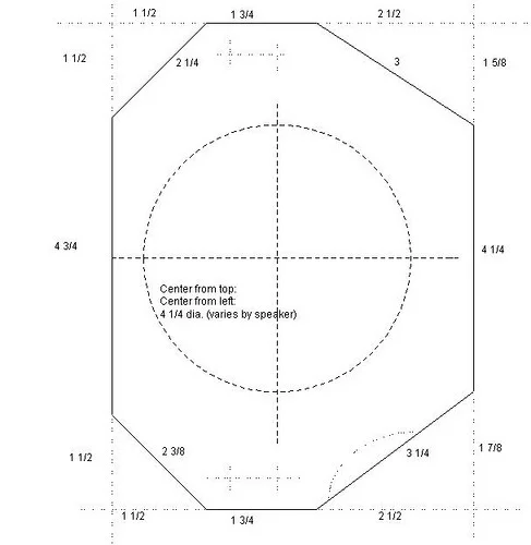

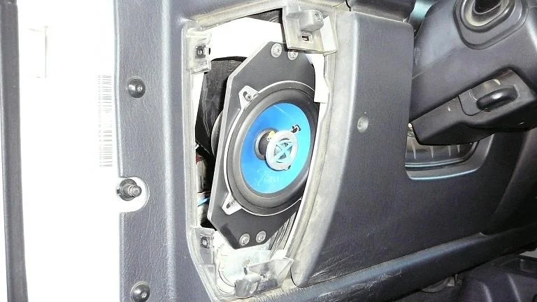

I run a set of 5.25" JBL's in the front ... had to modify the mounting bracket but work well.

You'll need to get the adapter plates for the front speakers that adapt a 5.25" from the stock 4"x 6" speaker. Crutchfield should have them along with other places.
