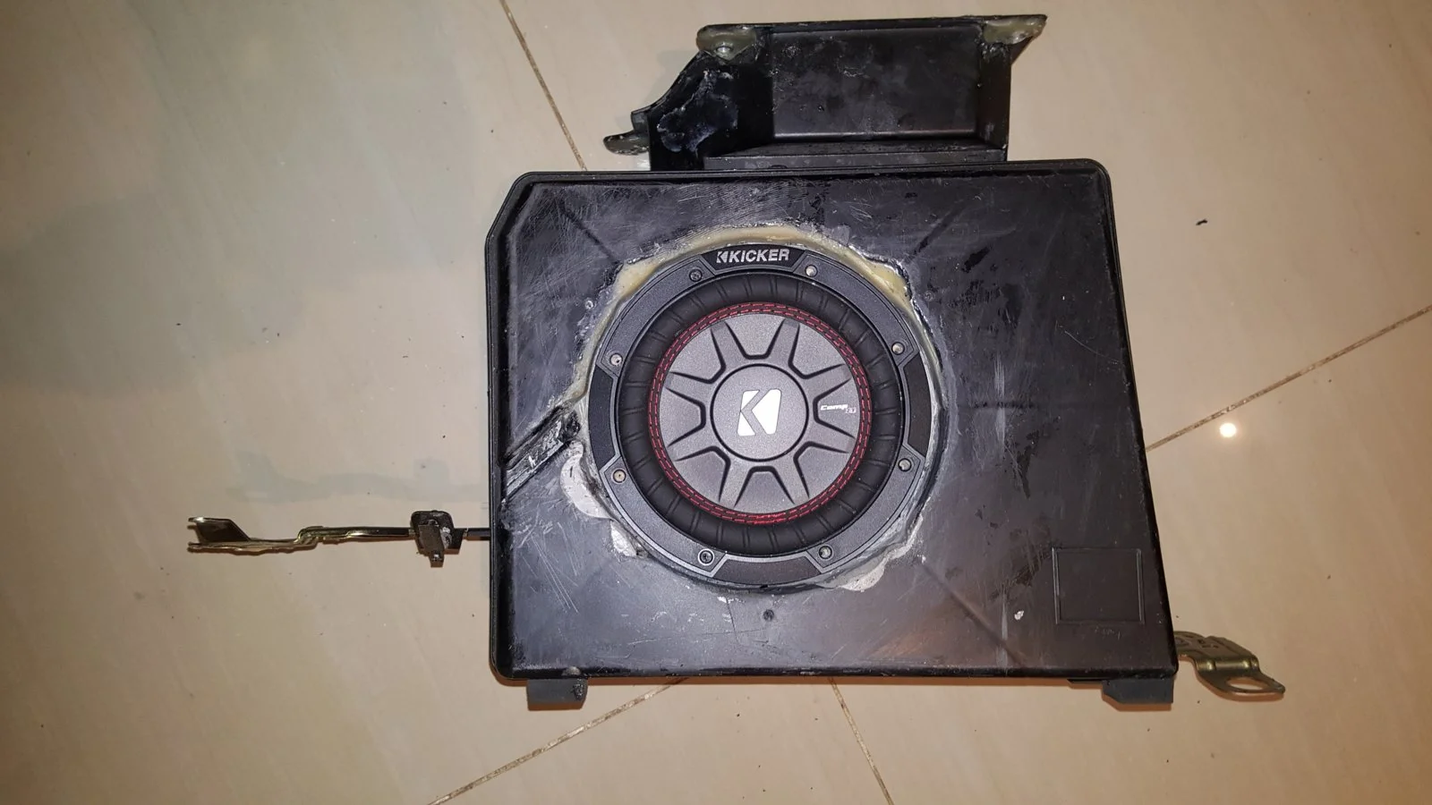

Hi all from a rainy SA today, I will show two pics of sub and std box and amp. if you have some resin and some time it works and fits in std center console. I also put 4 inch in front 200w in std box with 1 inch 200watt jbl tweeters mounted where the std ones were. Back 5 inch 200 watt is plent strong. It sounds really good once you tume the amp for lowpass and high pass and set the frequency and volume. Ive done many sound systems, and the power and clarity of this combo gives my top of the range x5 a good run for its money.

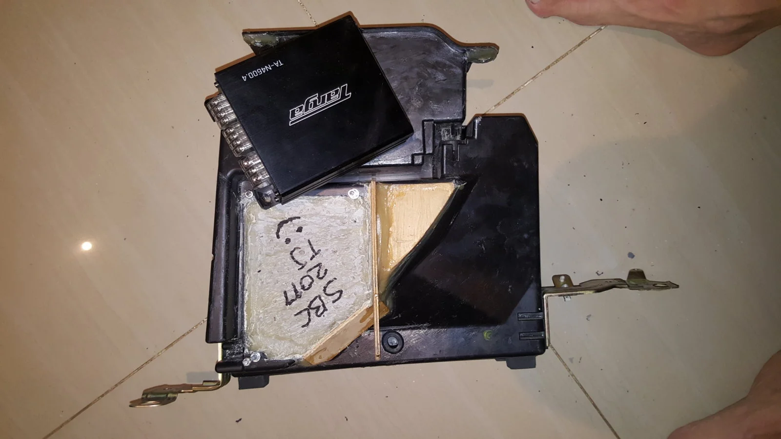

Hi All. I did a great mod to the original TJ center housing. Added a 1 cm thick 6 inch diameter to raise the Kicker Amp, & I ground out the plastic ridges inside the center housing and strengthened with epoxy resin. On the other side replaced the Amp with a Nano 5200 it is very powerfull I use 2 channels to drive Kicker Sub and other chanells for a set of Alpines. 4 inch on front 200 watt with JBL 200 watt tweeters, and 6 inch on rears 200 watt. The sound is incredible and have had many comments, takes a bit to dial it in and throttle it back its crystal clear.
