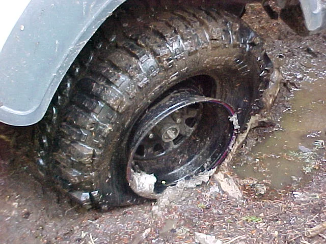

Fast forward to 2005 when I got my first set of beadlocks. Prior to having them I had some 12" wide wheels that had come on my TJ when I bought it. Those rims had some 33x14x15 TSL Bogger tires and if I went below 12 PSI I'd pop a bead left and right.

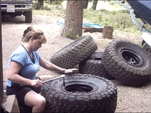

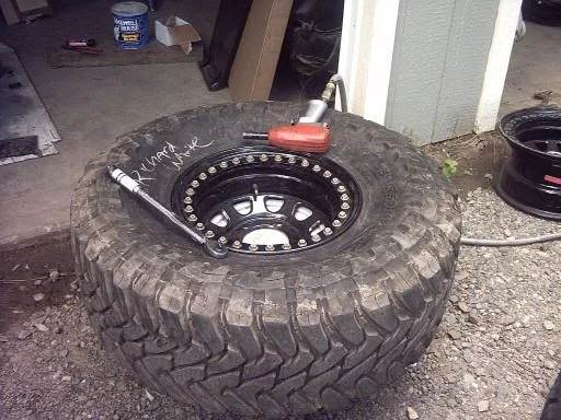

When I came back from Iraq one of the first things I bought was Allied beadlock rims. Had a little help mounting up all 5 tires onto the rims.
I don't have a lot of pictures with these times aired down.

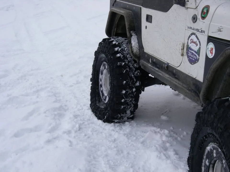

Then I got this WILD HAIR and decided I wanted to run dual beadlocks like the military Hummer rims. So I bought some used rims and recentered them and installed 38x12.5x16.5 TSL SX tires. First time out was a snow run and just to see how low I could go I took them down to 2 PSI and never had any issues. Now these are not for the weak back folks since the tire and wheel combo weighs in at 138lbs each.
2 PSI

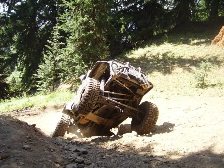

33x12.5x15 on 8" rim:
Rocks: 8psi

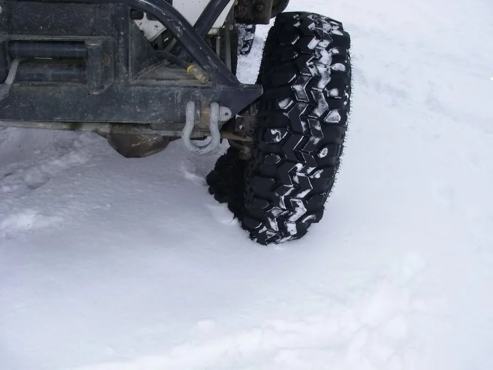

One of the last snow trips I made I was aired down to 8psi. I feel like for snow on smooth roads I could go lower and my try 6-7 next time out. I'll probably try 7psi next time I'm in the sand as 8 didn't look that smooshed in sand.
However I did get a little feathering on the outside lugs of my tires after driving quite a ways on the pavement to get to a good spot to air back up after. I put probably 20 miles on them after getting back to dry pavement. It's nothing major but there are some strange spots of wear now. I figure it will wear off in the next few thousand miles.

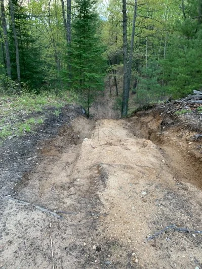

Depends on the terrain. Ive never popped a bead but I have had roots and gravel pressed into the rear rim/tire and give me a flat at 12 psi, multiple times climbing out of the steep sandy ravines shown below.
